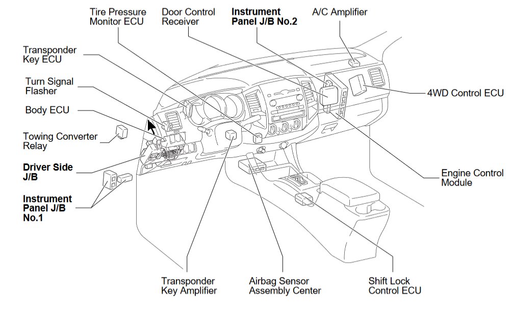

    This is a drawing of the relays etc in that area. The Body ECU is also there.
