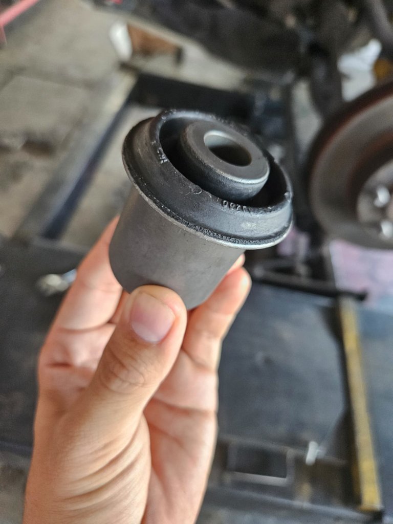

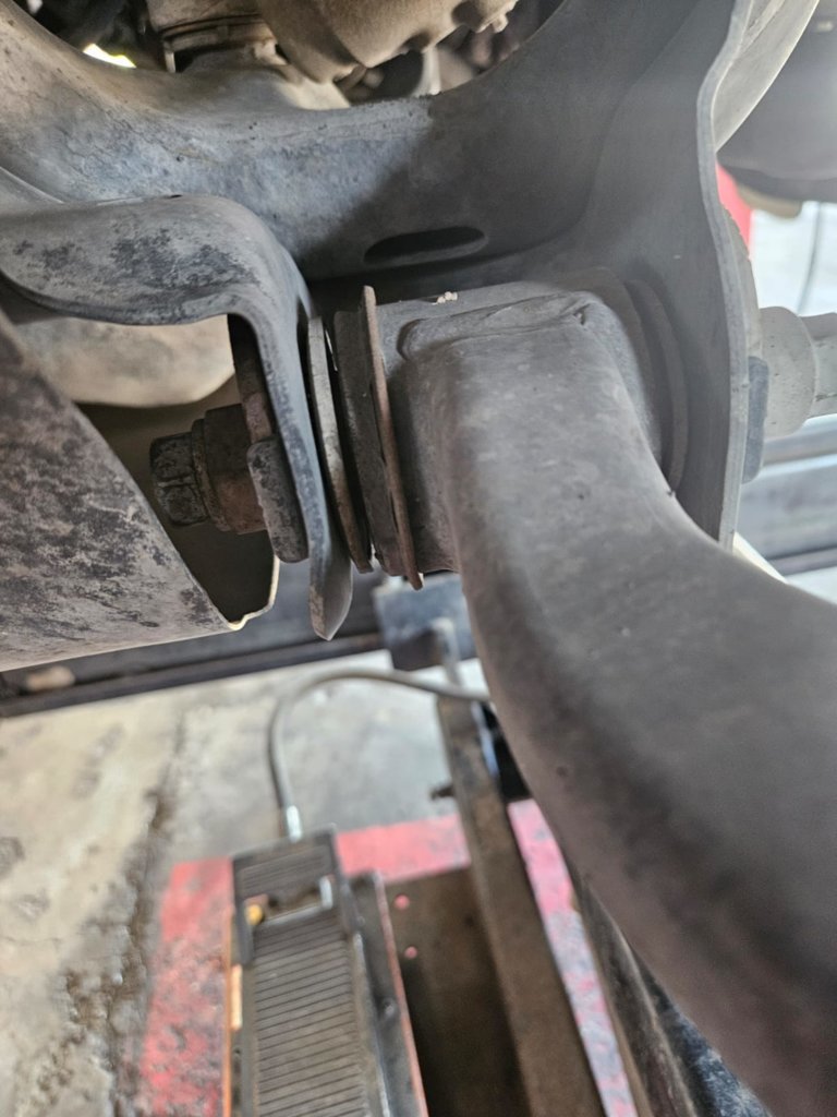

    i have had 4 Tacomas throught my life 2 of which are still around: a 2012 3rd gen red TRD full cab, and a 2017 blue 4x4 that I really dont use cuz I dont like it as much as the red one.
    No mods all original, no crashes or bumps on neither.
    Most likely the rubber bushings of the links for suspension n sway/stab bar: here is a picture of mine when I fixed it: I go through 8 speed bumps at 30km twice a day the whole 12 years I have had this pickup IMG-20240918-WA0006.jpg
    The one im holding in hand is a new one that belongs to other car but they all look similar
