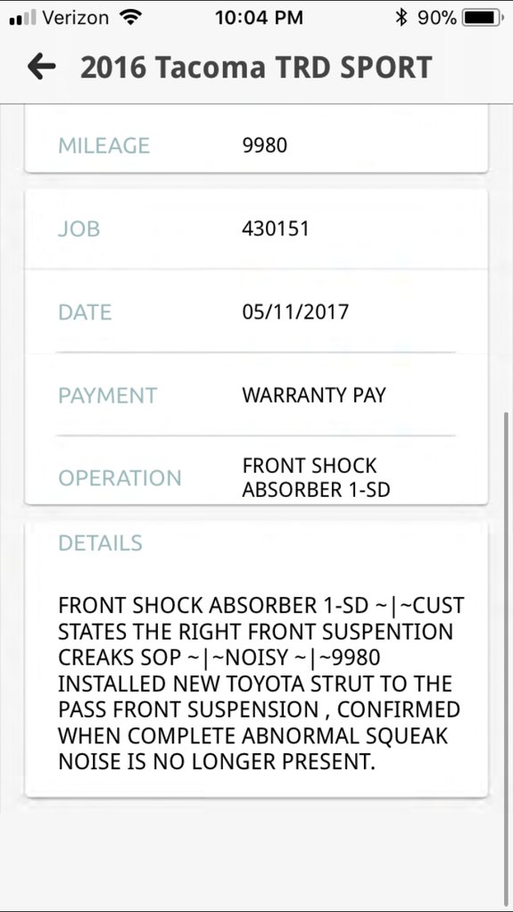

    I have the exact same sound on my Pro! Just cannot figure out what it is exactly. The metal pop sound at the beginning.... I read someone said the dealer changed the front shocks and it stopped. Might be the shock mounts not in properly... let us know what you find...
