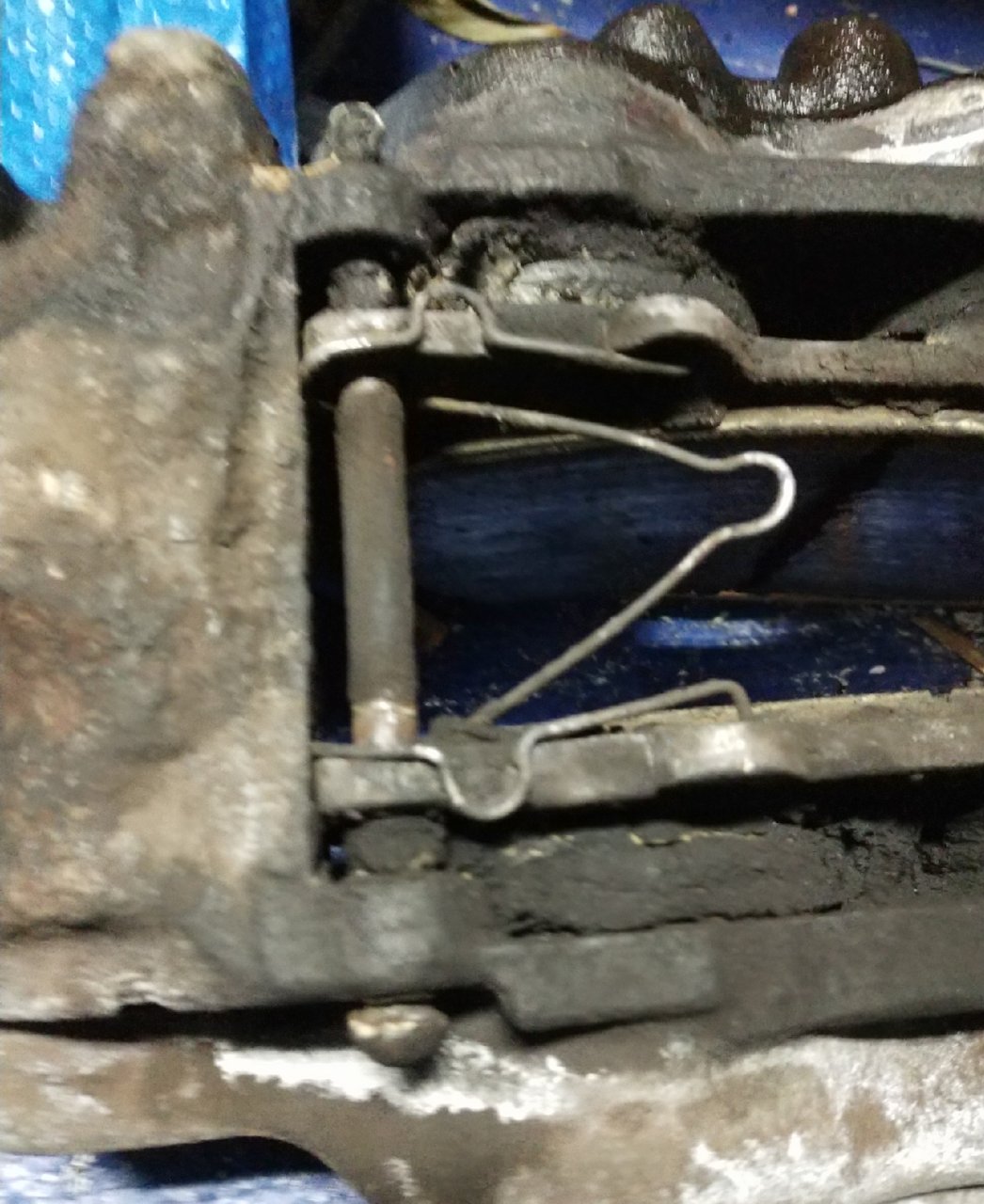

    The spring is the metal wire between the pads in the pic. If you cleaned off the old grease from the back of the pads, you need to put fresh grease to help the pads stick to calipers. Without the spring, the pads are lose in there bouncing around :)
    (Don't goop on the grease like in the pick, that's just an old calipers I had on the shelf to show you the spring :) )

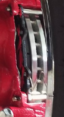

    I actually did a brake upgrade on my truck today, forgot I took some pics. see the spring and the light coat of red grease on the back of the pads.
