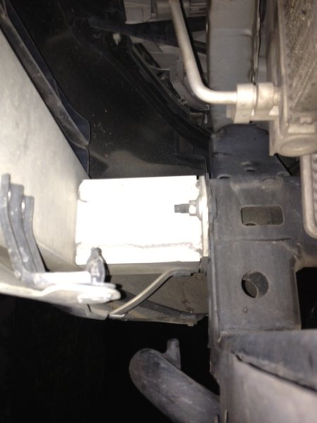

    Mine makes a clunk too at full lock when turning and I have know idea what steering stops are to grease?? Can someone please post a pic so I can fix this.

    Sorry it took so long bud. Works been crazy lately and I've been out of it. Tell you the truth, I forgot until it struck me today. Here's what I replaced. Mine had a small crack in the weld I believe. I would suggest you remove the bumper skin, then the aluminum bumper rail, then these aluminum bumper bracket/blocks. Drive it around a bit, making certain that you do some things that will shift weight and torque the frame. If you don't get the noise, this may very well be your issue.

    [this explains my issue as well, I cant see why the sway bar would come into play here. I also have the toytech lift. I am thinking Nubbs on this post has hit it on the head. I am still under a warranty so Im thinking I will be. Taking Her Into the stealership. anyone know if there is a chance the lift is causing the cracked bracket?QUOTE=DR Da_da;6392512]I'm getting a clank/clack/click (or whatever) in my front end as well. A few weeks ago I installed ToyTec's ultimate lift coil-overs, Light Racing UCAs, new outer tie rod ends, and new lower ball joints all at the same time. The clacking initially began only in the front left. I'd hear a thunk when turning the wheel from the right to the left as the weight of the truck shifted from one side to the other. Now, after a couple weeks, the clanking is in both sides and is getting louder/worse. I initially thought the brake pads were slapping around due to slack/play as the pads are wearing down. However, it didn't start doing this until after the lift. It's only present at low speeds (i.e. when pulling into/out of my driveway or parking spaces, and when doing low-speed turns).

    Thanks man. I like the other fella on here have installed a Toytech lift and then this whole thing started. Think it could be the Lifts' extra flexing on the frames causing the issue? I also saw this as an issue on some other forums. Check it out here.

    I'll have to crawl up under my truck and have a look, but I think my noises sound like they're coming from behind each wheel (around the brake assemblies/spindles). The part numbers for left and right bumper brackets are 52026-04010 and 52025-04010, respectively. The cheapest I've found w/ shipping included (it's free in this case) is $197.54 for both from Camelback Toyota in Phoenix, AZ.

    After reading your specifics, I think this is less likely your issue, although not to be ruled out completely. Follow the steps I described before proceeding to purchase new bumper blocks.
