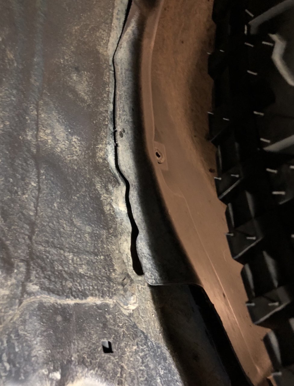

    Hey fellas, just installed new tires and I’ve been hearing some clicking noises between the speeds of 30-45 mph (https://youtu.be/rGhQooR4W4Y). I’ve been trying to inspect the wheel area to see where the sound could be possibly coming from and came with 2 possibilities.
    1.being the plastic area is not molded together and possibly flapping during driving?

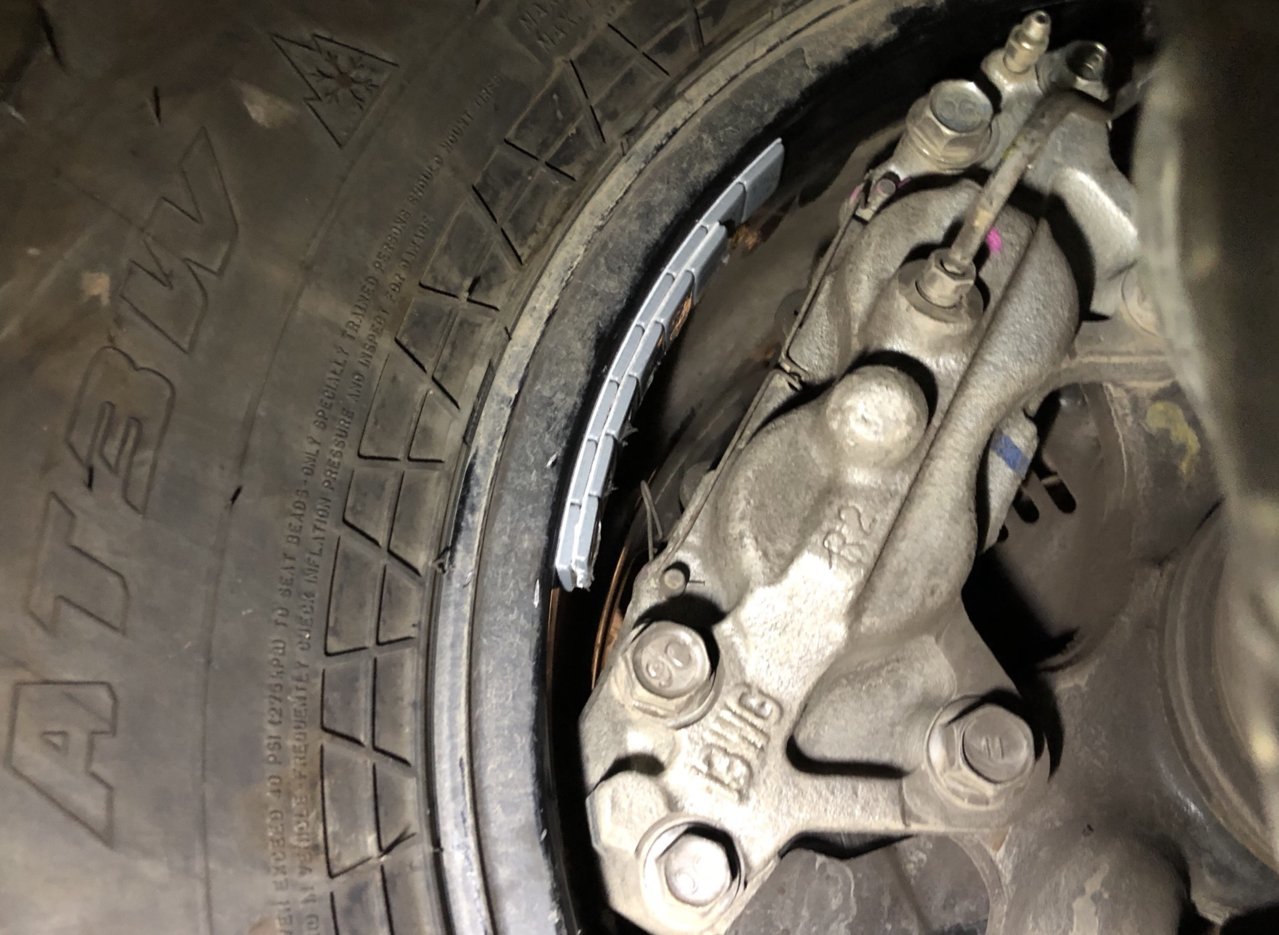

    2. In side the wheel, tire shop guy, put weights to balance, could this be hitting anything during drive? EAC55246-D96B-423E-8102-2A42A2F2E82D.jpg

    Are there any witness marks on the weights?

    Witness marks as in plastic peeling or scratches... yes

    Yeah like marks and scratches on the weights the tech put on the inside of the wheel.
    If so they may be hitting something, though I would assume if they are hitting something hard enough to make a noise they would just fall off.
    They are only held on by some adhesive, I usually loose mine whenever I go play in the mud.

    Take the truck back to whomever installed the tires and have them find and fix whatever is making the noise (probably weights hitting the caliper).
    If you want a faster fix, take front wheels off and move the stacked weights immediately next to the other weights. The adhesive probably won’t stick so put some duct tape over them.

    So went to the shop and you guys were right. Apparently it was hitting the weights and they took care of it and the sound is gone.... now to address the rubbing when reversing :bananadance:

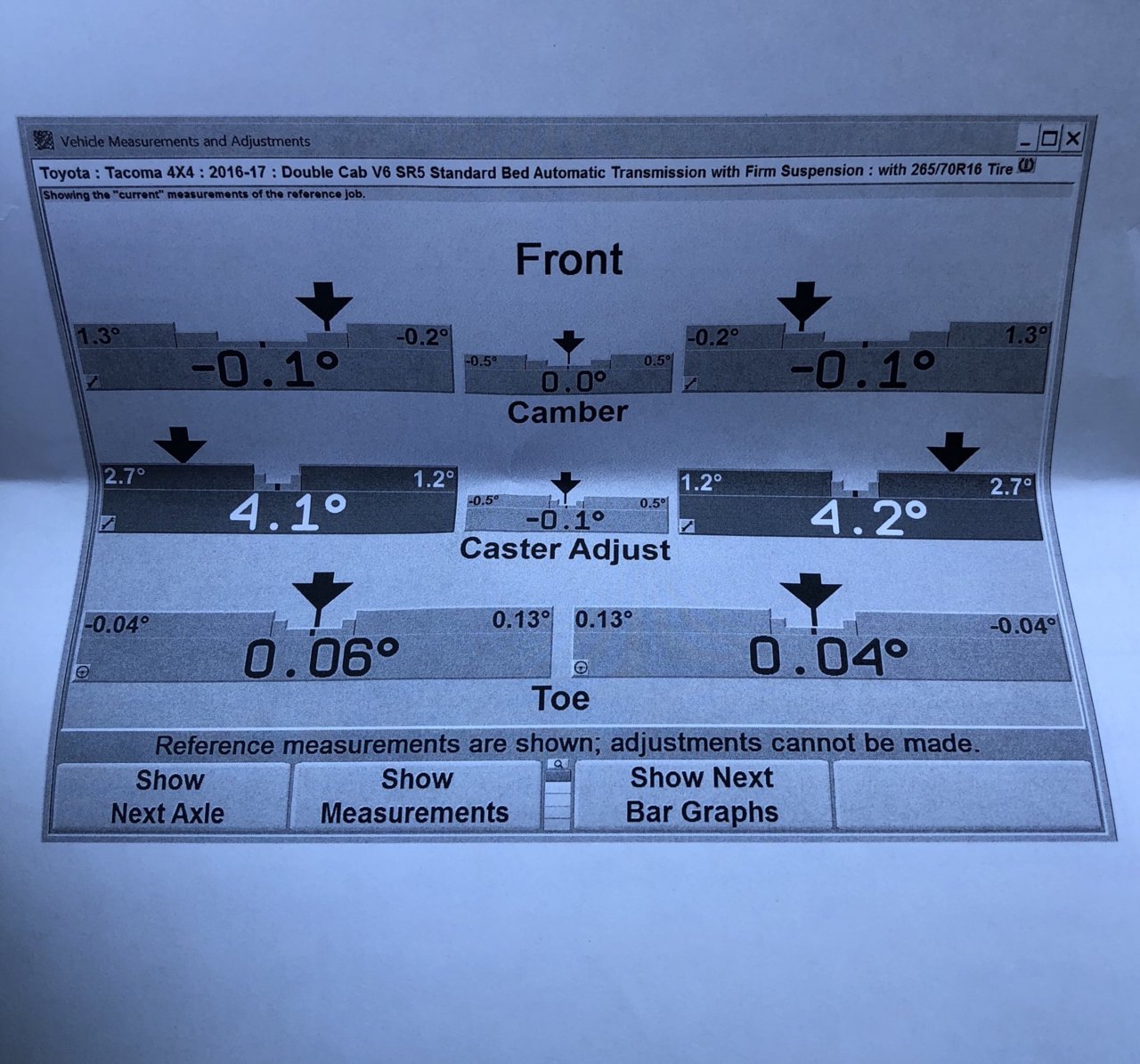

    Did you have an alignment done since you installed the larger tires? If not, you might want to make sure you are dialed in and no issues with potential tire wear. Only reason I mention it is your alignment sheet shows 265/70/16 tires and you said you put on 285/75s. Perhaps the alignment tech just simply didn't input the tires correctly on settings - I don't know.
