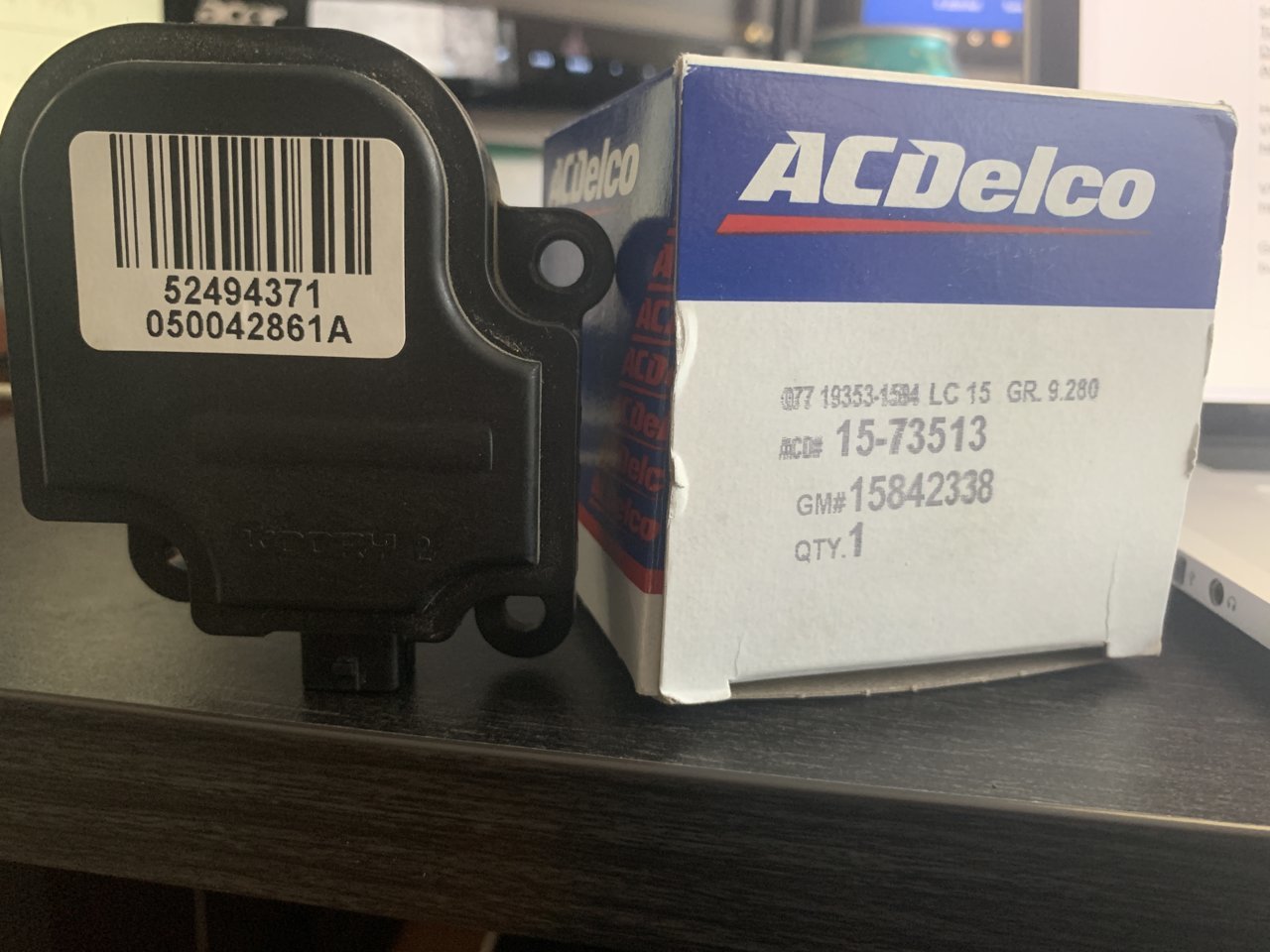

    Hello,
    I had the same issue, I cross referenced the Toyota #52494371 part I removed and found a Dorman 604-109 is a direct replacement for the Toyota recirculation blend door actuator. Delphi (GM company) is the OEM for Toyota on our trucks so I decided to use a AC Delco replacement part as I believe it will be higher quality than the Dorman and nearest I can tell is the OE part originally installed by toyota with their part number (and $187 dealer cost).
    I paid $34 on Amazon for the AC Delco #15-73513 which bolted right in and has been working well.
    SO the following all will work:
    Toyota #52494371 ($187 at Sealership)
    Dorman#604-109 ($48 at local parts store)
    AC Delco#15-73513 ($34 on Amazon)
    Here are some links that were helpful for me getting my repair completed:
    Video 1:
    https://www.youtube.com/watch?v=WMR1bfLfIrc
    Video 2:
    https://www.youtube.com/watch?v=YZuVnbrpiRc
    Good luck! Also if you have large hands its a tuff install, I had my girl friend help and here small hand now not only make me look larger than I am (LOL) but also helped with the install.IMG_1972.jpg

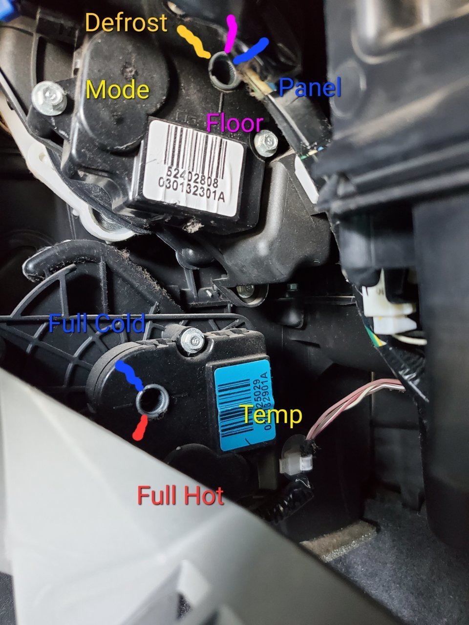

    So, if it’s hot or cold that’s an indication that it’s not working properly?
  18. Jan 13, 2023 at 5:15 PM
    #38
    TnShooter
    TnShooter The TacomaWorld Stray
    Sep 2, 2010
    #42625
    17,362
    Deogee
    07' TRD Off-Road, Auto
    STOCK
    No, ignore the writing on the picture.
    You want to feel the actuator when it’s clicking.
    I used that picture to show what the actuators looked like.
