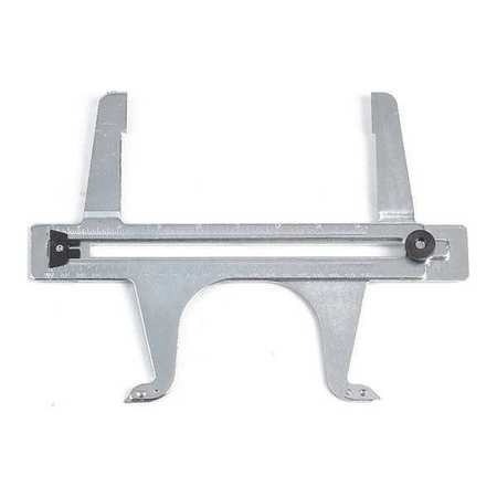

    IMG_0112.jpg This is what I use, perfect adjustment first time.
    Biscuits and GreyComa[OP] like this.

    tomwil
    tomwil Well-Known Member
    May 15, 2014
    #129887
    8,025
    East Coast USA
    2014 Reg Cab 4x4
    What is that called? And where would you find one?
    GreyComa[OP] likes this.

    b_r_o
    b_r_o Gnar doggy
    Nov 17, 2016
    #202672
    13,959
    Alex
    WA
    2015 DCLB
    Brake drum adjuster tool, any parts store

  17. Mar 23, 2018 at 2:00 PM
    #17
    03coma
    03coma Well-Known Member
    Nov 11, 2006
    #203
    941
    New Jersey
    2015 DCSB TRD, SR5
    TRD Pro Grille, Skid Plate, TRD Cat-Back Exhaust System, 2017 Tacoma TRD Rims, ARE Series II Lid,
    Automotive Brake Resetting Gauge, you can get it from Amazon or Auto store. get the aluminum one not the plastic
