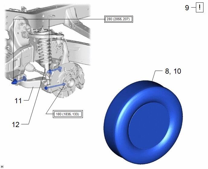

  12. Apr 3, 2025 at 7:29 AM
    #52
    mthopton
    mthopton Well-Known Member
    Feb 17, 2016
    #178440
    497
    ‘03 TRD Prerunner, ‘16 TRD DCSB 4x4 - gone, 24 TRD OffRoad
    Here are the values for the LCAs. I was a little off… 280nm is 206lb/ft.
    This thread has all the suspension torque values.
    max911, TACODOC1 and snickers like this.
