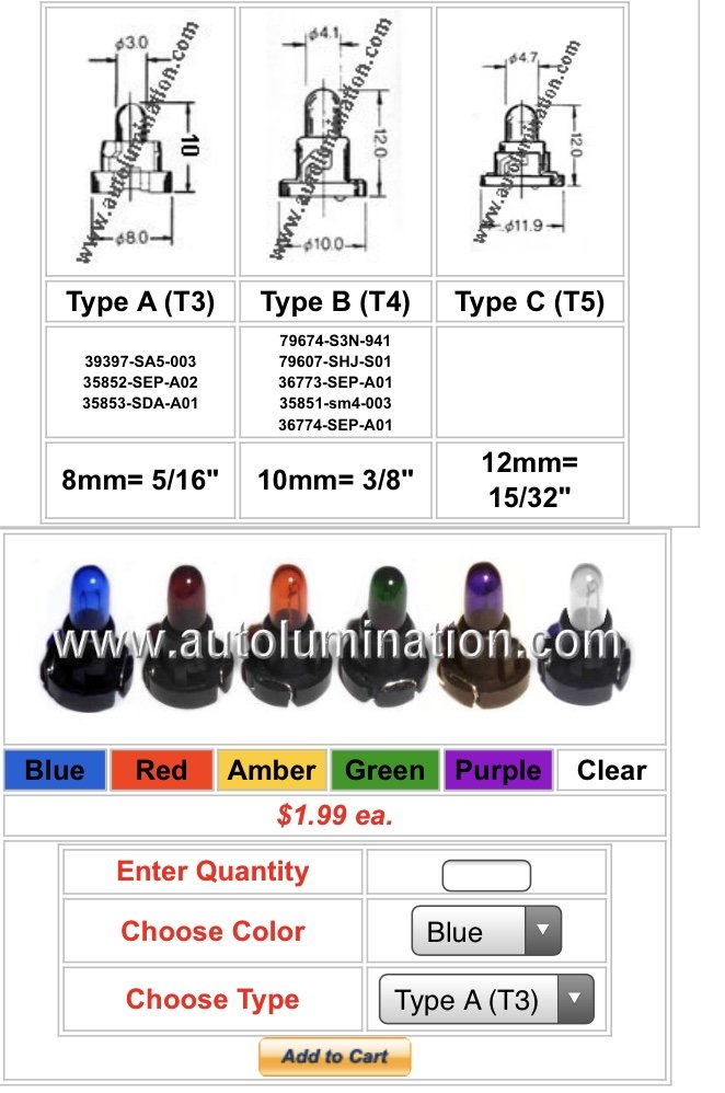

    I believe you want the T4 from that site. I found a post that said the number is: "79674-S3N-941".
    I also read that you could get KT928 from this site: https://store.candlepower.com/jadaandinbu.html
    I would avoid LED bulbs. I bought some 6 months ago and have replaced them 2x. They keep going bad on me. I'm planning on buying one of the above but I just have not done it yet.

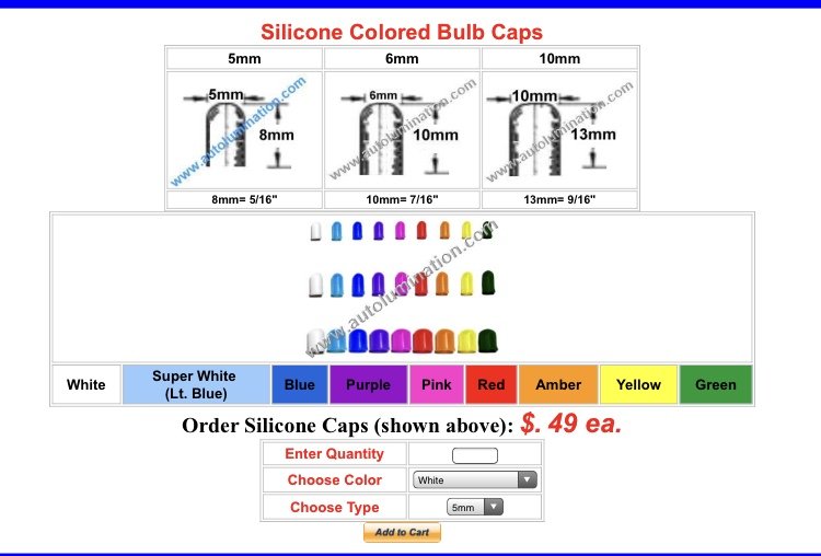

    Here are silicone colored caps for changing color on the incandescent bulbs.
    And here are incandescent color replacements.

    79674-S3N-941 (from above post) appears to be a T4.
