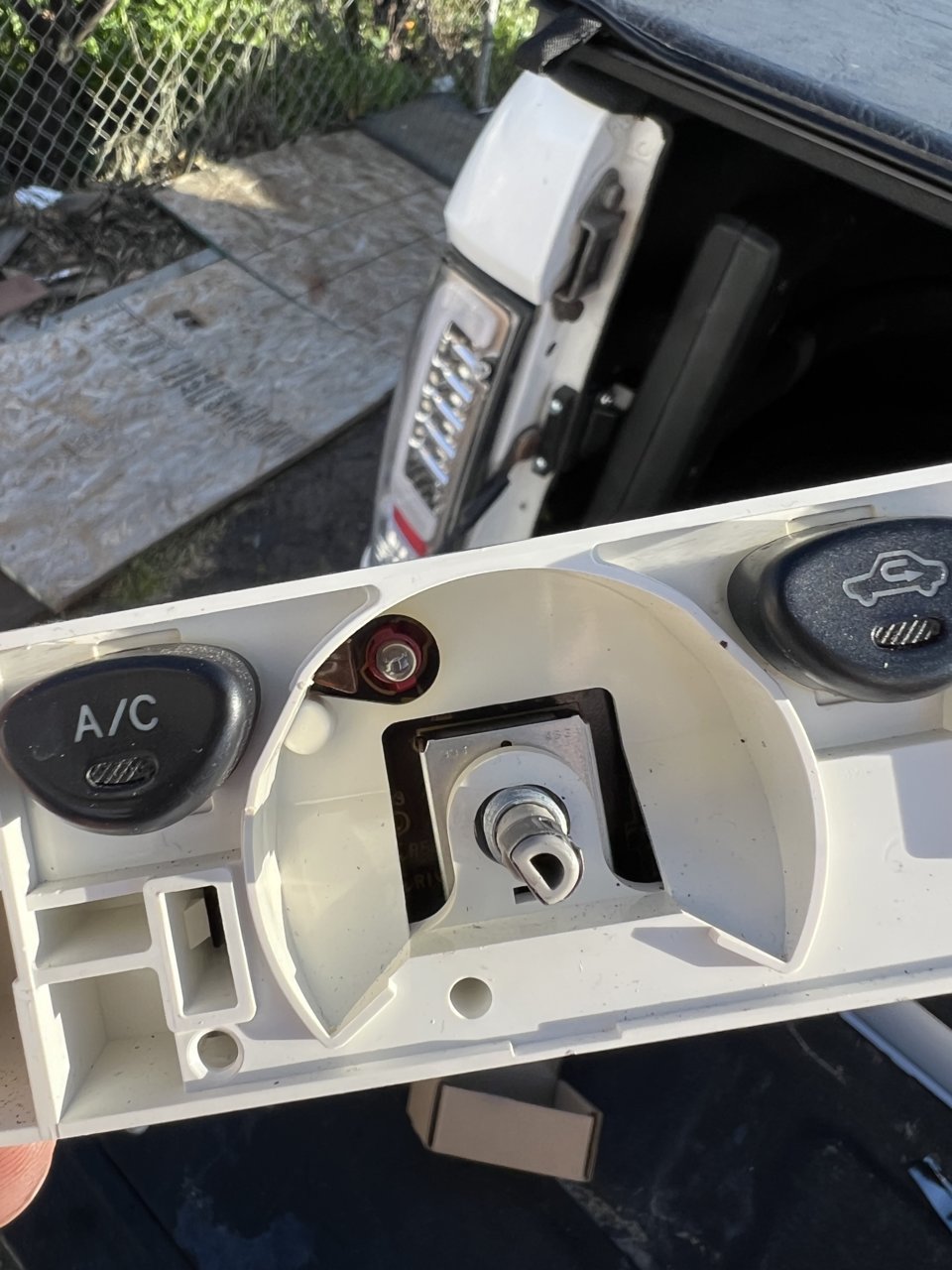

    So I am trying to replace my bulbs on my climate control panel. I lost one base of the bulb and I need to get one of those too now. I also wanted to change then to blue. But I’m having trouble finding them or finding the size to change them. I saw on another post it was a neox4 and or a t4 bulb. But none that I have found supposedly fit my truck. I was wondering if you guys could help me out. Any help is appreciated.

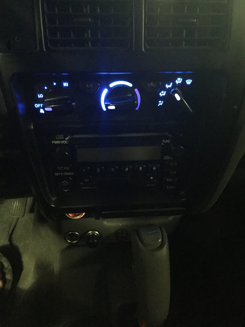

    Here’s the ones I used. They worked great and dim with the rest of the lights too.
    Sorry I can’t be more help

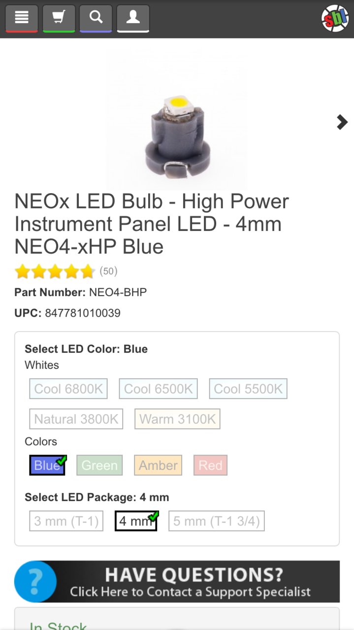

    can’t remember if these can be used in the dash also?
    NEOx LED Bulb - High Power
    Instrument Panel LED - 4mm
    NEO4-xHP Blue
