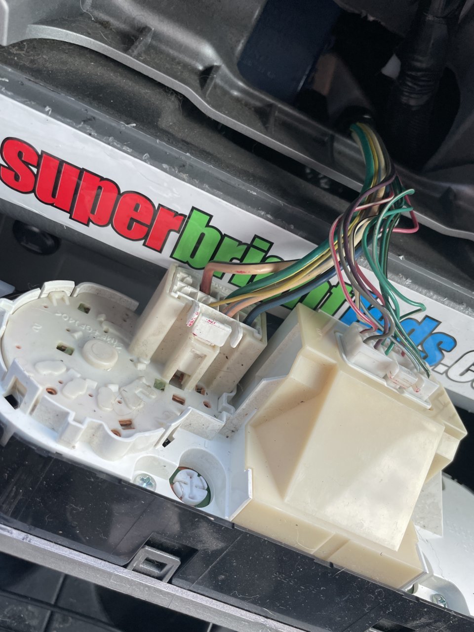

    My wires for my climate control are shot and I already bought the new wiring harness but I’ve looked everywhere for a new connector with no luck. I know this is a problem that a few people have so if y’all could let me know where I could find a new one that would be greatly appreciated

    New connector housing and pigtail from Toyota. You'll also need a new climate control.

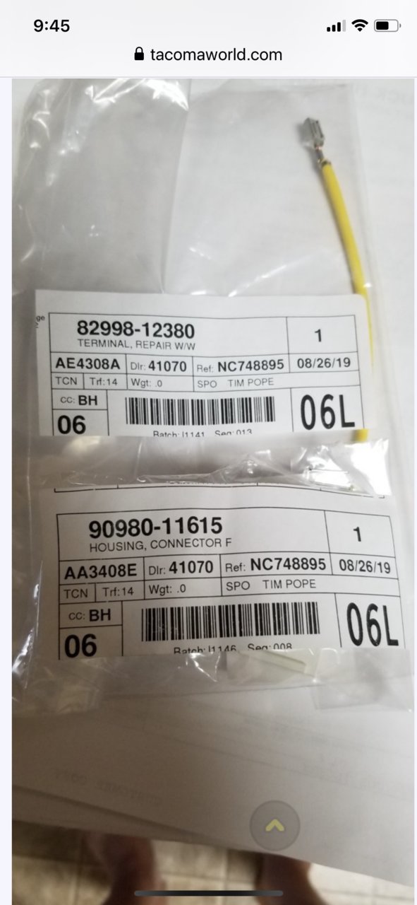

    image.jpg @Muddinfun is part number 90980-11615 for the climate control connector behind the CC panel?
