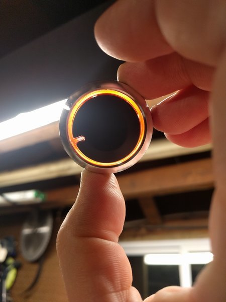

    Orange. May need another light coat with more red. I'll know for sure when it's fully dry and test fitted.
    Mod podge can be found at craft stores for 2 bucks or Amazon.

    Looks great and seems like a good match. The Orange on my Tacoma seems a little less bright compared to my wife's xterra. Was thinking about using an orange sharpie. Since it's not going to be in an area where it'll get touched it might work???
    What was your ratio of red to yellow/ drops per bottle?

    I tested blue sharpie on 1 of my first batch. Not even close color wise and a pain in the ass to get in the nooks and crannies. Take the time to "paint" them.

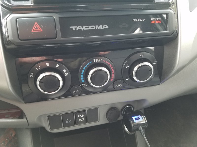

    Got my set a couple days ago but I don't know if I'm feeling them. There's just a tiny bit of play and that annoys me for some reason. If somebody here wants them I'll ship 'em to you for $10. ******SOLD*****

    You can swap out the sleeve from the OEM knob to eliminate the play.

    Still to chromey. I'm trying to get rid of it not add more. I got caught up in the frenzy and bought them because they were cheap and it'd give me a little project.

    I was around 10:3 last I recall but I over poured the modpodge a little bit. I feel like I'm going to need the light coat red but we'll see tomorrow night. Not certain. You can always test on a piece of glass and note your ratio first.

    If you end up with a satisfactory color match and you have an approximate formula you can share that would be great. Did you jut use a model paint brush? Also did you end up using the metal sleeves or did yours fit pretty tight? Thanks for sharing your experience with us.

    After my 10:3 I added more drops of red, I tested on a piece of glass to get as close to OEM orange as possible. (Maybe begin with 1 drop yellow?) I'm thinking a shade darker because the bulbs in the AC panel are incandescent so it's going to add a little yellow. I used little foam brushes I found in the craft aisle in Wal Mart.

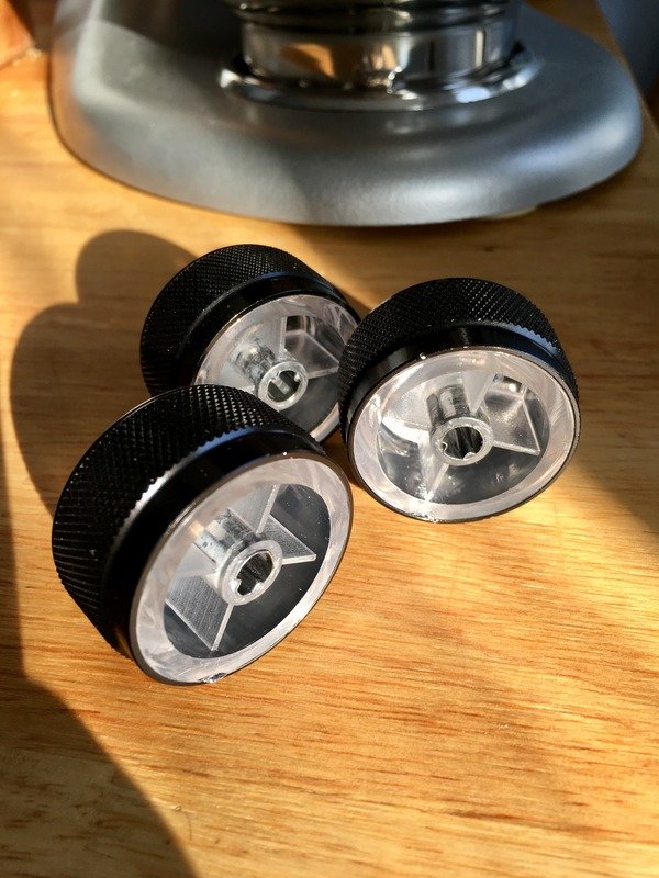

    I ended up also drilling out the centers with a 17/64 bit and putting the OE retainers in...worked pretty well

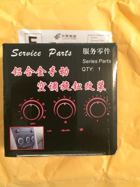

    Mine should be here today... The mail man apparently tried to deliver them on Saturday but my work was closed. :frusty:
    I may cut out a tiny triangle of white vinyl material to use as a "indicator" for daytime driving. Or a dab of whiteout, haha.
    I'll probably put them on while I'm at work and have to wait until later when I get off to see what they look like. :anonymous:

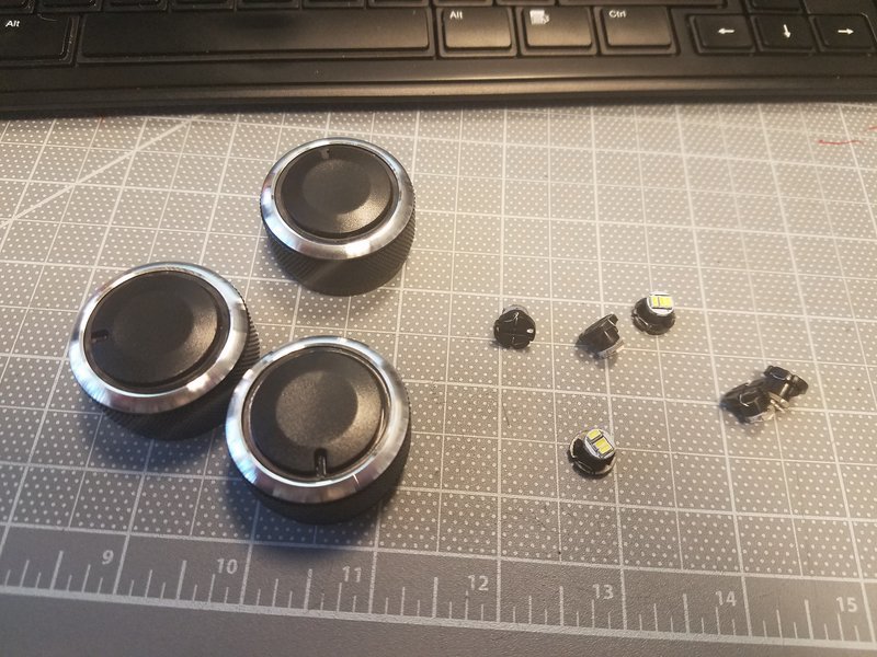

    Update: China delivered today!
    Both the knobs and the LED bulbs replacements arrived at the same time.
    Knobs from aliexpress and bulb/LEDs from ebay. Toral cost for all = $14.29

    Is that a draft table you use as a desk?!
    Can you comment on the "play" once you have the knobs installed. Those bulbs look quality too! Let us know how easy the replacement of those bulbs were too
