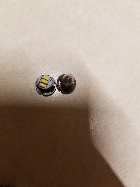

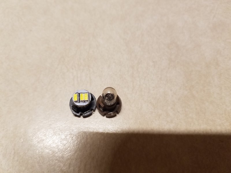

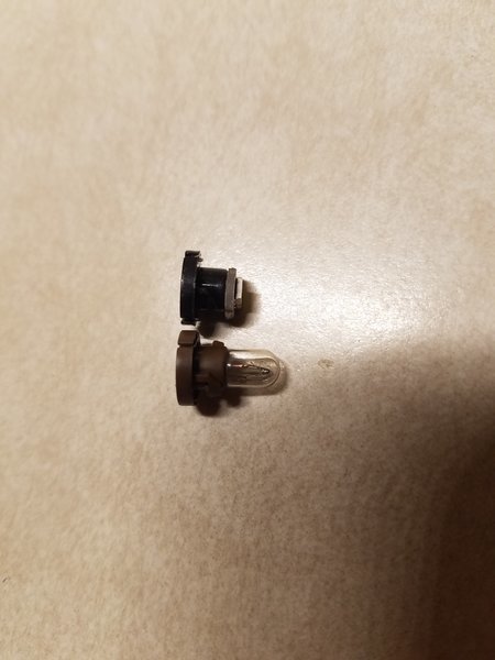

    Shit. So things didn't go as planned...
    First off, if anyone bought the LED replacement bulbs I posted, I apologize.
    They don't fit. :annoyed:
    Specifically, the actual PCBs the 3 LEDs are mounted to are wider than the holes the little bulbs sit in on the back of the whole HVAC assembly.
    I tried shaving the sides but overhandling the little thing broke the wire so that was a bust.
    See the pica of the size comparison.
    The knobs however fit great and at least on my set up aren't loose at all.
    But of course, something weird is going on because one of thr bulbs is now out so roughly 2/3s of the knobs and other indicators actually light. Seriously just earlier they were both working so either I broke it or have gremlins. Probably my fault.
    I'm giving up for tonight because my 6 year old called me in from the garage and barfed. So THAT is how my evening is going! :boom:

    Bilstein 5100's, Eibach springs, Cali Raised Amber fogs,Cali Raised side projecting ditch lights, 17" gunmetal trd pro reps w/ falken wildpeaks, MESO interior lighting, Alpine ilx Android auto head unit, rear view camera, blue sea fuse panel, mbrp cat back, Morimoto retros in Depos, Ranch cap, triple black clazzios, DIY thin lip satoshi with FJ letters, oem roof rack, AJT climate knobs, slim sub behind rear seat, fosgate speakers all around, thule cap rack
    They will fit. You kind of have to push them in on an angle. The base is soft and doesn't grab super tight so don't over tighten. Mine came lose on 3 different occasions before I gave up on these things and went back to OEM bulb style.
    If you want to get crazy, maybe secure them with a small dab of silicone so they stay put but can still be removed if needed.
