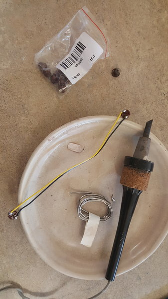

    Here's my attempt at fixing a light that won't come on (fan control knob). In my attempt at fixing it the first time a corner of the plastic circut board broke off essentially severing the connection to the other light. My fix is to solder wire from bulb to bulb and piggyback them to each other on the exterior rather than within the circut board.
    Tested them with a battery and both lit up just fine. I'll find out in about 15 minutes when I get out of work if my plan was successful! :fingerscrossed:
    By the way, it broke trying to get those LED's into the holes so be careful not to do what I did!!

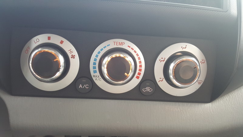

    #52813
    10,395
    2002 Land Cruiser
    Hahaha hahaha! SUCCESS!!!!! :woot::yay::headbang:
