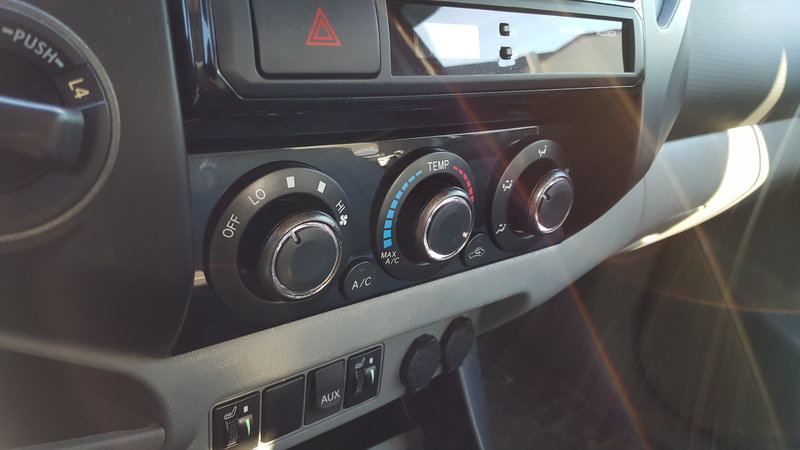

    Got mine and installed, took about 10 minutes total. 5 minutes to come up with a "spacer" for 2 of them, 4 minutes to come up with a spacer for the other 1 minute to install.
    I used a rubber band that I cut down to fit in the slotted section to take up slack on the knobs that have the flat edge which took up slop and tightened them up so no glue is necessary.
    On the other knob which has the matching mating pattern there was a couple mm of slop when turning the knob so I used a piece of 24AWG solid core copper wire I pulled from a piece of Cat5 ethernet cable I had on the desk. Stripped back the insulation and folder the wire over the center hole and put it to one side of the notched out section to hold it in place. No more slop and nice and tight.

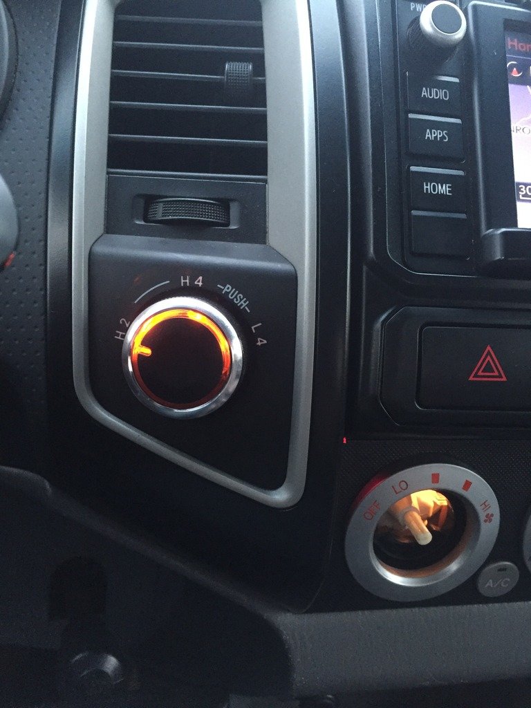

    Mine showed up today. Got em installed using a little bit of Teflon tape on em.
    For whoever was asking a while back -
    Turns out they fit the 4wd knob prefect on my '11. Cycles between 2H, 4H, and 4L no problem.

  17. Mar 21, 2017 at 10:25 PM
    #457
    nazlax10
    nazlax10 Check out my build thread for any products used!
    Mar 31, 2015
    #152198
    2,232
    David
    Woodstock, GA
    '21 Toyota Rav4 LE... At least it's a Toyota
    https://www.tacomaworld.com/threads/nazlax10s-build.408318/
    That's pretty awesome! I wonder what that would look like with the light up circuit board?
