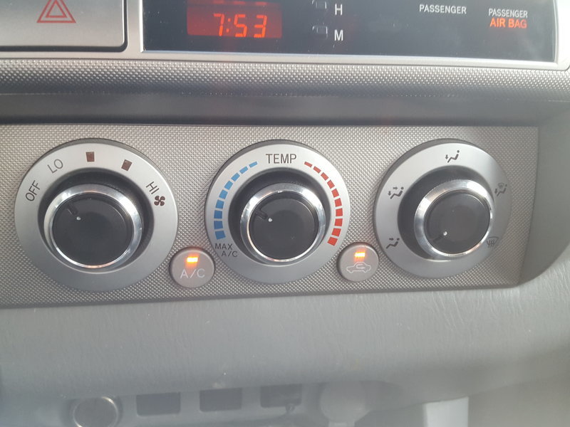

    Mine are on, I added small witness marks so I could see when my lights are turned off.

    I took the extra white backing from a random sticker and cut out tiny little white triangles with scissors and they look pretty good...

    Wife figured it out on the way home from work tonight. Knew something was different but wasn't sure. She got it. LOL

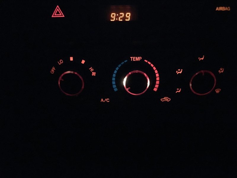

    I still need to wrap wire around my bulbs to get them to STAY THE FUCK ON. Forget not being able to see the cool piping effect, it's annoying as hell not being able to see what's going on with my HVAC at night at all. :boom:
