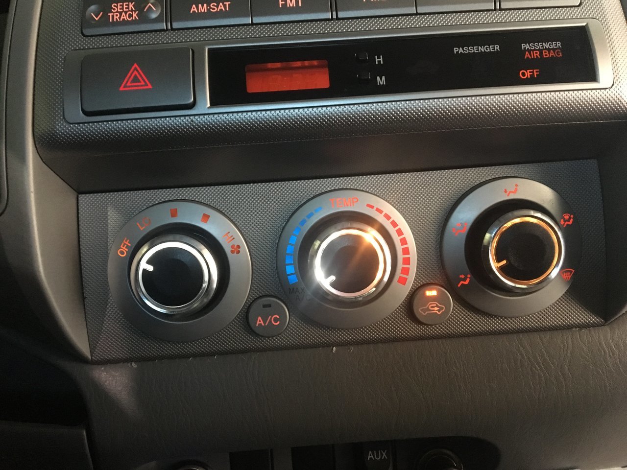

    Not to add more pictures of the same knobs that everyone has posted already, but I went to tint the back side red last night like some people have done. I got some red acrylic paint, but in the end I wiped that off and went with a rattle can - Satin "Poppy Red" Rust-Oleum. So much easier to manage and cover every sharp angle that allows white light through, faster trying times as well. I felt like the acrylic was too thick. I did probably 5-6 very light coats of the spray, probably could have gone with a little less.
    Whats funny is you only need to paint the flat part of the back of the clear plastic, no need to paint the insides at all really from what I can see. I had a bunch of acrylic paint left inside mine from the 1st attempt, if you spray yours, it's not going to hurt to get paint down in there.
    Taped the knobs off, make sure you plug your hole:
    https://i.imgur.com/0TpxBtb.png
    Final. You can see the knobs are a bit more "red" than the HVAC controls (they are pretty washed out in this pic looking at it now):
    https://i.imgur.com/7V9mo5e.png
    next step is to add some type of indicator on the outside. I actually have a little bit of a tough time seeing it at night too...maybe too heavy with the red. Going to try something while that will maybe let some light through.

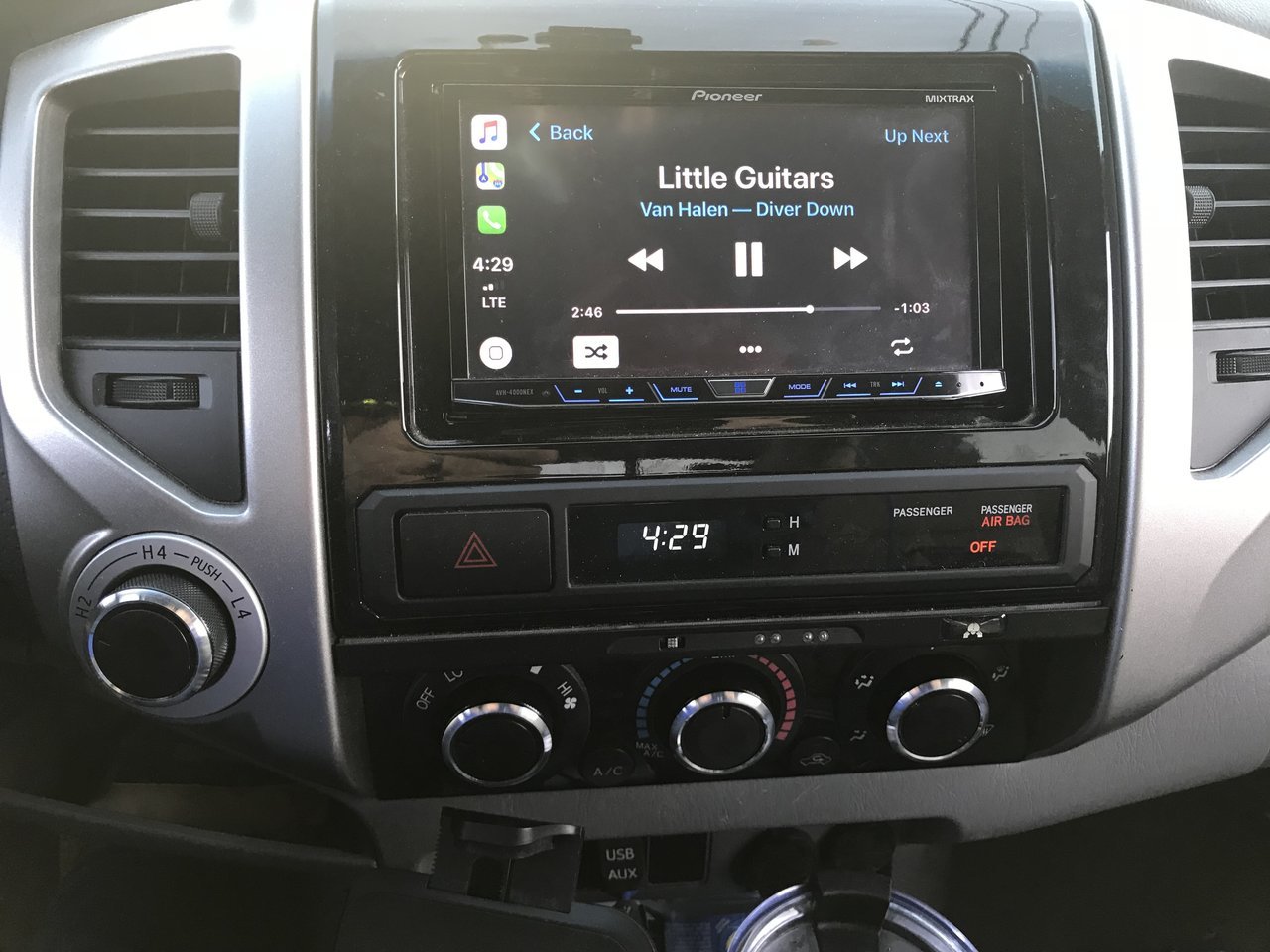

    I put a little dab of white paint on these, turned out pretty well I think. Maybe they will be easier to see the position in the daylight.

    Pro Taco 11
    Pro Taco 11 Sitt Head
    Mar 13, 2012
    #74849
    880
    Rob
    Joliet, Illinois
    Tacoma TX Pro 2011 4x4
    3" OME, RAAL, TRD Exhaust, Pioneer DBL DIN, Weather Tech's, Bull Bar, AFE CAI, Anytime Fog, Map/Dome light mod, Ultra Gauge, Tail Gate theft mod, Second Set of D-Rings in bed, Dura Tracs 285's, Satoshi deep dish, Leer 100 XQ, Wet Okole seat covers
  9. Jan 5, 2018 at 12:55 PM
    #689
    fshams
    fshams Well-Known Member
    Aug 12, 2009
    #21067
    631
    Columbus, OH
    2012 Tacoma V6 4x4 TRD/TX PRO - DCSB
    Did you add your own pointers to the knob? how?
  10. Jan 5, 2018 at 1:10 PM
    #690
    Pro Taco 11
    Mar 13, 2012
    #74849
    880
    Rob
    Joliet, Illinois
    This is exactly what I want to do with mine. Put ine on the 4x4 switch. You didnt have to modify the knob at all? I ordered 3 and 1 seperate to do this.

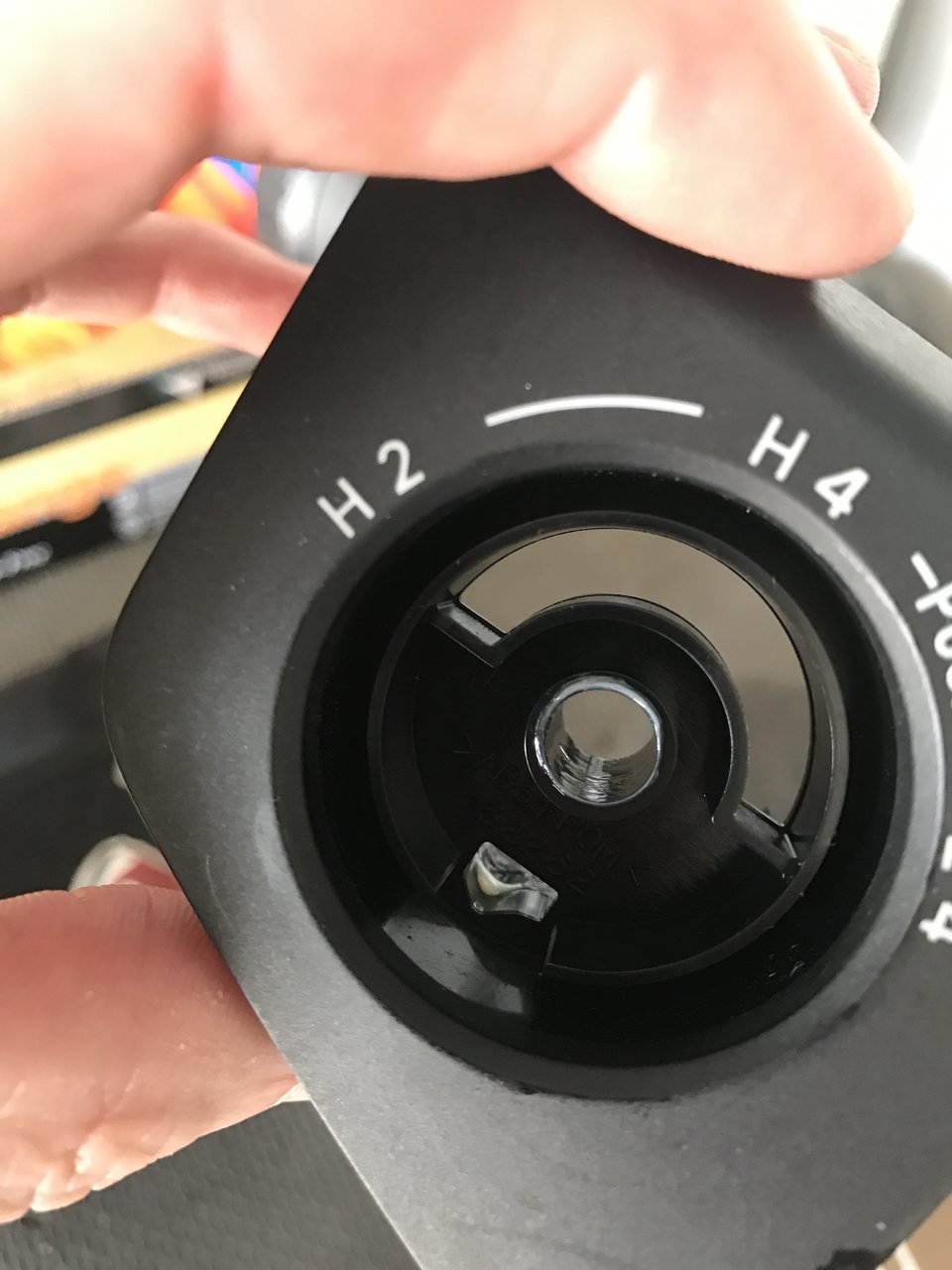

    Ok so, I installed the knob onto my 4x4 switch and it for perfectly. No metal sleeve needed, no play on the knob. Wverything was great until I selected 4 low and when I pushed the knob in and moved it to 4 low the knob didnt stop and somewhat over rotated. I heard a snap sound and my truck was stuck in 4 low!!!!! I thought WTF do I do now. So I somewhat muscled the switch back to 2 wd and now I really dont feel any clicks on my switch and it free floats so Im nervous about the switch moving into 4 hi by itself through vibrations.
    Looking at the original knob, there is a finger sticking out from the back that fits into a groove in the switch that stops the knob from over rotating. Im letting you all know this as I dont want this to happen to you guys. I nowhave to buy a new switch which isnt that expensive but costs more than the mod!!!!!
    Happy modding all.

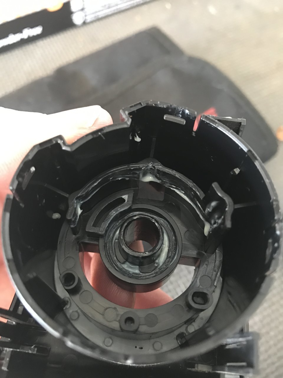

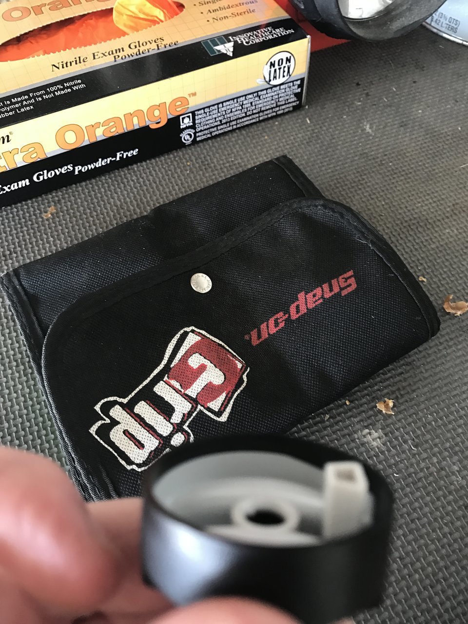

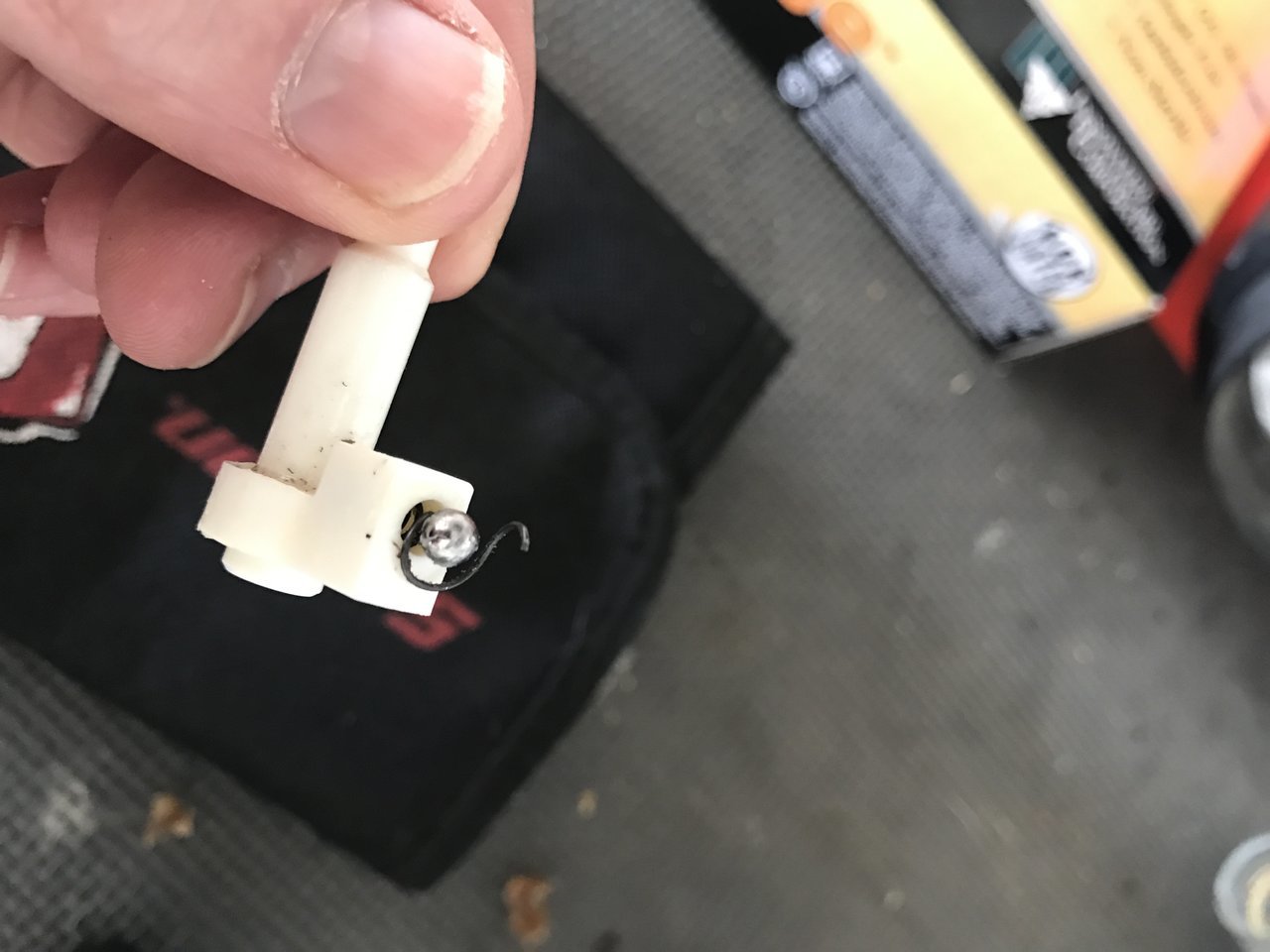

    So today I decided to see what happened to my switch after being over rotated. Like the above post said I was stuck in 4 low and muscled it back to 2 hi.
    As you can see in pic 1, the oem knob has a finger that sits in a grove in housing, pic 2. The after market knobs, as cool as they are, do not have that finger for the grove thus the knob over rotated. Pic 3 is the backside of housing and pic 4 is the white stem that the knobs attatch to on front. There is a spring with a little ball bearing on the end of it that sits in the groves in pic 3.
    Upon disassembly, the spring was jacked up and the lil ball bearing was stuck to the white grease. My switch just free floated and didnt have those clicks. I was affraid that the vibes and bumps of the road would make the knob turn on its own.
    I was able to fix it today and just wanted to share my experience with you all as I dont want to see this happen to anyone but there is a fix and it was pretty easy. Being stuck in any 4 wheel drive on dry pavement will not end up well.
