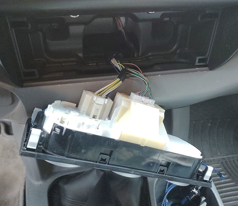

    Is it hard to remove the pane of dials? Is there a thread on that? Don't you just pry the whole row out with a screw driver or something? Feel like I've done it in the past but can't remember...

    Use a plastic pry tool and it pops right off.

    The whole climate control panel. Its just held in with panel clips.

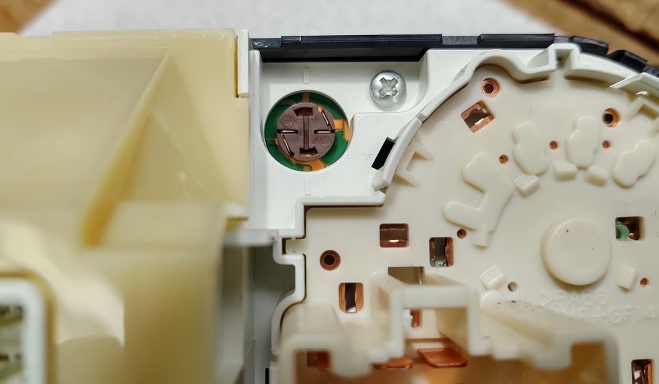

    I've been trying to get leds to work on mine. I'm pretty sure the contacts on the board ar an issue. I can lay the led one on the board led up and it will work. I flip it and can't get any connection. Yes I've check polarity. My incan bulbs are dicey when they are inserted. I get intermittent off, I tap on the dial and it comes on for a while, then off, I tap on it and back on, most of the time. I have to keep taking the panel off and jacking with the bulb to get it back on.
    Inspecting the board and there appears to be wear on the copper. I did the erase clean, and alcohol wipe. Not helping.

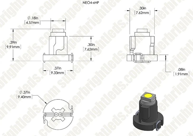

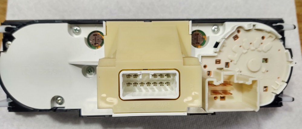

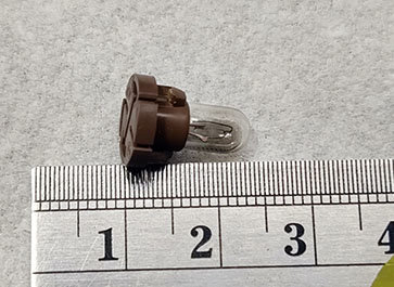

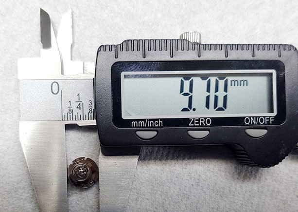

    I'm looking for a replacement bulb for the HVAC control panel and found this older thread and this recommendation for an aftermarket LED bulb. There are three variants on that product page and some people were asking which one to get...well, the answer is in the part number @cdma95 posted...NEO4-NWHP.
    In case anyone in the future is confused about this, the 4 after NEO denotes the 4mm size and NW after the dash is "Natural 3800k White". The generic part number is NEOx-xHP where the first "x" is the size and second "x" is the color of the bulb.
    I ordered a couple of the NWHP and a couple of the WHP (Cool 6600k White) to compare and see which I like better. I'll post results once they arrive.
    And just to confirm, I did measure the plastic base of my bulb and it came out to 9.7mm which is closest to the 4mm model (which specs out at 9.4mm...close enough, I guess). Some photos:
