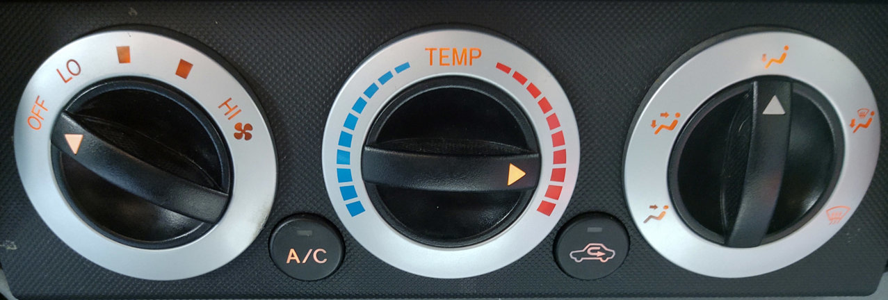

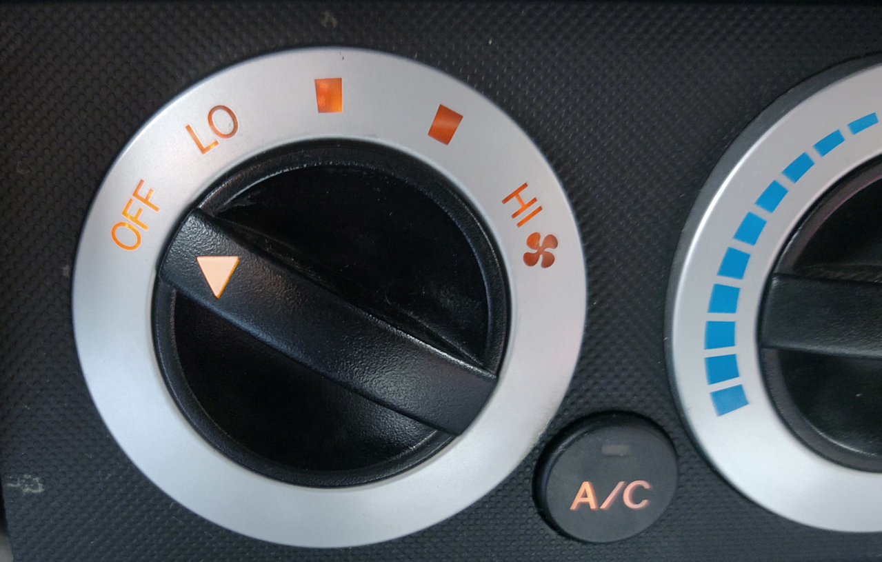

    I installed the WHP (cool white) bulb first. Works ok but the light is "splotchy" and uneven as if it's more directional than omni-directional so not all the lit elements appear even...some are darker than others. It looks worse in real life and especially at night compared to the photos which tends to normalize the illumination.
    I swapped in the NWHP (natural white) and it's a little better but you can still see the uneven illumination.
    Overall, not impressed with the bulbs. They illuminate, but not evenly. And I would recommend NWHP over WHP if you do go this route.

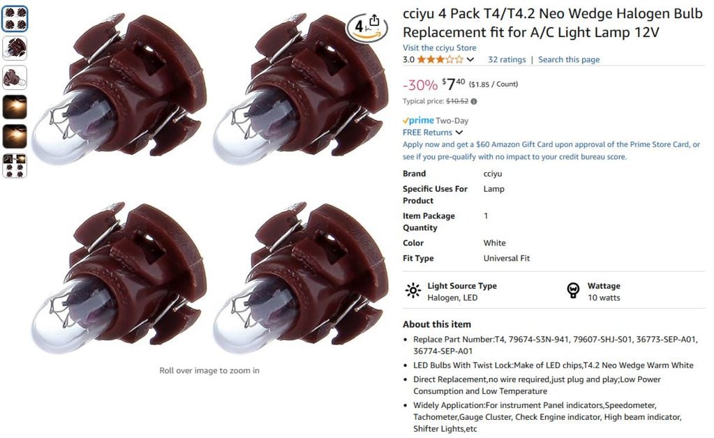

    Hey guys!!! I found the correct bulbs!!! I just ordered them on AMAZON and they work perfectly.
    cciyu 4 Pack T4/T4.2 Neo Wedge Halogen Bulb Replacement fit for A/C Light Lamp 12V

    They don't have the correct replacement, it's close, but not exact. It's also too bright in the middle, it doesn't shine enough to the sides.

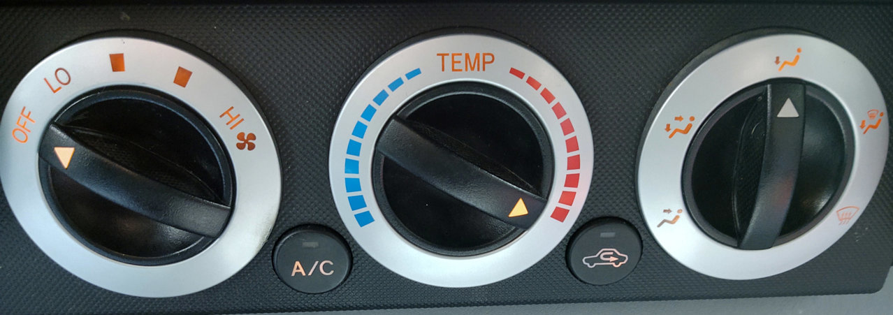

    I (partially) addressed this by adding a drop of clear hot glue to the center of each of the Amazon LEDs that I installed. The light refracts through the clear glue and the controls are bright enough for me to see at night.
    I replaced the bulbs in all my lighted switches and in the HVAC control panel with LEDs 2 years ago. No problems.
