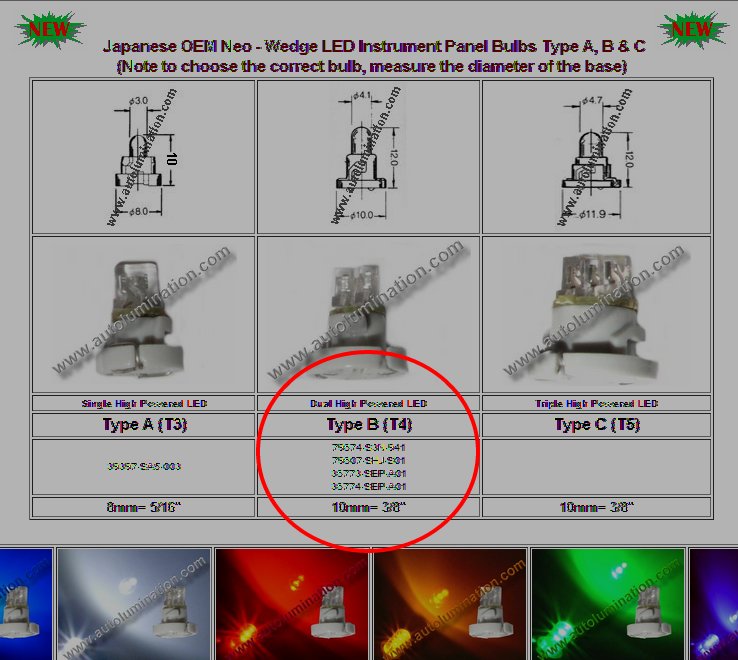

    I bought mine here (for LEDs scroll down until you see this):
    http://autolumination.com/74.htm

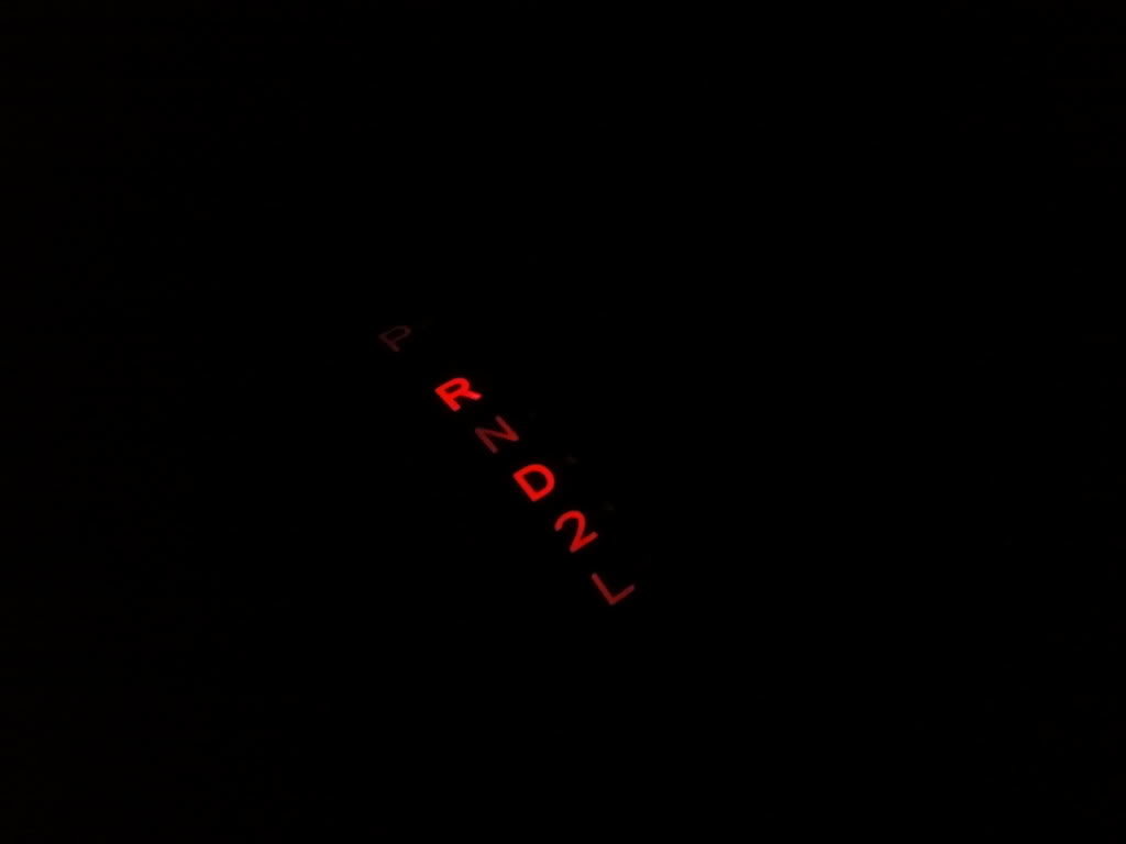

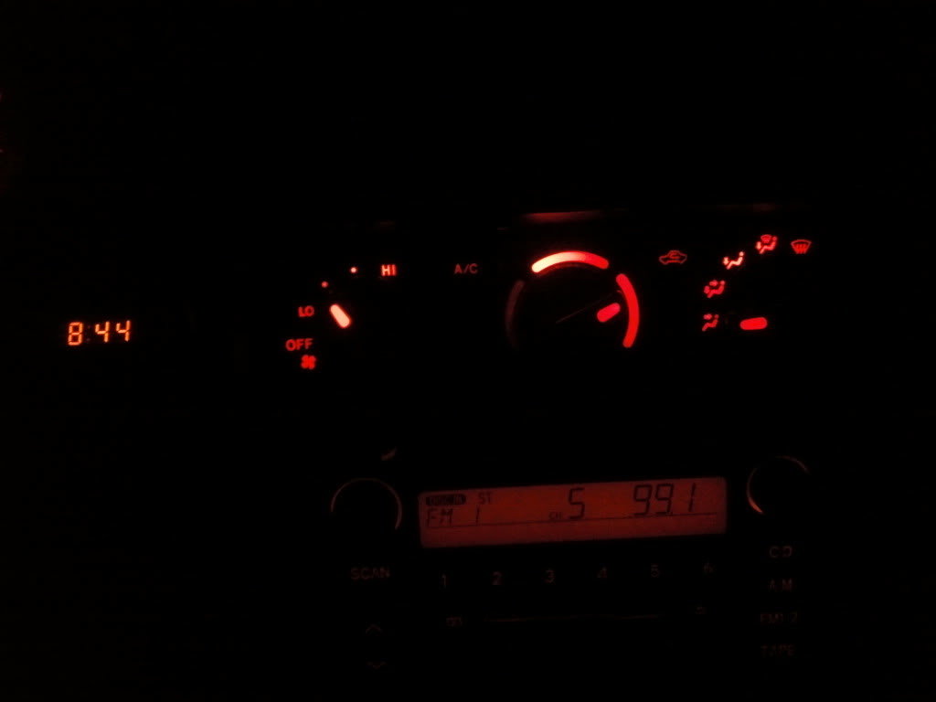

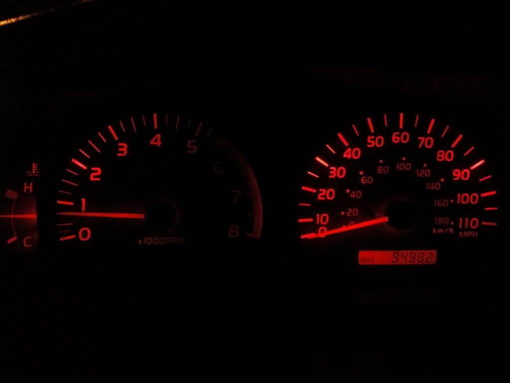

    I used Red LEDs but they sell regular or LED bulbs there. Here's a photo:
    Rest of the dash:
    PRNDL:
  8. Jan 7, 2012 at 10:08 PM

    Got mine on ebay. Search "T4 neo LED"
    You forget one on the tach?

    I think one of the "sockets" is a bit flaky. I have to get a replacement and tear into the dash again. I probably won't get a chance until spring. :(

    If you werent aware, the LEDs can only work one way. If you take it out, turn it 180 degress then put it back in it might work.
