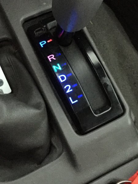

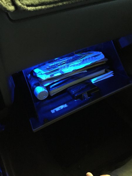

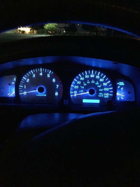

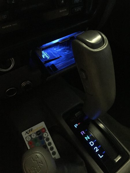

    Yes stock light gives off an amber color but it's a clear bulb with an orange condom on it! Lol! I changed my whole interior over to blue. Glove box, gear shifter, ash tray, HVAC, instrument cluster etc. I got rid of the Orange cigarette lighter ring

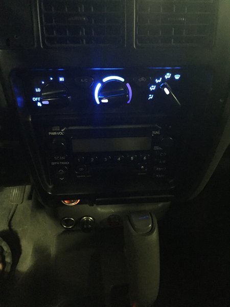

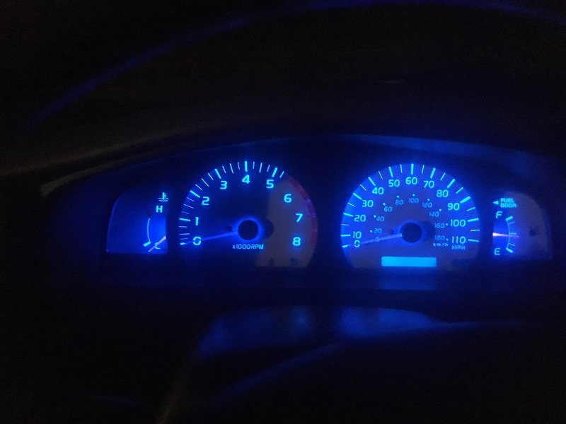

    Here's mine.
    Instrument panel had orange cover on clear bulbs and ac panel has clear bulbs but has orange coating on panel.

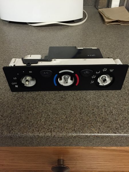

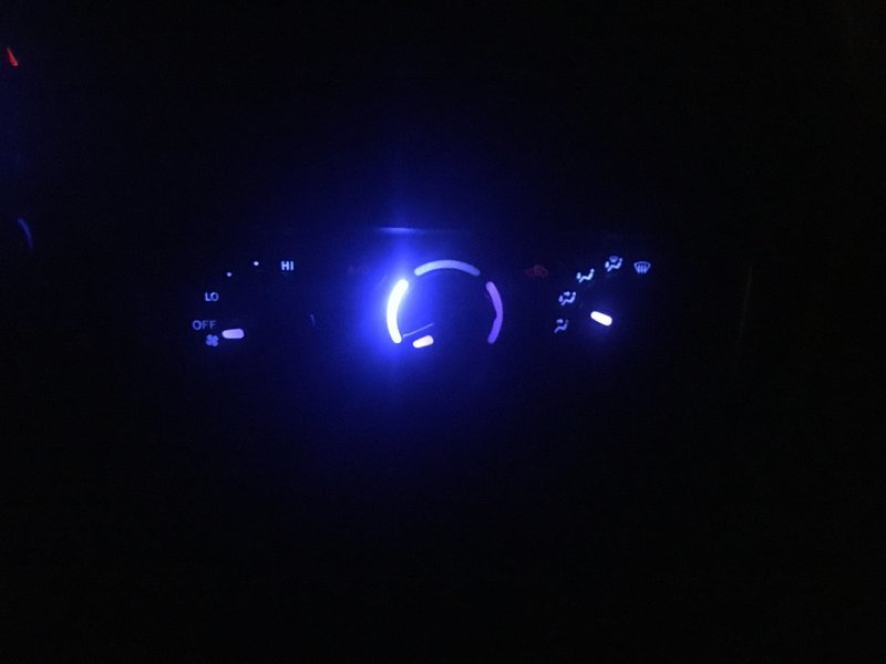

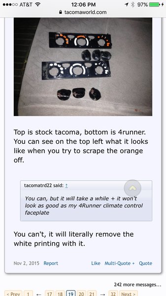

    Yeah you have to buy an HVAC unit out of a 01,02 4Runner. They have clear backplates. Unlike the Tacomas. And you can't scratch the orange off or this happens. Here is the 4Runner HVAC unit I bought from LKQ for $40. But I've heard they're selling for significantly more. Yes the HVAC bulbs are dimmable.

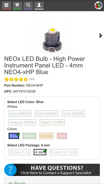

    Here are the bulbs I used for the HVAC area. Neo4mm

    Neo4mm
