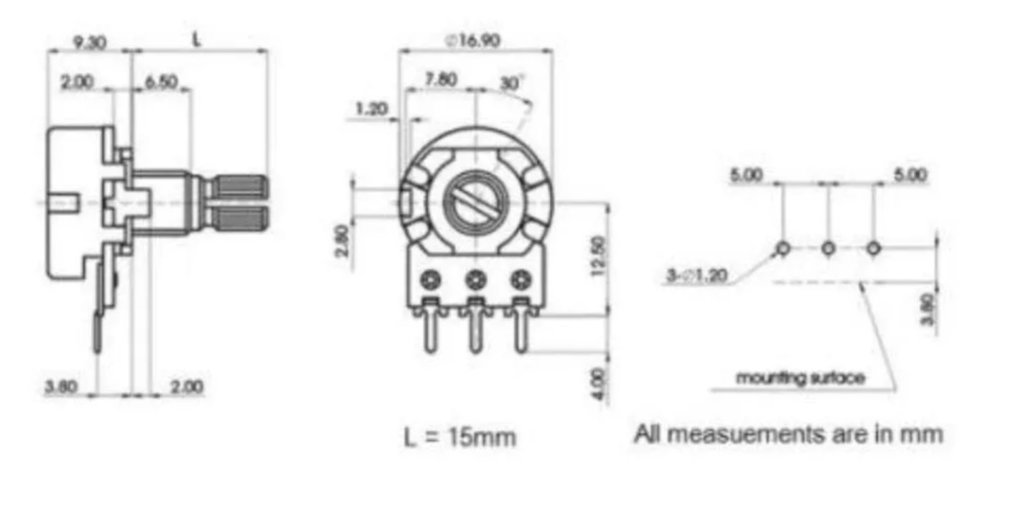

    I don't think I read this whole thread at first, but I have now. Has anyone just tried a soldering a standard 3-pin ~3kohm pot to the 3 pins mentioned? You won't have the detents but I'd be surprised if it was that precise. Just bend the pins downwards and solder to their 3 respective pins (quoted below).
    2k pack, pretty cheap: https://www.ebay.com/itm/391912960238 (closest alternative cheap version I saw was 5k. If it's just measuring a voltage divide, I'd get that one instead for current safety)
    These style are on the smaller side from experience, but they may be too thick to fit in the space (someone else will have to confirm). Specs should be close to:
    Even if you want to dremel the shaft to get the OEM knob to fit, and do some gluing, hell of a lot cheaper than the alternatives posted.
