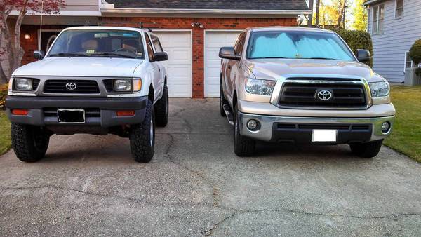

    before1.jpgPictures of the truck pre-build

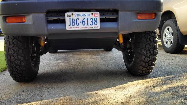

    Suspension work. Installed lift, replaced bushings (steering rack, LCA bushings, sway bar bushings), replaced brake lines, replaced UCA's, replaced lower ball joints.

    Some after shots.

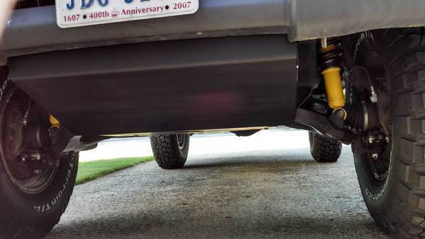

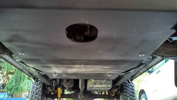

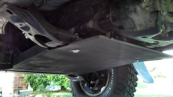

    Forgot to put the pics of the RAT skids.
    The paint job is streaky, but I used rustoleum etching primer (3 coats), then rustoleum flat black (2 coats).

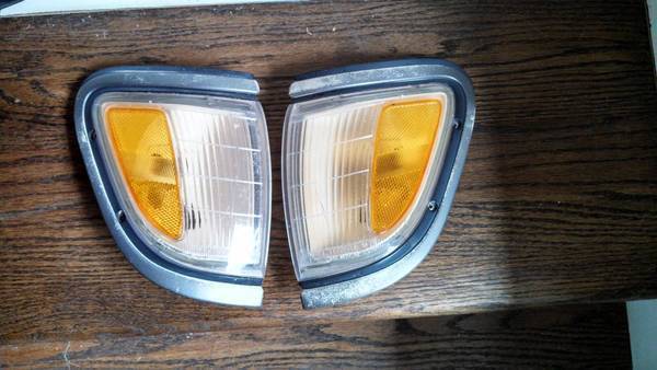

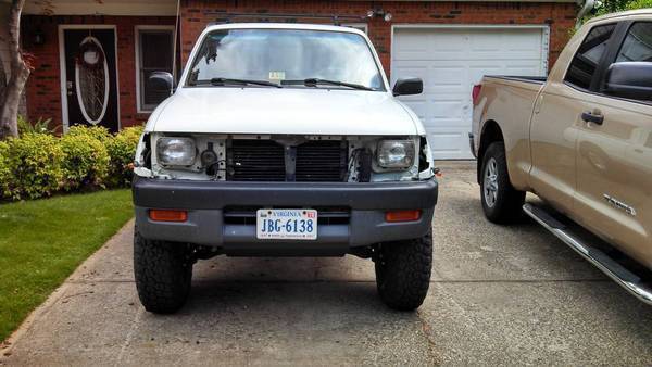

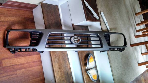

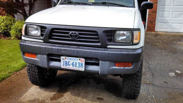

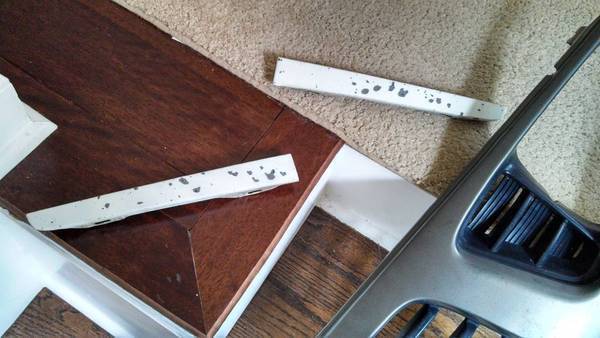

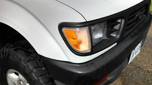

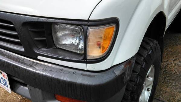

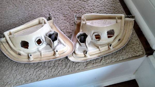

    So this was my work from today. Plasti-Dip'd the grille and side marker lights. I preordered clips before I started so when I broke most of the originals, it was no big deal. I sanded the grille and edges of the marker lights with 220 grit, then sprayed them. I sanded the metal inserts with 180, re-primed and then painted with white paint. I like the improvement.
    Before
    After
    In Process:
    Good shot of the turn signal mod. I used a dremel to cut the holes, and run amber bulbs.
