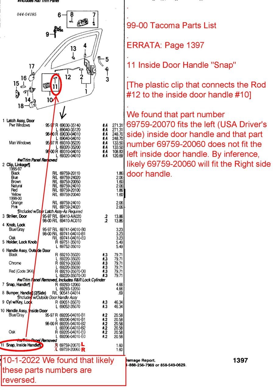

    Perhaps this will help, though from parts list for 99-00, not 01. Clip/parts numbers are different for passenger side and driver's side; we found these part numbers switched:

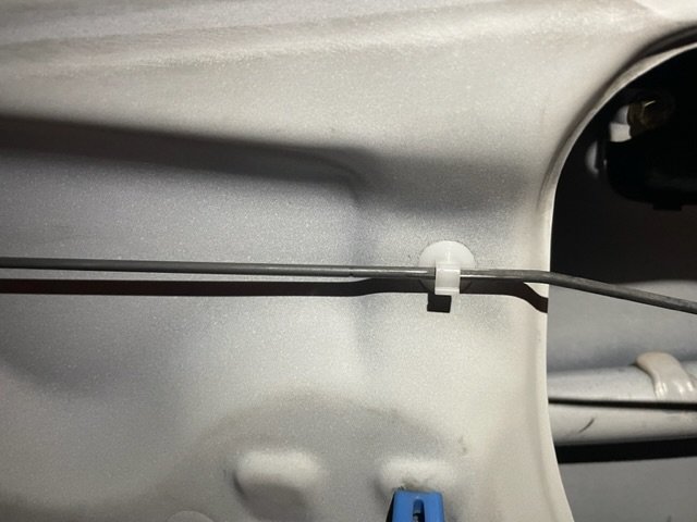

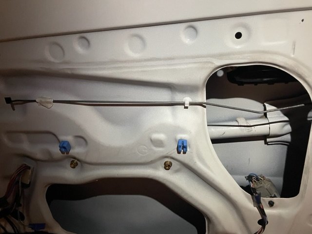

    In the offchance this is useful to someone, 69749-89101 is actually the right part number for the rod support clip, which goes midway between the interior latch and the lock. The important part is to press them in, I didn’t until just now and they fall out. But if you push on them they will seat with a very satisfying click. And I doubt they will come out unscathed, I broke both of my originals while trying to clean around them.
