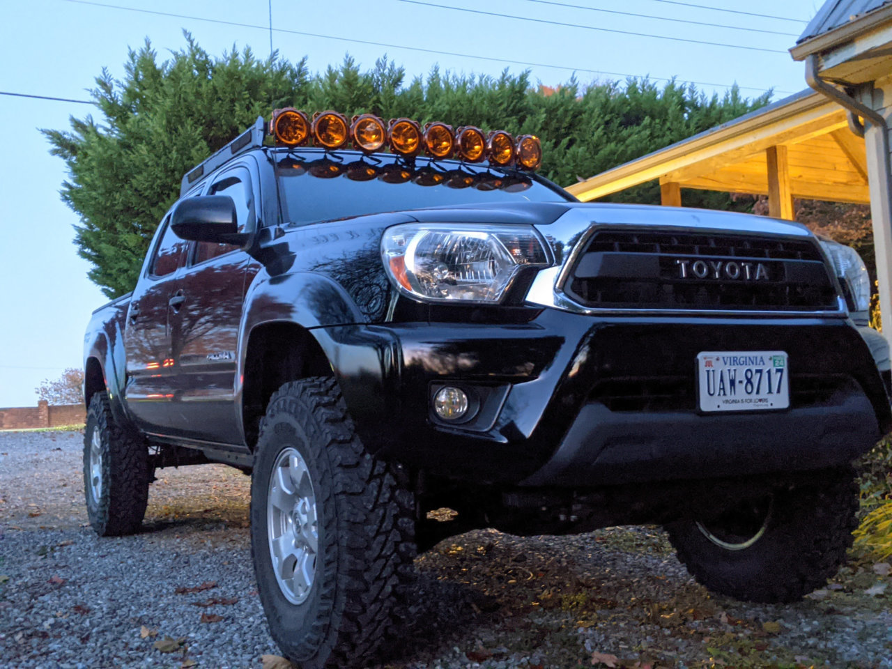

    Found a great truck, was really happy with it but the itch to mod wouldn't go away. So, I've decided to collect all my bad ideas in one thread. Collected list of modifications below, details and pictures to follow.
    Truck is a 2015 OR and had only 14k miles when I found it in 2021. A perfect candidate for a long-term daily driver. It couldn't stay stock for long. The plan is to eventually end up with something comfortable and capable for family trips to the outdoors, as well as a little fun on the tougher trails.

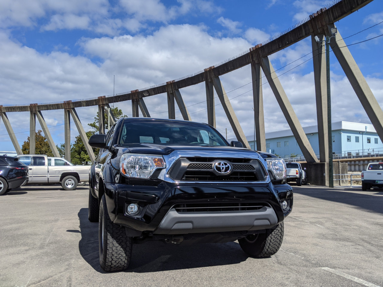

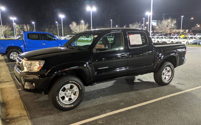

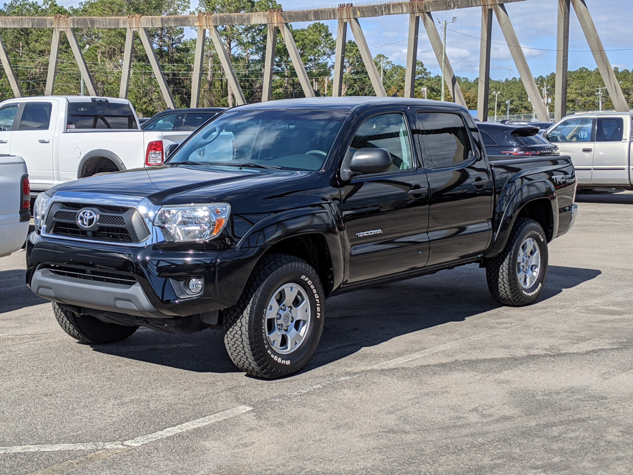

    Appreciate the patience, working on a year's backlog of mods and pics. As it came home in March 2021 (note the original tires):

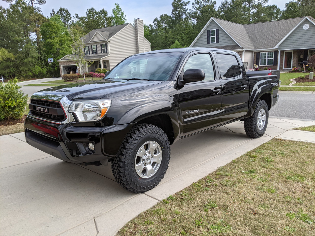

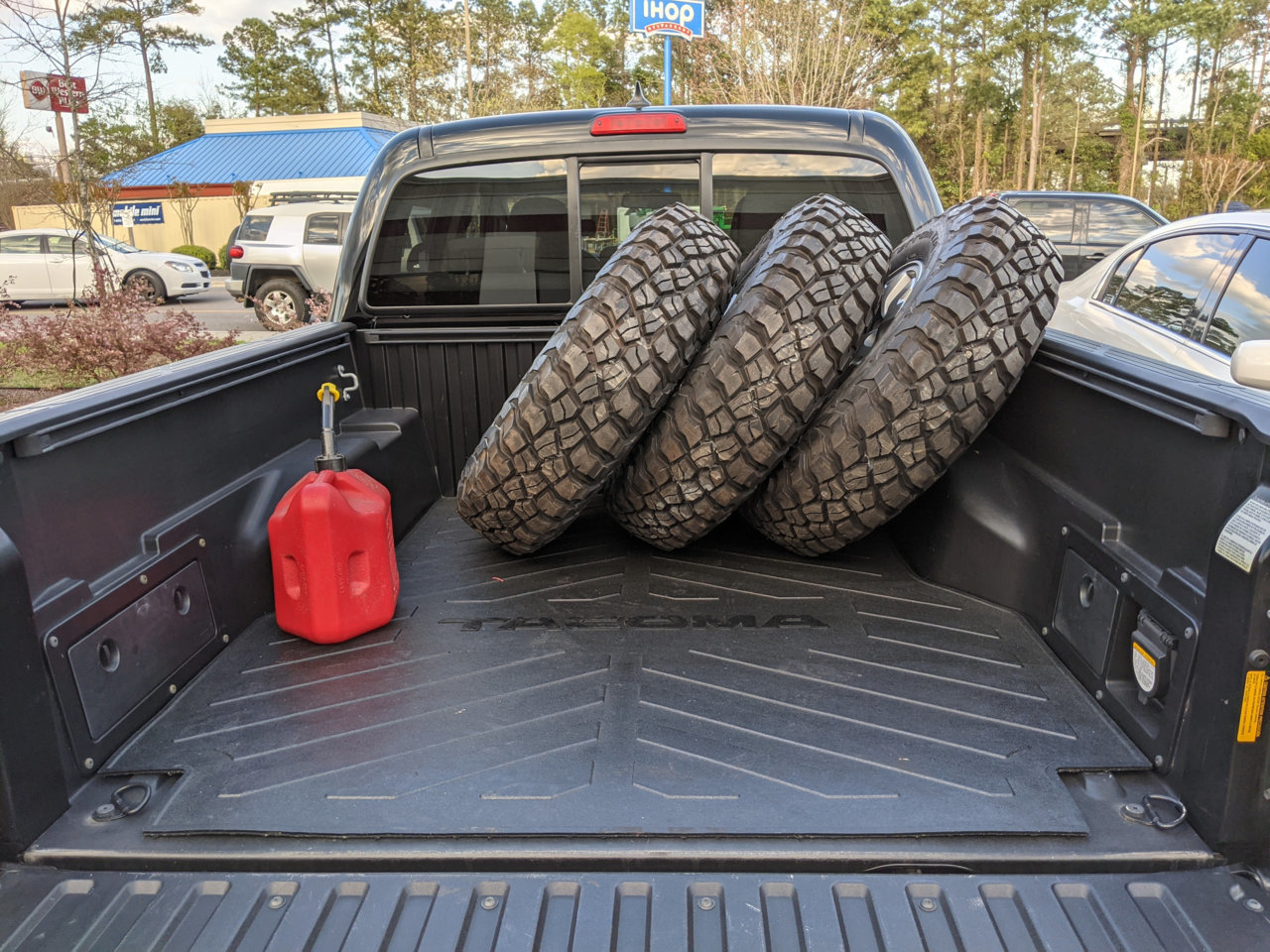

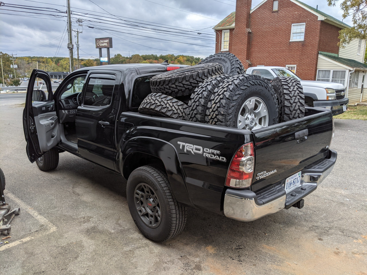

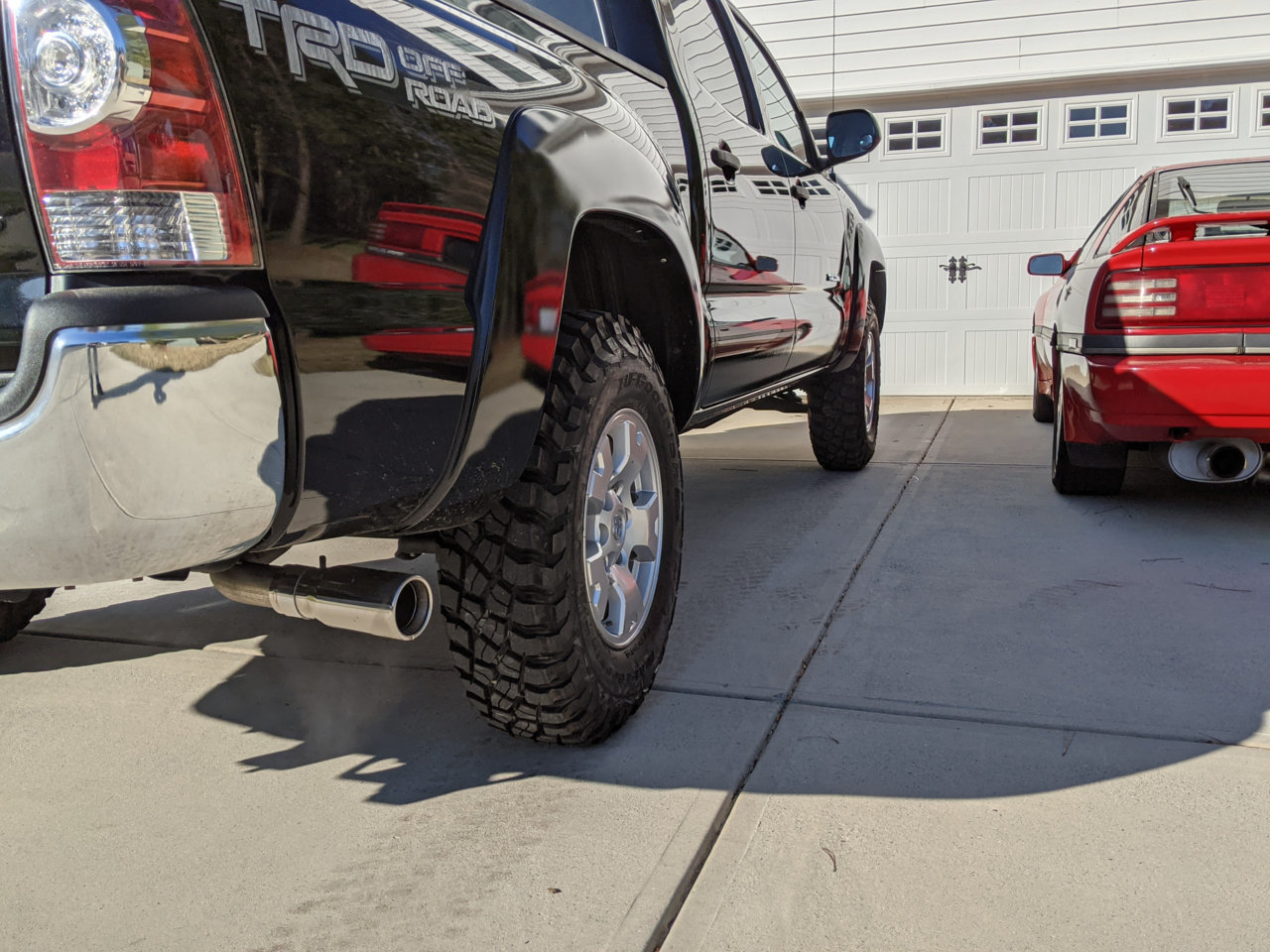

    Mod backlog - assorted wheels and tires:
    SEMA wheels arrived to replace the dry rotted original ATs
    Time for some MTs on the stock wheels. 7.50-16s were a little too skinny.
    Went with some 235/85s instead.

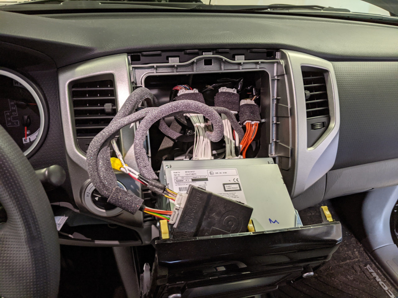

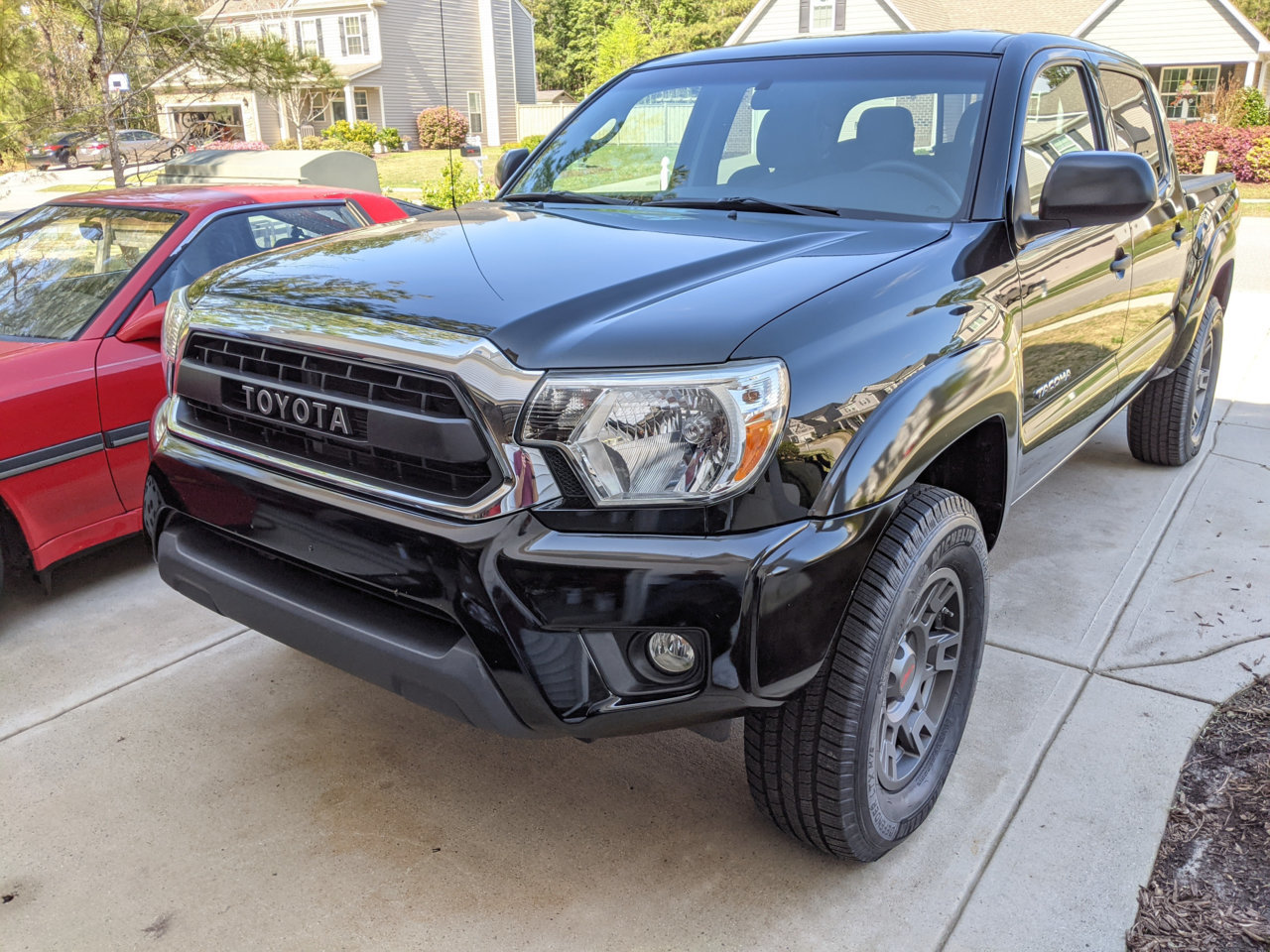

    Mods backlog - lighting and interior:

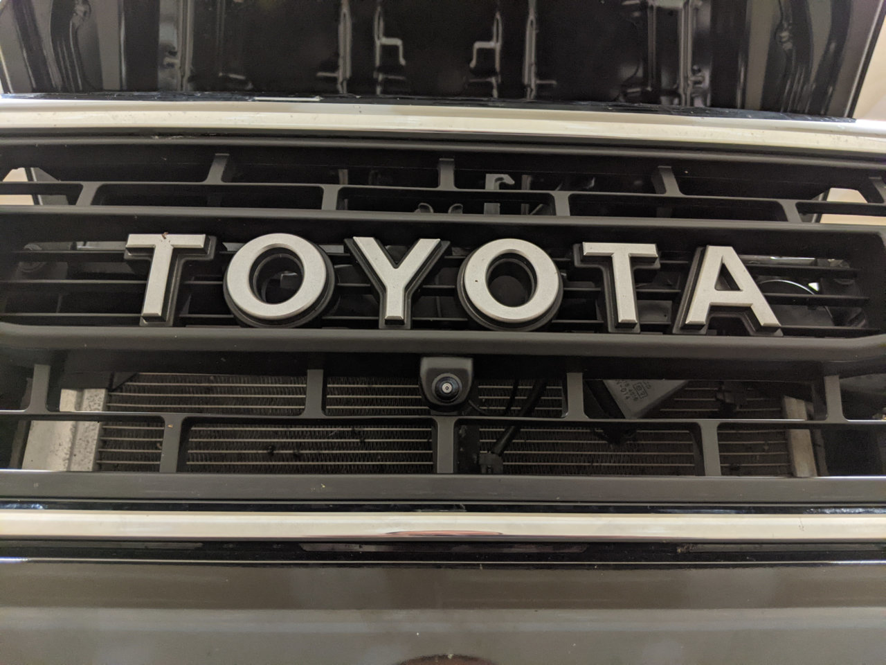

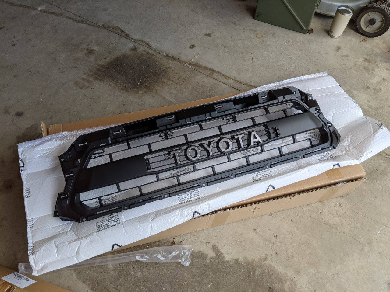

    Added the faux grille and a front camera

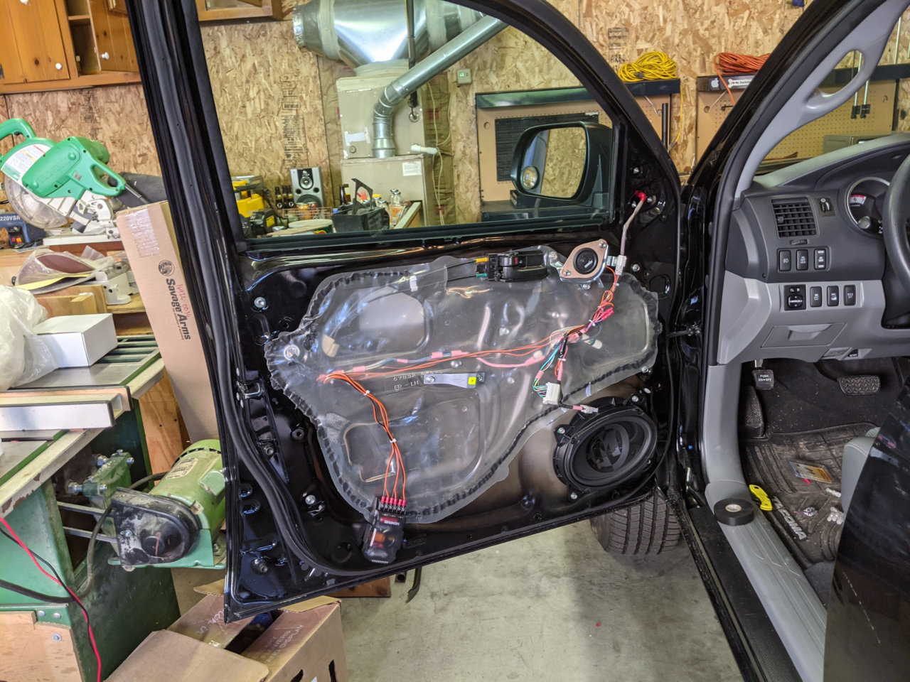

    Upgraded the speakers and added a charger

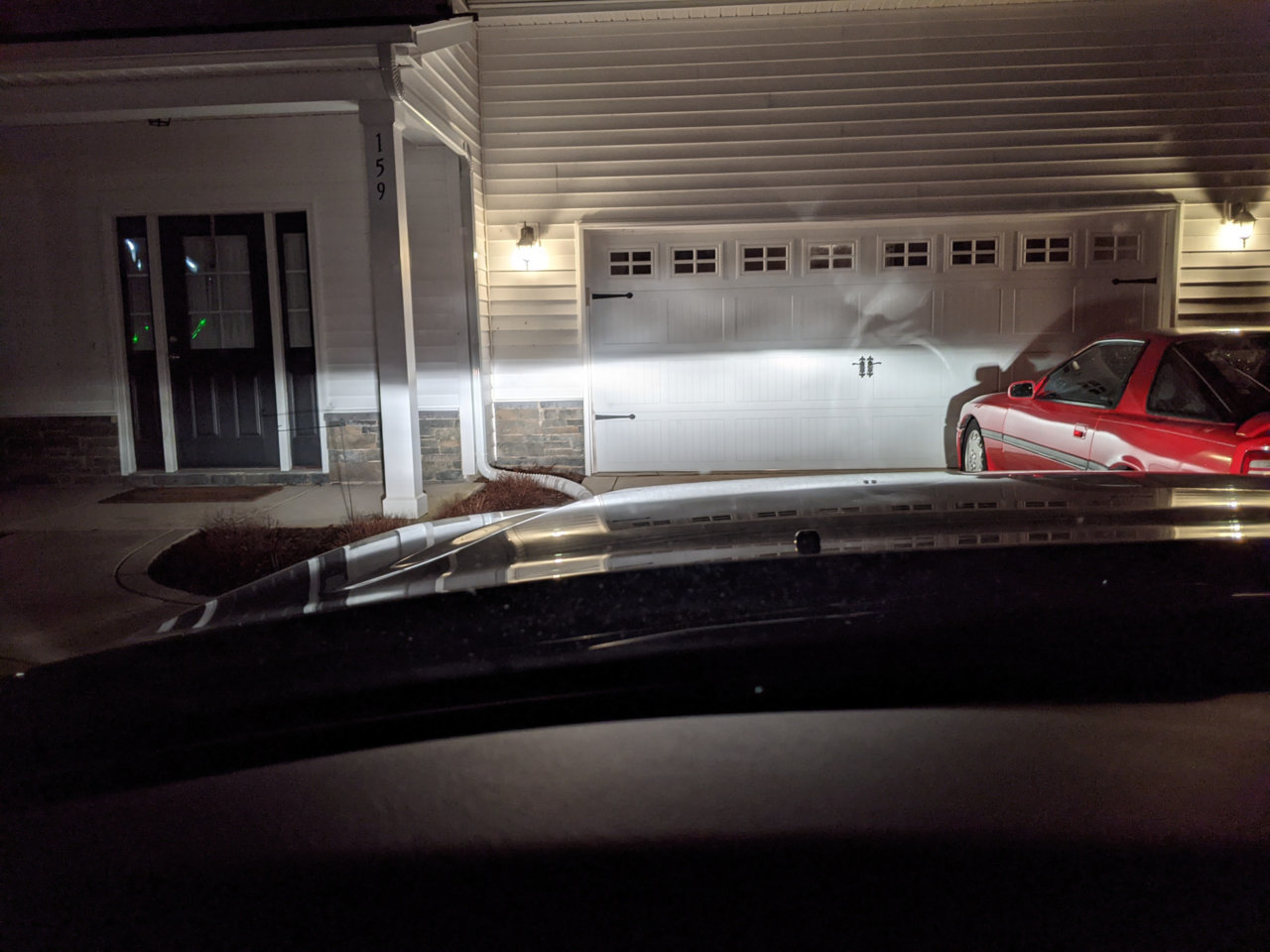

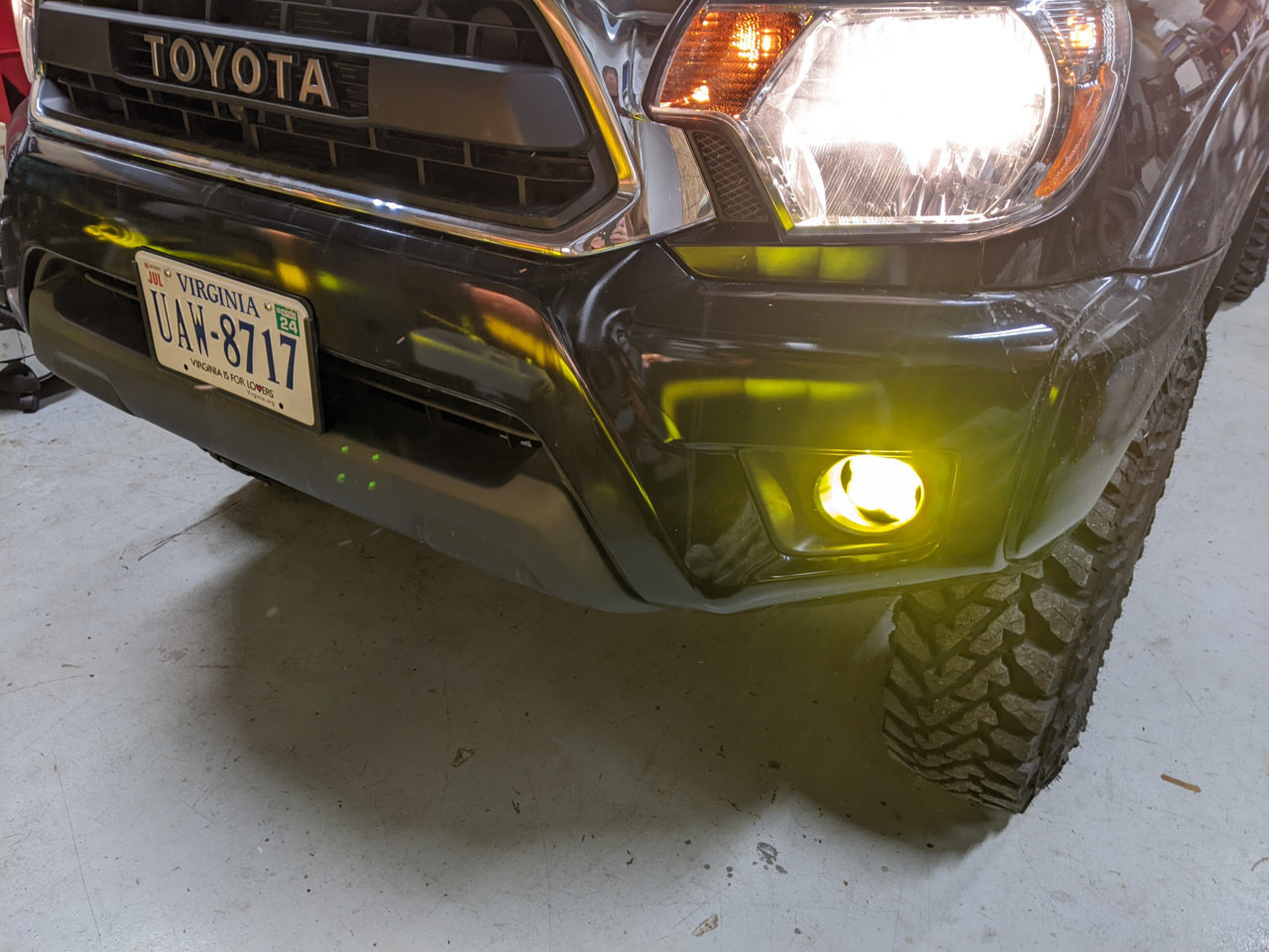

    One of the best upgrades I've done - better headlights. Tried out some Nokya golden yellow fog light bulbs to see how the color did in bad weather.

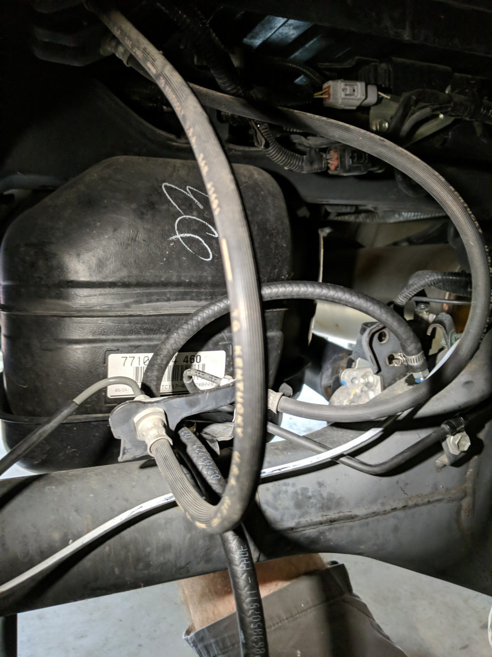

    Mods backlog - rerouted diff breather:

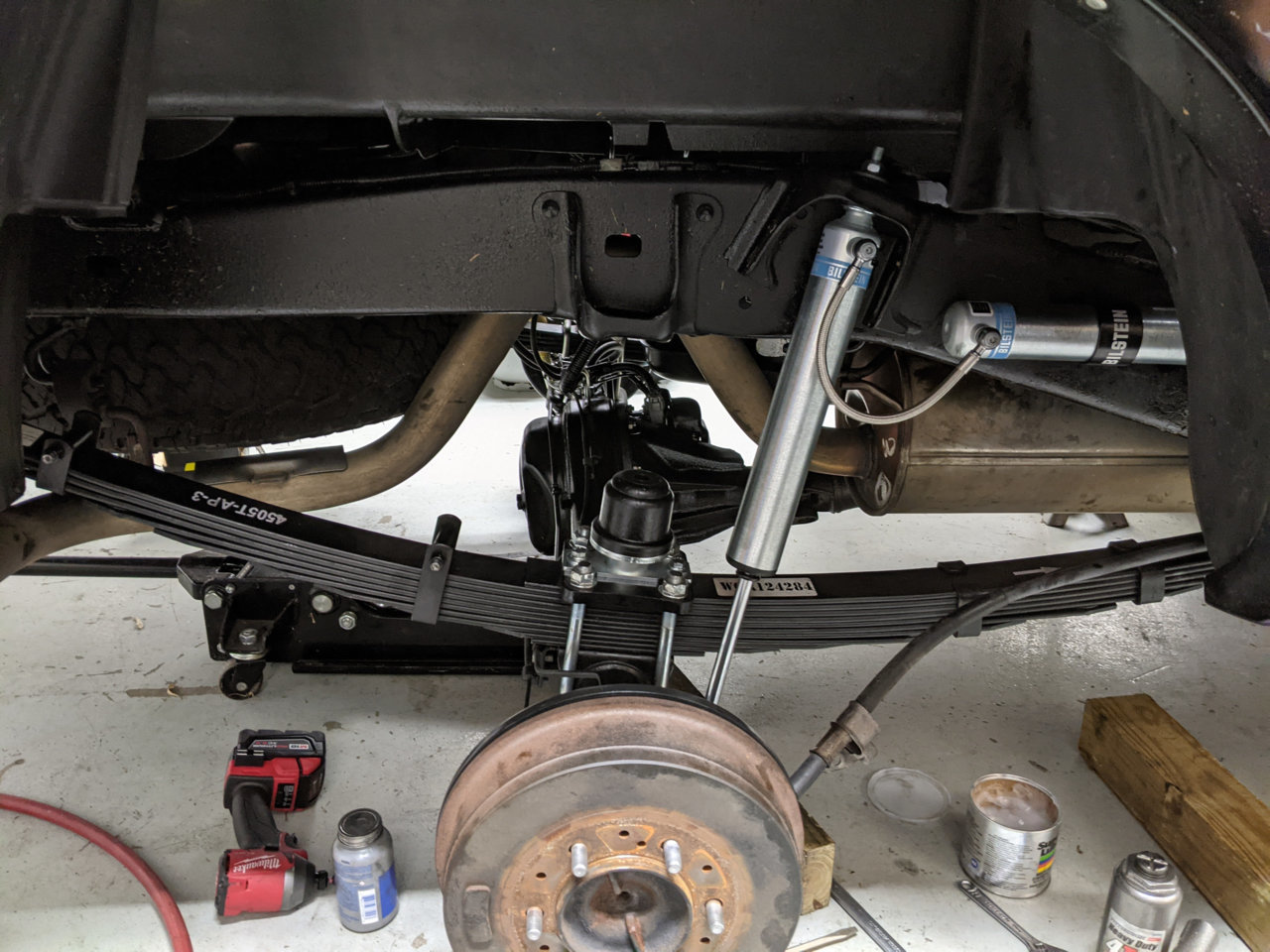

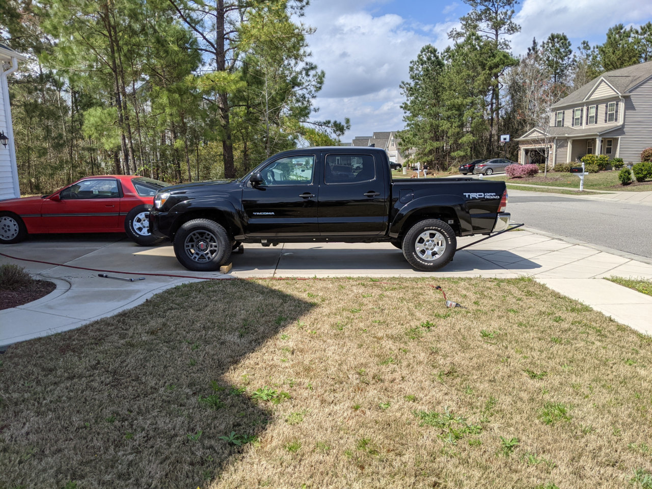

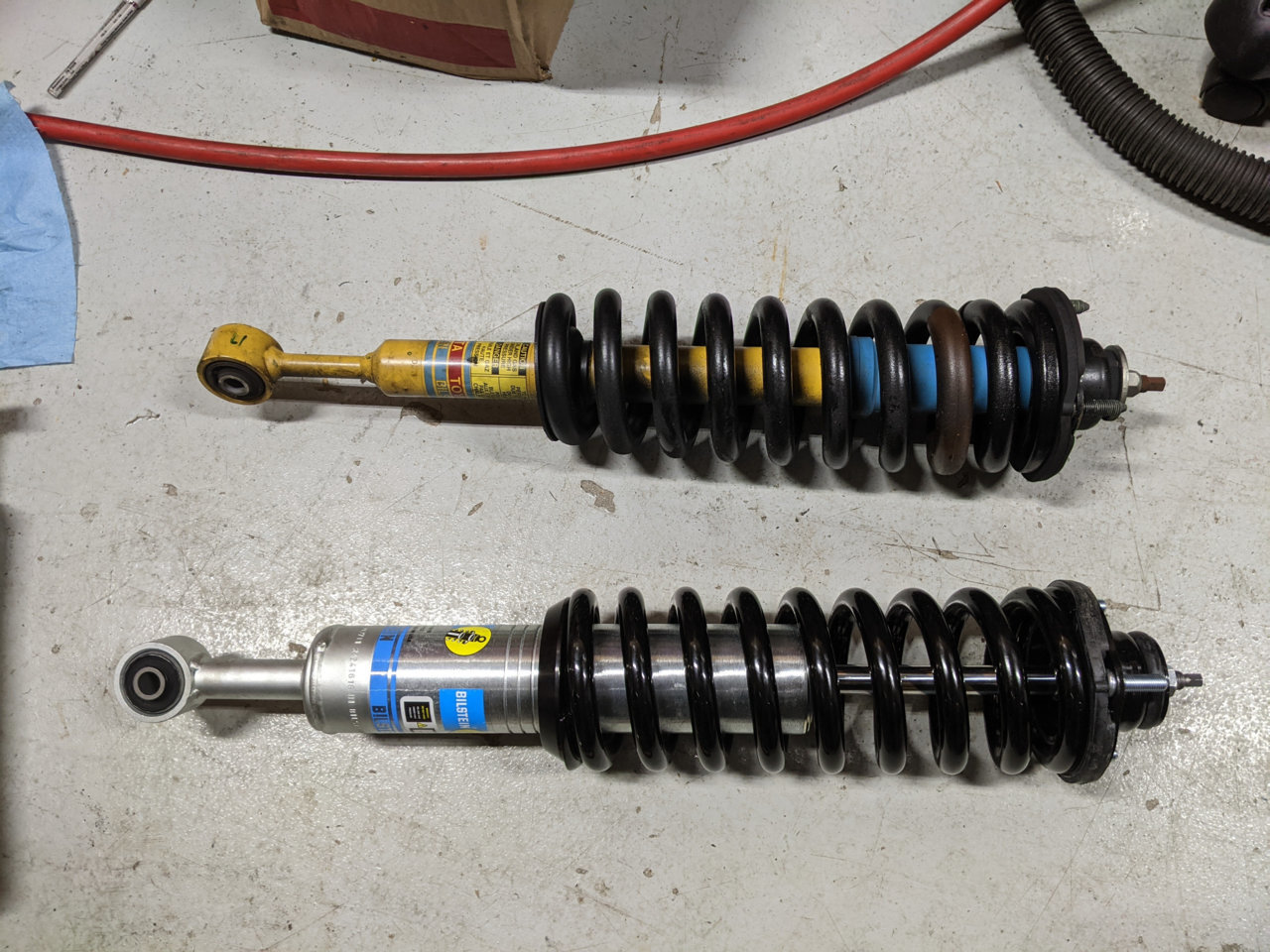

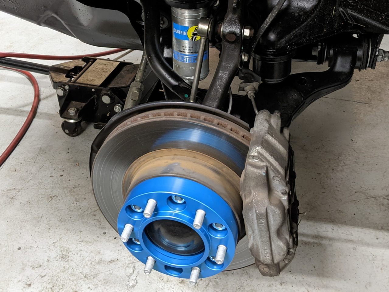

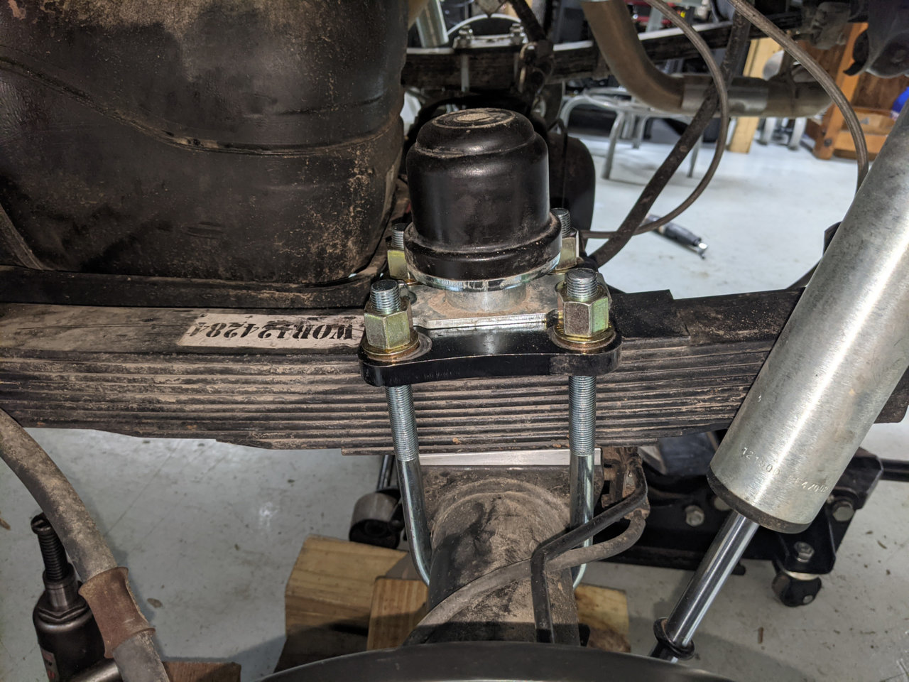

    Finally getting into the big projects. Bilstein 6112/5160s added with a U-bolt flip and better bump stops. Went up to 255/85 Yokohama Geolandars and managed to get the spare to fit once I adjusted the brackets. The new UCAs required a 1.25" spacer to clear, so all four corners got spaced out until I settle on some alternate wheels. After driving for a few miles, decided to add the 3° axle shims to take care of a slight vibration - had to add new U-bolts as I cut the ones from Wheeler's a little short.

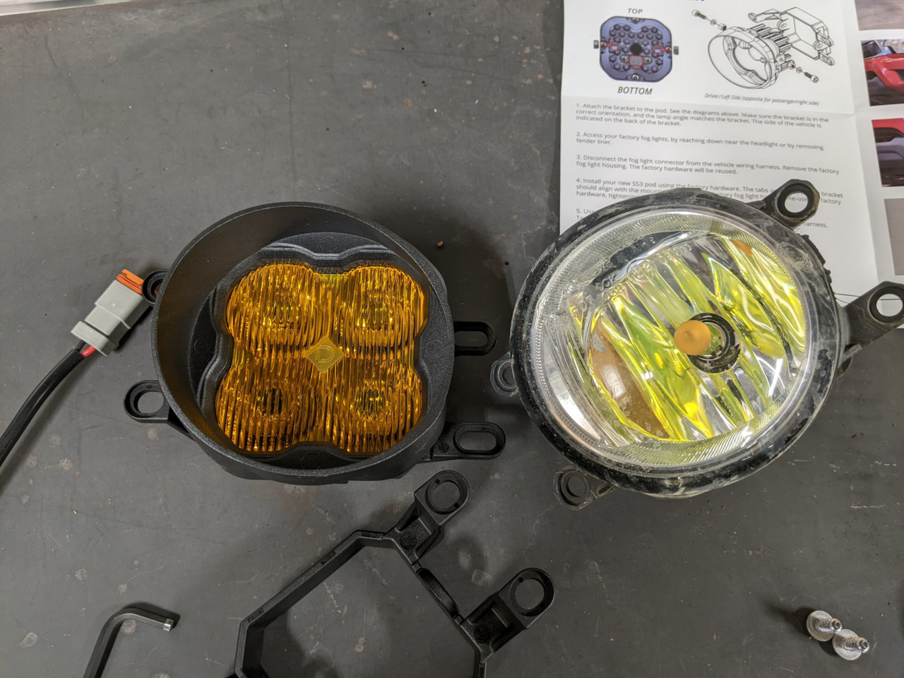

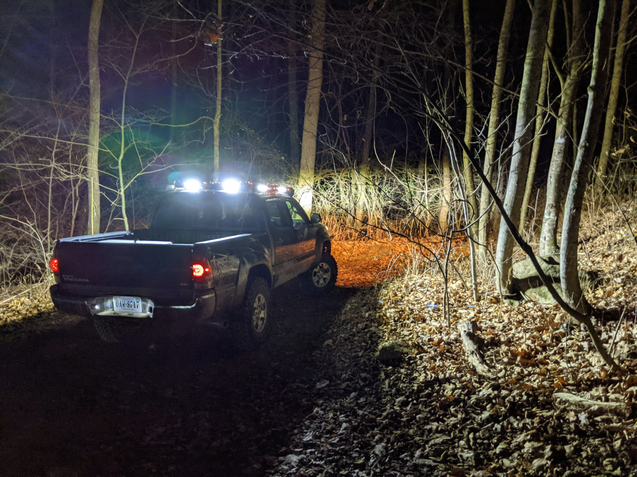

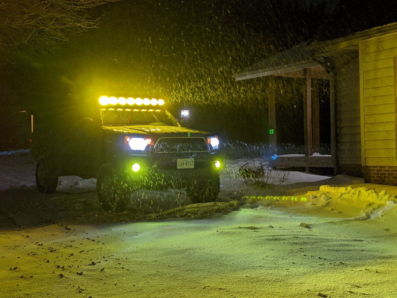

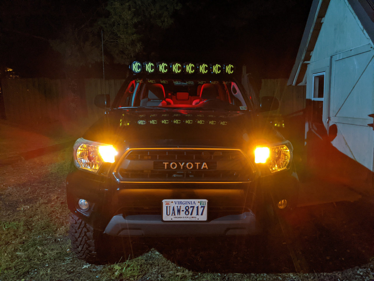

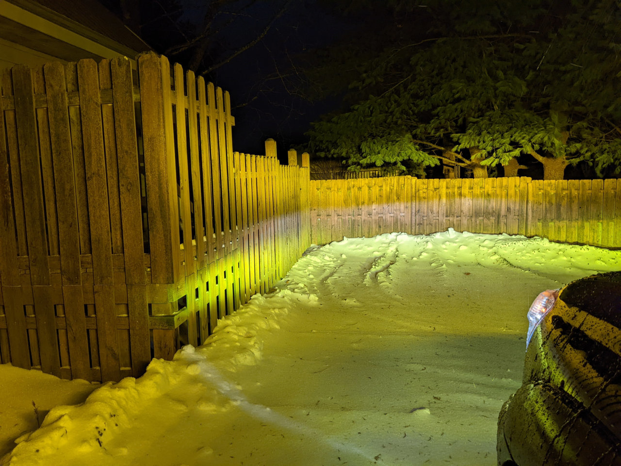

    Got some additional lighting. Very happy with the selective yellow fogs and amber covers for the KC light bar. Huge thanks to @Mr.PowerTrays for the PowerTray and @memario1214 for supporting TW members at Hotshot.
    Had to get the amber covers.
    And a few shots in the snow to show off the different color temperatures. The light quality of the Gravity Pro6 and SS3 max is phenomenal.

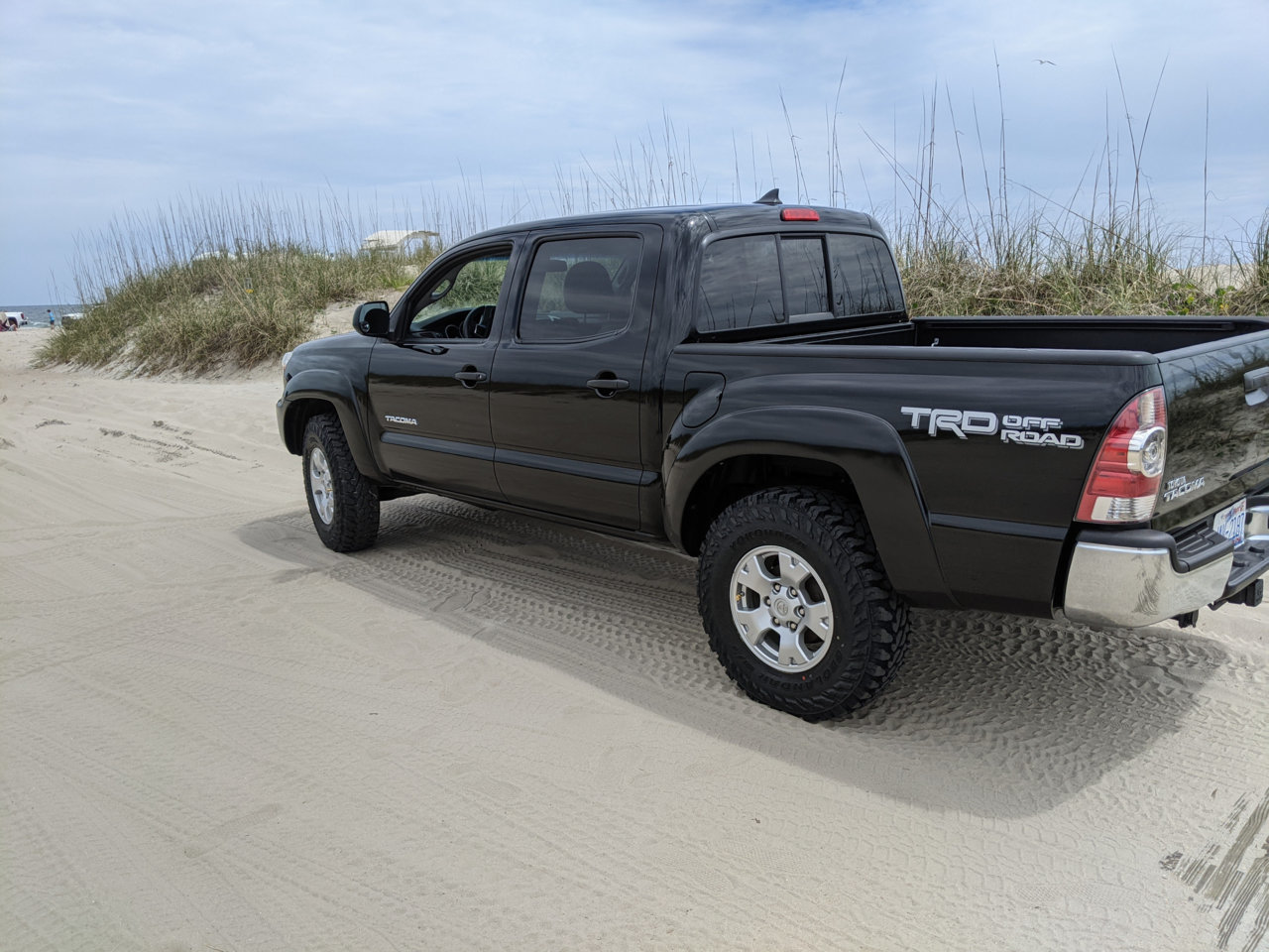

    Took a quick trip before the National Forest roads closed for the winter:

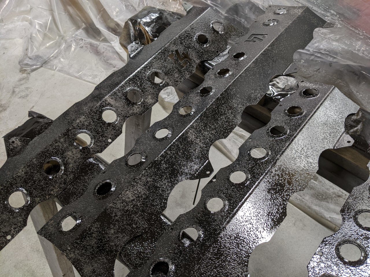

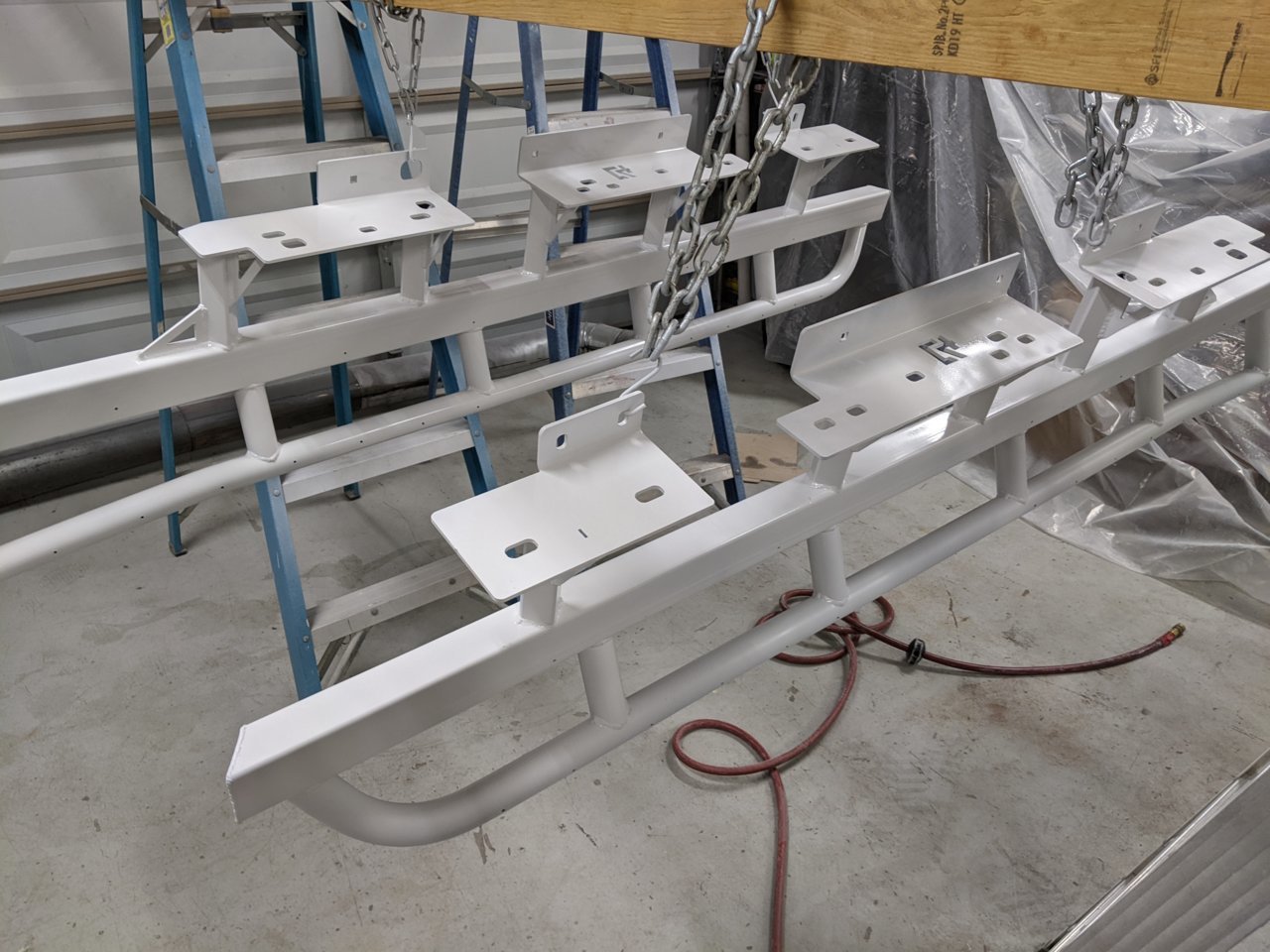

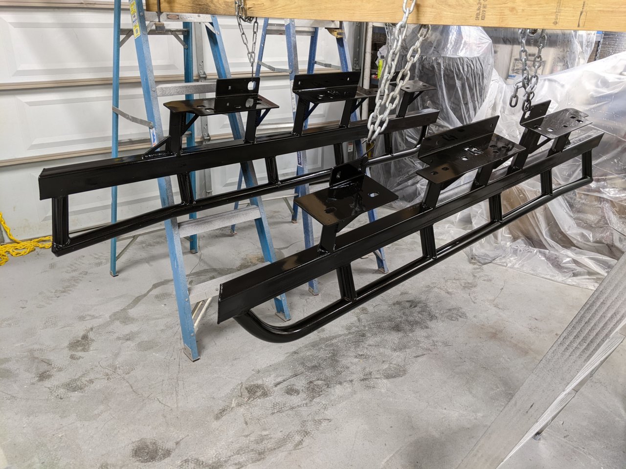

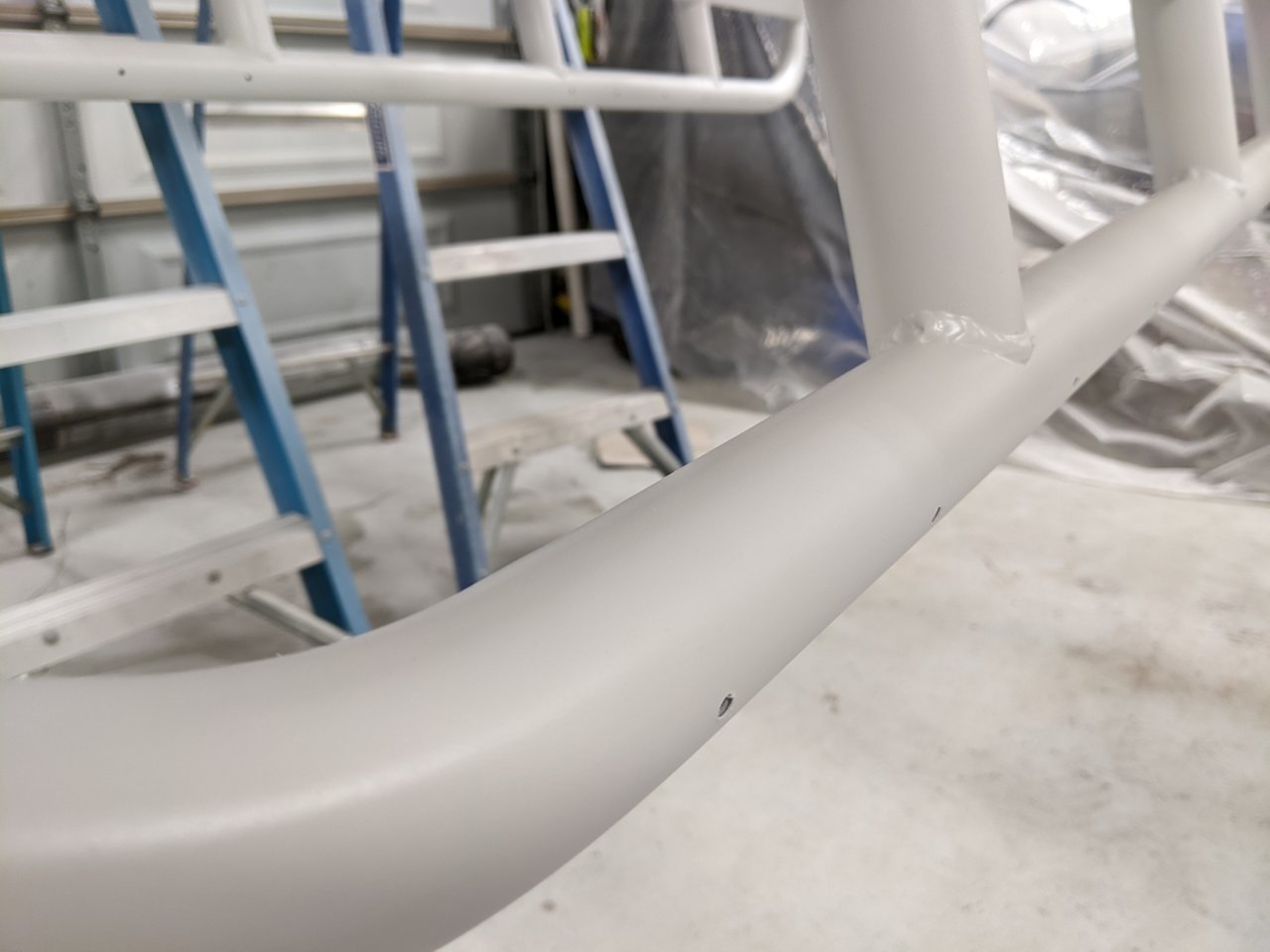

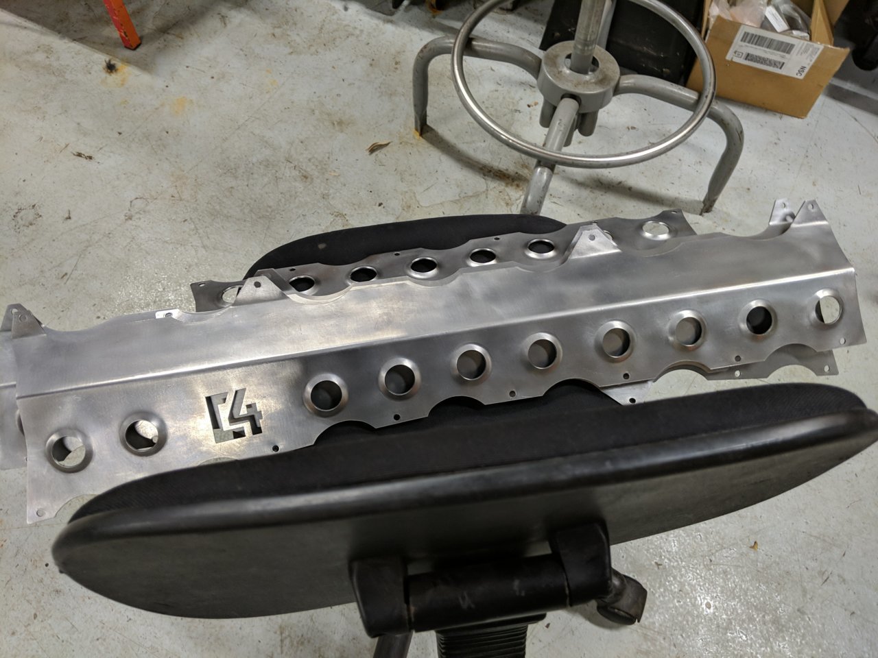

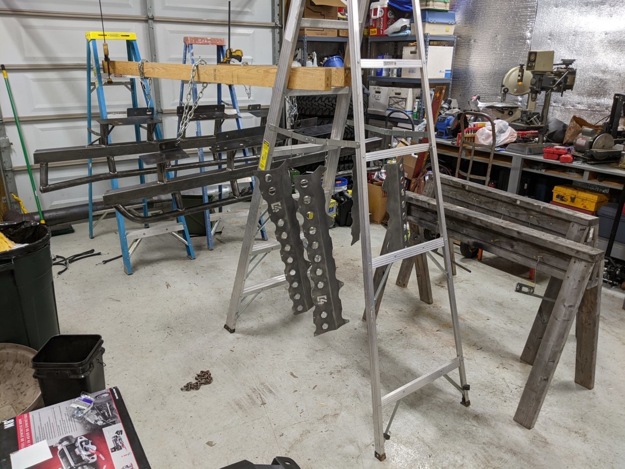

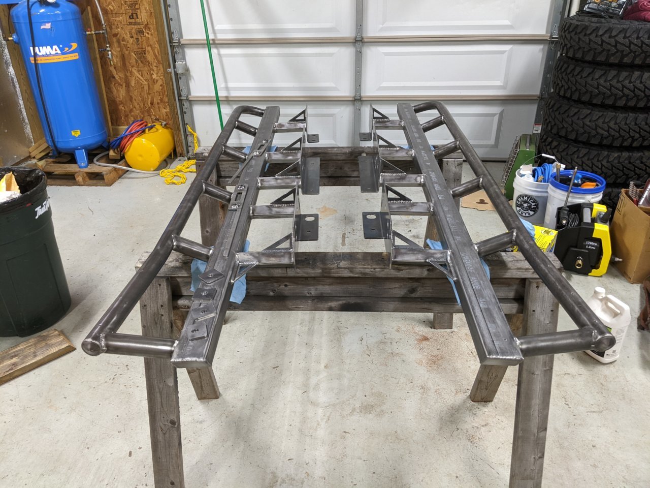

    C4 sliders prepped for painting this week. All wire brushed and wiped down.
    Hung up and ready.

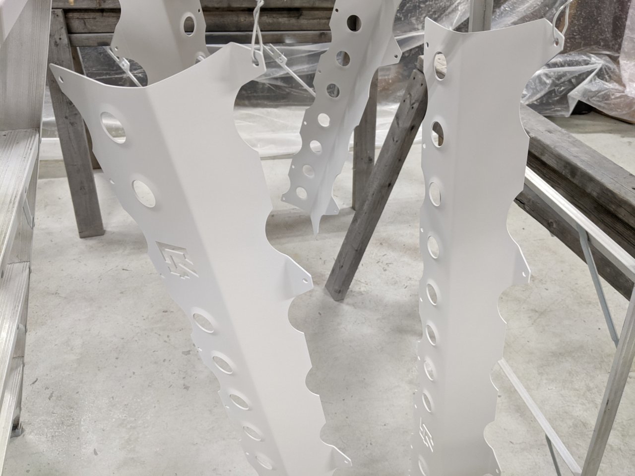

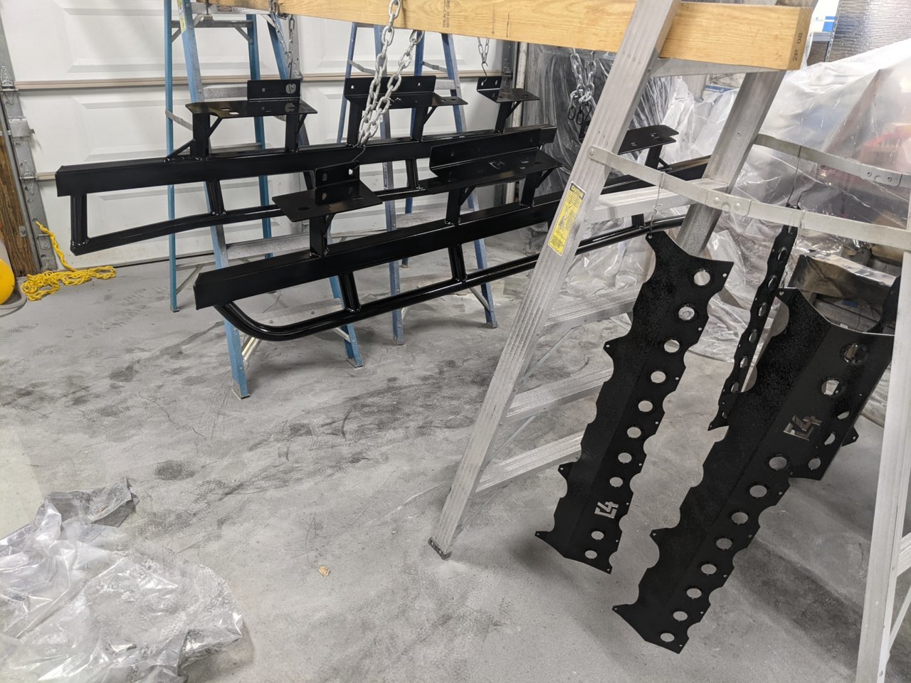

    First coat of Rustoleum Marine Coatings Topside primer. Thanks @Grumpy Jesse for the paint recommendation and nice writeup on the install.PXL-20220414-213801474_a479795868499be1731f2ffde808f37a7ffe1995.jpg
    Second coat went on smoothly after sanding.
    Now to wait for the topcoat.
    BizzyB726 likes this.
  15. Apr 15, 2022 at 8:52 AM

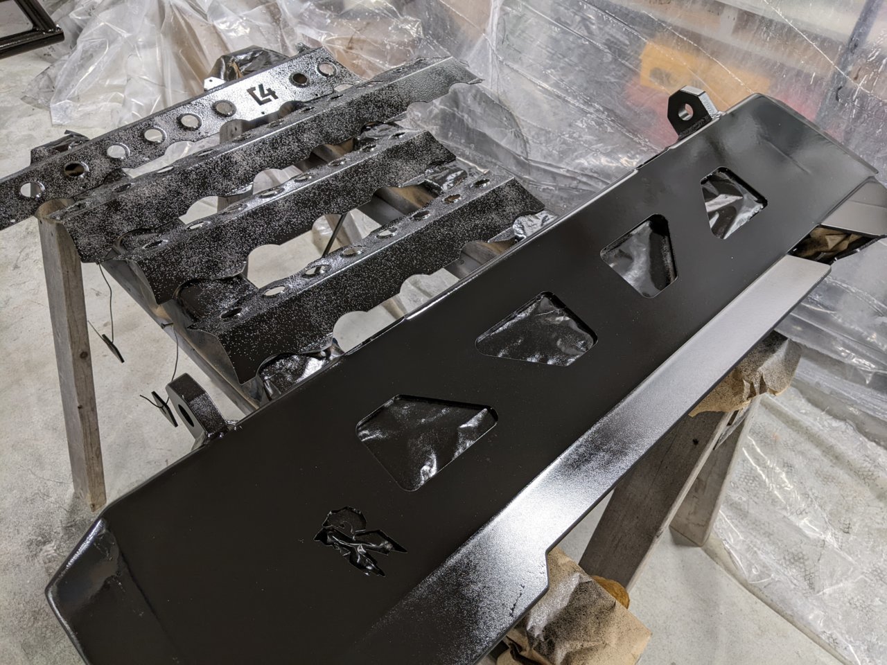

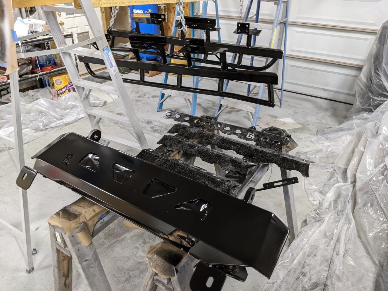

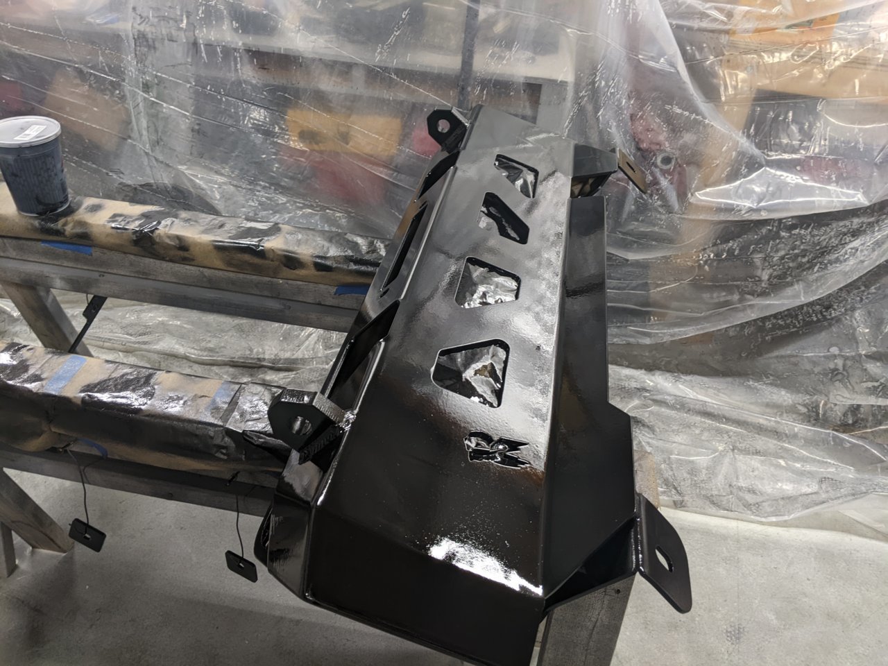

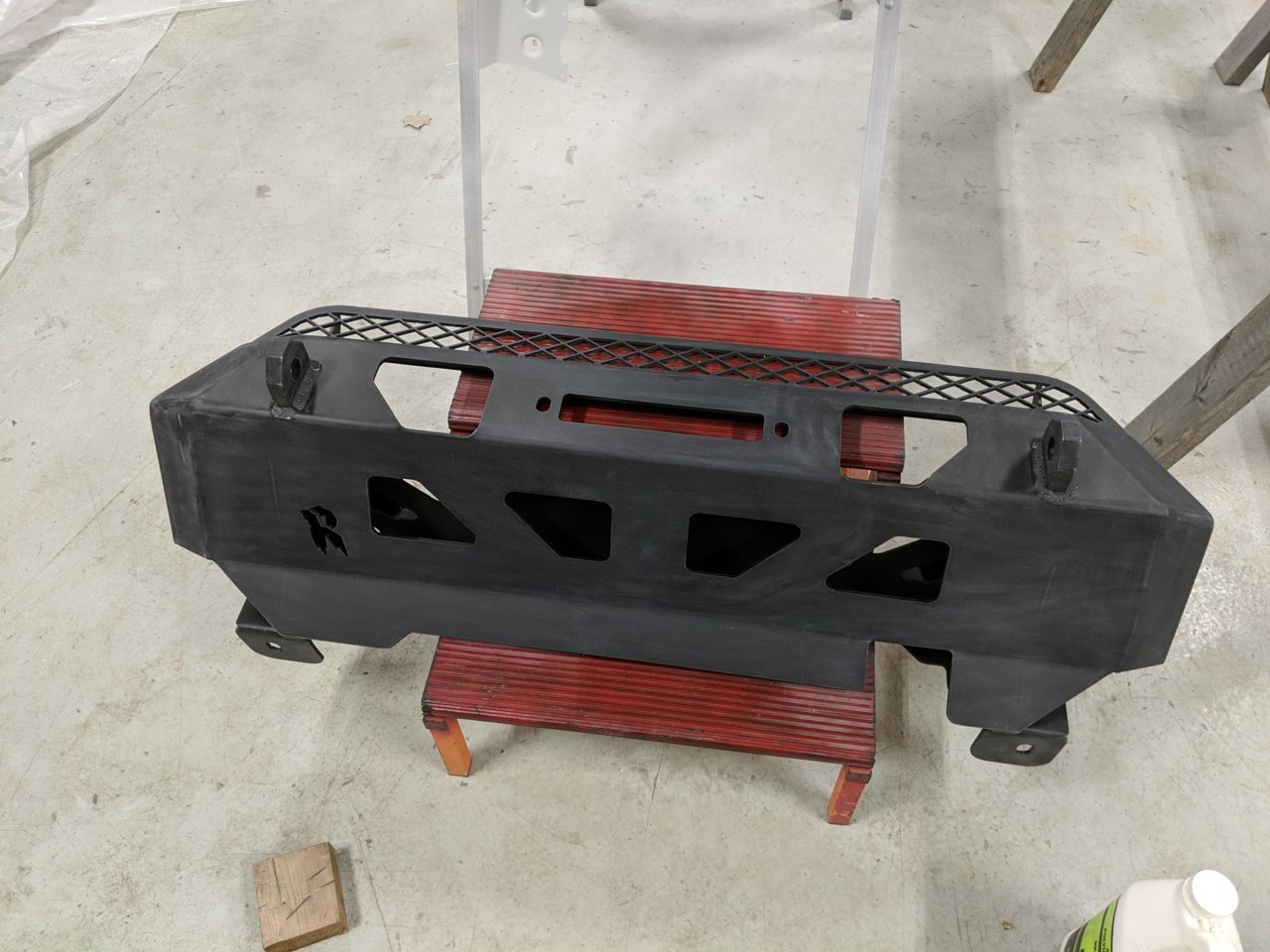

    First coat of color on tonight, decided to touch up the Relentless bumper as it had a few chips and scuffs. Decided to try the anti-slip additive on the step treads as well. Sanding and second coat to finish up, then to install it all.
  18. Apr 18, 2022 at 10:23 AM
    #18
    clip
    clip [OP] Well-Known Member
    Mar 12, 2021
    #359021
    616
    VA
    15 OR
    pinstripes. lots of pinstripes.
    Final coat on, now to wait the 3-4 days to cure prior to install. Anti-slip additive came out great on the step plates too.

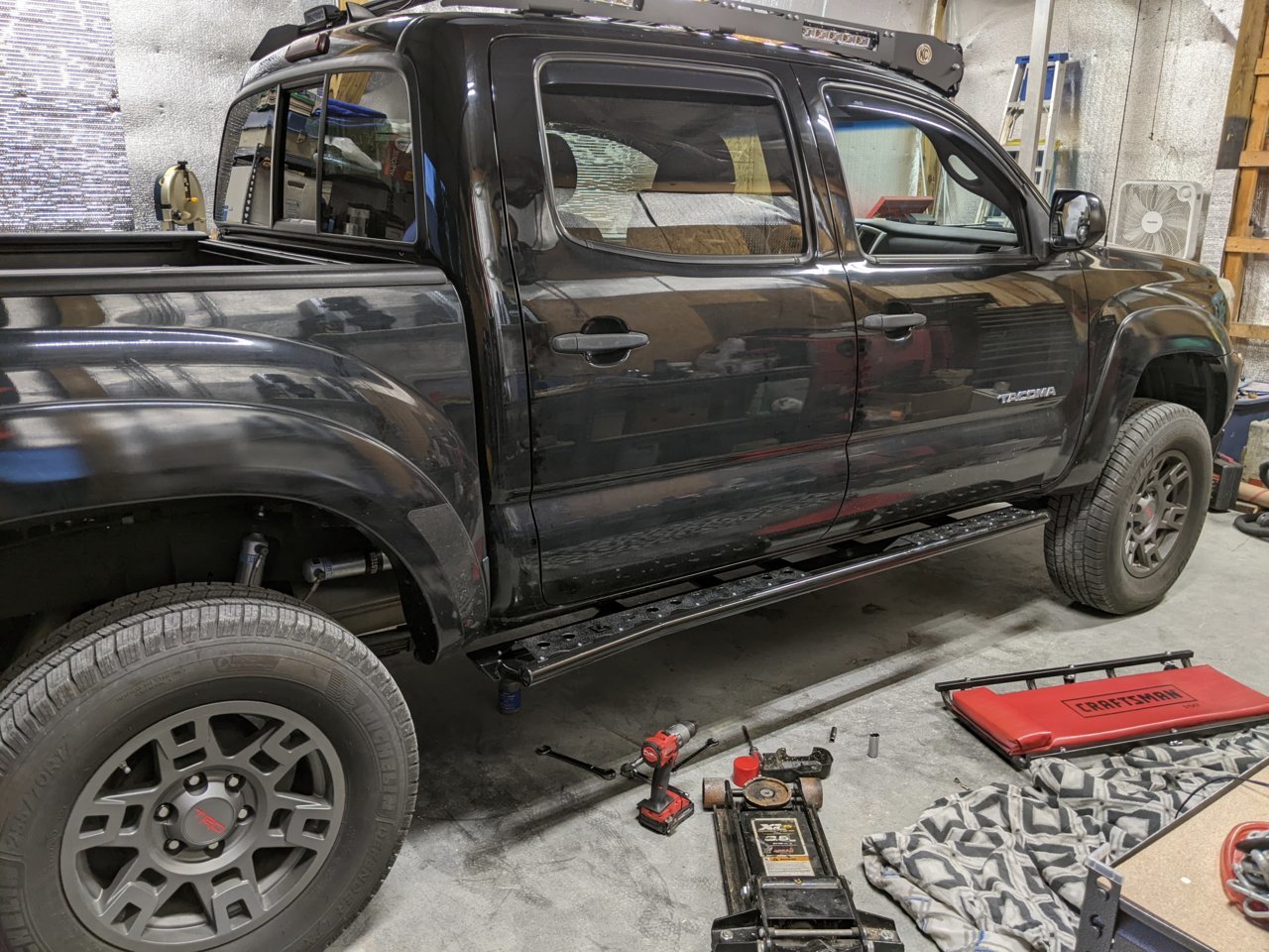

    Sliders finally mounted after a week of painting. Now to get the winch bumper on.
