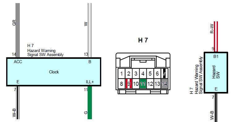

    Does anybody know how to disable the digital clock dimmer on a 2nd gen Tacoma. I did the mod on the overhead compass but I can’t find anywhere how to do the clock. When I turn on my headlights I don’t want the clock to dim.

    De-pin and insulate or cut n tape pin 11

    Oh my gosh it worked thank you so much!!! I can’t believe it was so hard to find. Thanks for the easy diagram to follow have a good day/night
