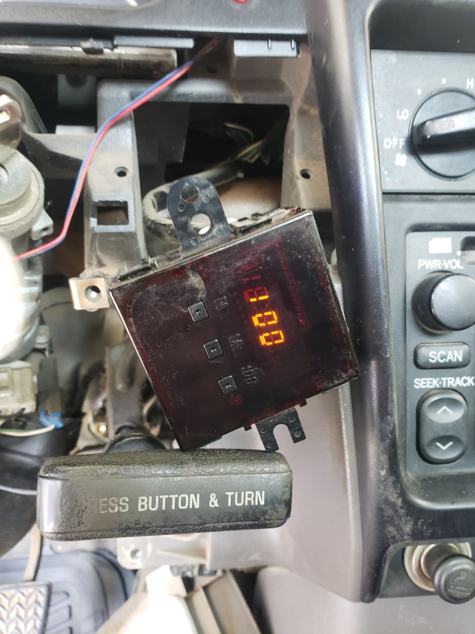

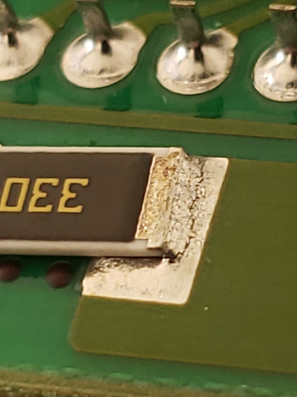

  5. Mar 12, 2020 at 12:33 PM
    #25
    rackomint
    rackomint Well-Known Member
    Feb 22, 2020
    #320038
    64
    Anna TX
    2001 5-spd SR5 3.7L V6 4WD
    This.
    I had a crack on one of the resistors solder point (pictured) and I resoldered all 3 resistors.
    Works like a charm now.
