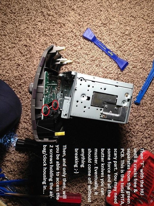

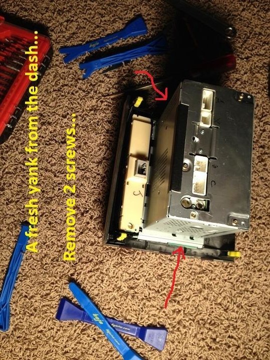

    Bone stock, except for my TaoTronics HD back-up camera & KW-NT810HDT audio HU...
    The HU must come off before the air-bag/clock mounting can be separated. The reason? There are 2 screws (circled in red in the second pic) that are not accessible with the HU in place.
