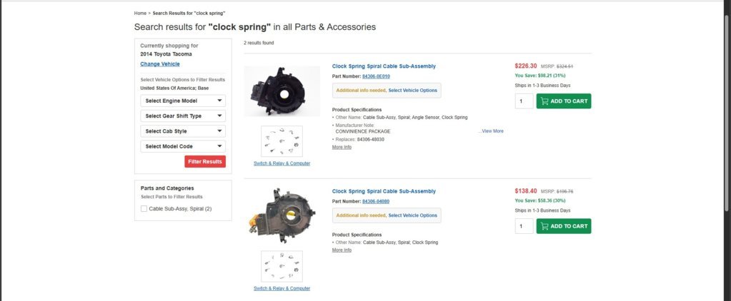

    Hi folks. I've been searching the forums here and have not found an answer. I've got a '14 Tacoma with a failing clockspring. Mostly the horn isn't working. I reached out to my local Toyota dealer and they took the VIN and crossed it to a PN 84306 0E010
    Here lies the problem. The part number the dealer is giving me is a clockspring for a non cruise control equipped truck. Mine has cruise. I have looked on parts geek, ebay, Amazon and rockauto and they all list one for the non cruise equipped ones.
    I went online to a couple of toyota parts sellers, and even then using the VIN of my truck I'm getting the incorrect one.
    Does anybody have the correct part number so I can buy one off Amazon? All I'm finding are ones for the trucks equipped with audio controls on the wheel (which mine has) but without cruise control.

    According to several sources, it looks like a clockspring for a 2014 with convenience package (aka cruise, audio) is indeed PN 84306-0E010. What leads you to believe it's not? It does list the part number that was superseded, too. (84306-48030) as Toyota did have a TSB on this part. Your truck may still be eligible for it and the dealer should have told you. You can run your VIN at Toyota.com to see.

    Thank you for the feedback! So this is simply a case of my not fully doing my research and not understanding what I was looking at.
    Here is the issue I found. When I took that part number the dealer gave me I looked up images of the clockspring assembly that are commonly being sold. I Removed the steering wheel, and the clockspring assembly off the truck. To my dismay the assembly that I removed had three plugs while the supplied replacement had two. This led to my further searching whereas I saw references to W/O cruise in the parts description. After reading your guys posts, I contacted the parts guy at my local dealer. I've had two Tacoma trucks now, and this parts guy is really really sharp, and is always spot on.
    After speaking to him, and doing some more reading online I realized the issue was that I wasn't understanding the steering sensor that snaps into the back of the clockspring is a separate part altogether. I had assumed that it came with the new clockspring assembly. Well we all know about assumptions, right? Well I had assumed wrong. Simply put that is the correct part number, and you have to carefully have to swap out that steering sensor to your replacement clock spring.
