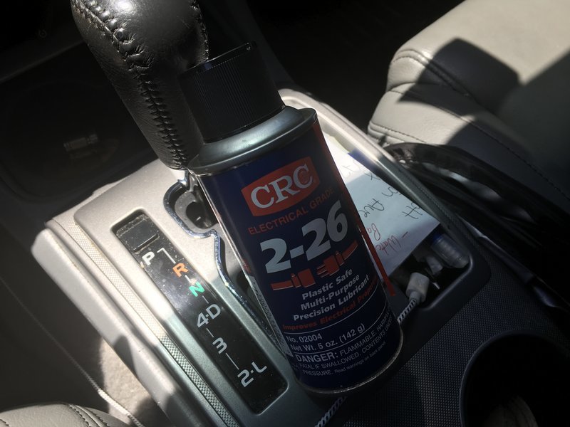

    2011 Tacoma
    OK. After driving around for over a year with no horn (that all that was wrong with mine) and not wanting to fork over $200+ for a new OEM clockspring I was discussing with a friend and he suggested this stuff. IT WORKED! I now have a horn again and no lights (none were ever illuminated in my case). Here's what I did. I took the clockspring off just like the video posted earlier and took the clockspring to my desk. I took 3-4 flat screw drivers to pry apart the clips on the clockspring and sprayed the insides really well. I also sprayed both male and female electrical connections to the clockspring. I am beyond elated. I'm hoping it will last, otherwise at this point I'm prepared to bite the bullet and install an OEM replacement myself since this will be my sons truck in a year and a half. Here's a photo of the stuff. Good luck to all. This forum has saved me more $$ over the years. Keep up the great work!IMG_0324.jpg
    Kabloona, DrFunker and Brian007Taco like this.

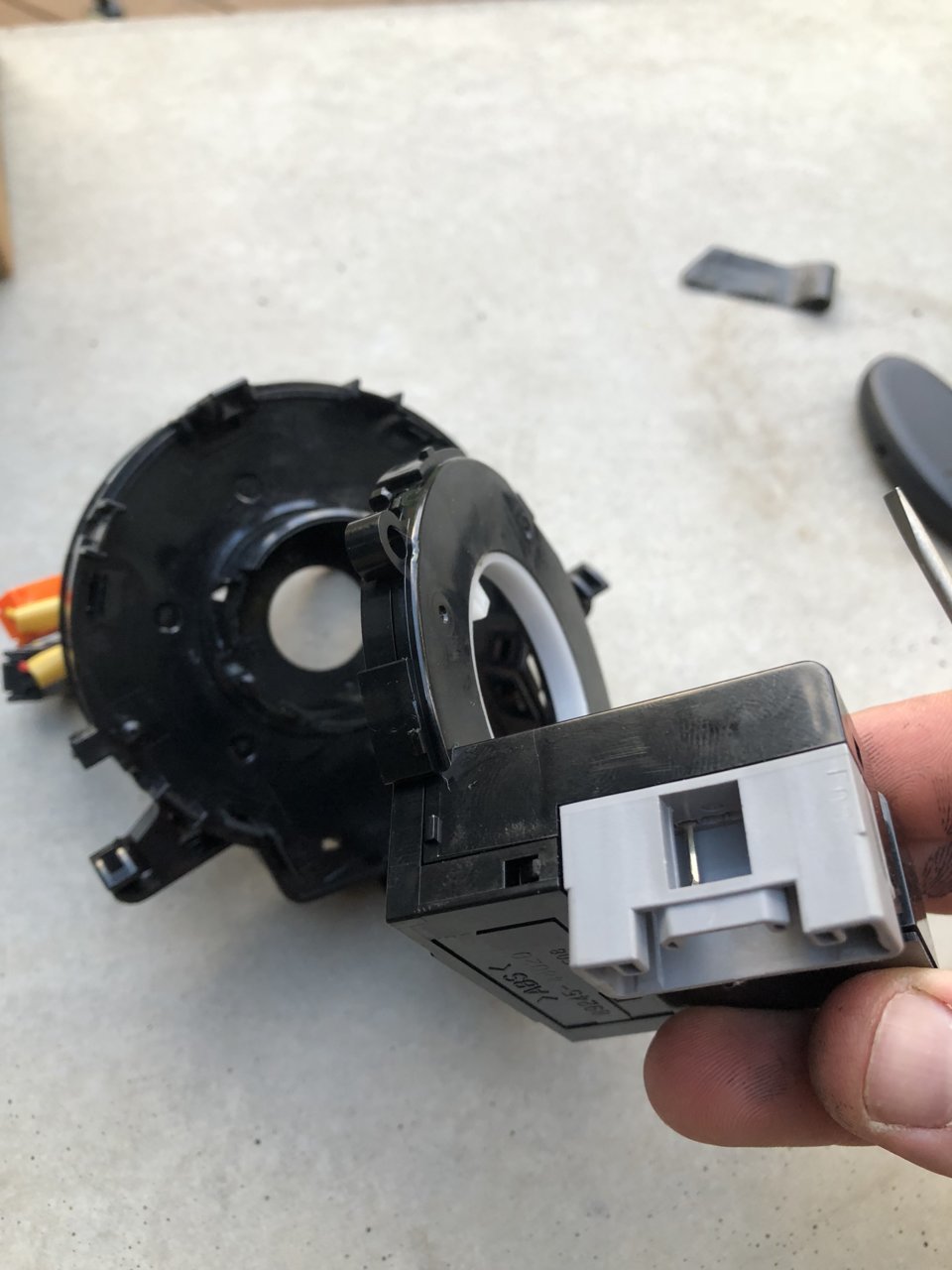

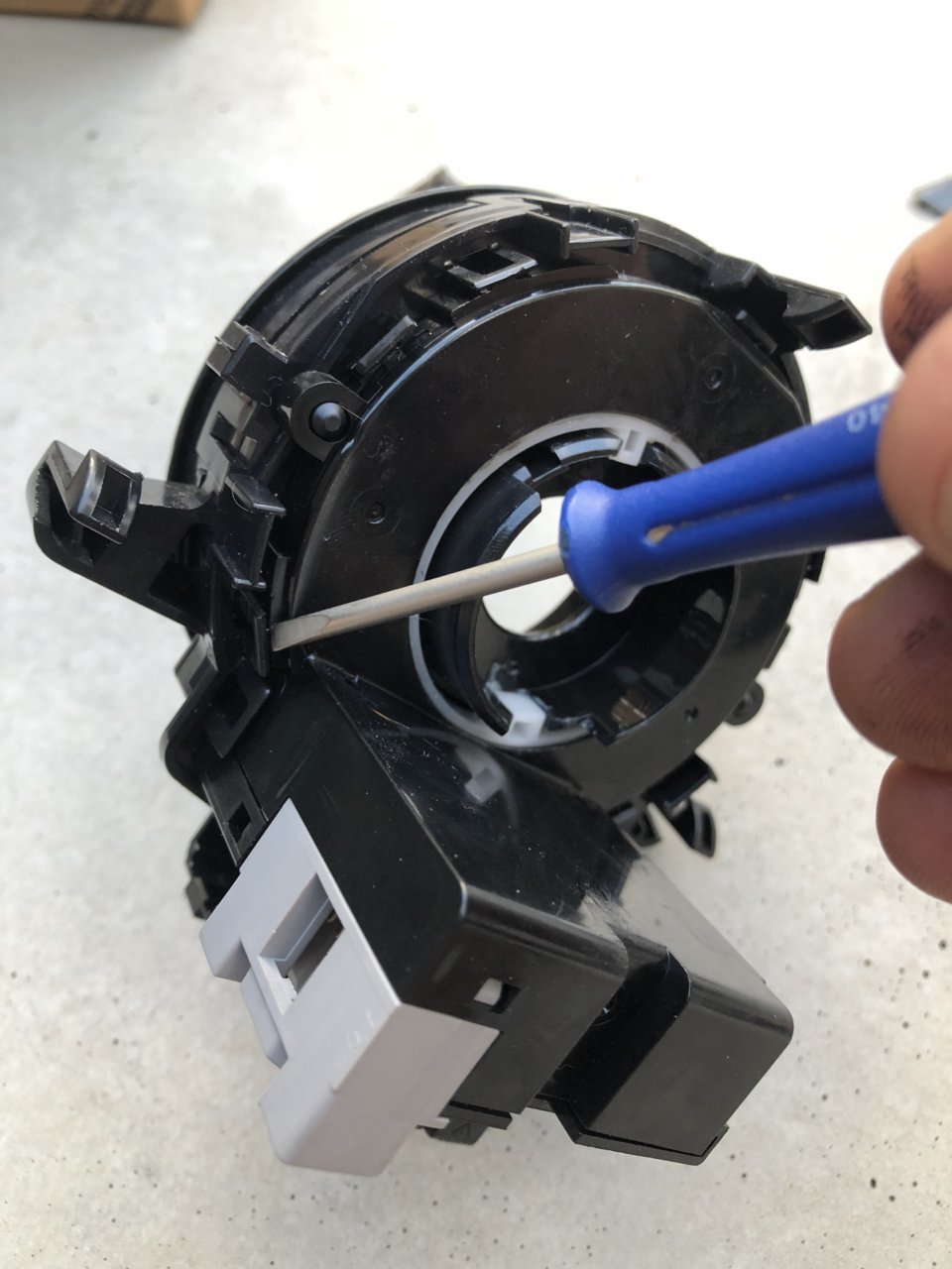

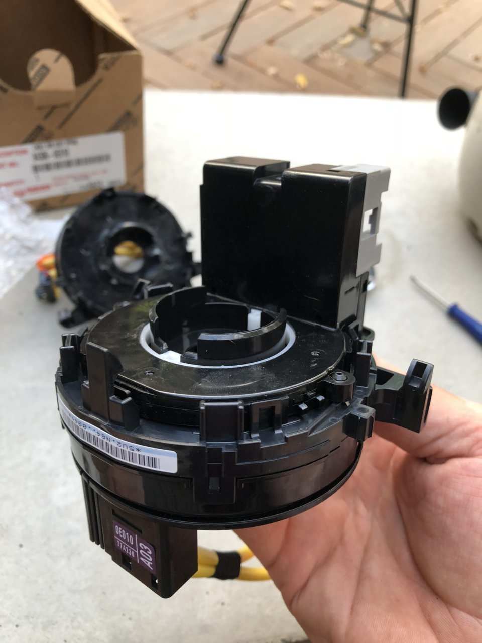

  16. Oct 2, 2018 at 5:45 PM
    #56
    edavidso
    edavidso Well-Known Member
    Dec 13, 2010
    #47652
    49
    Erik
    Colorado
    1997 SR5 3.4L 4x4 & 2011 TRD OR DC SB 6Spd 4x
    3" Toytec Lift, Smitty Roll Bar, Push Bar, Nerf Bars, 7 KC 150W, Viper alarm w/ Remote Start, Pioneer CD/MP3, 6 disc changer, Infiniti Speakers, Rhino Lining.
    Sorry to resurrect an old thread but thought I’d post the fix for those with a 2011 Tacoma who were having issues with the correct part number. I too have the full options steering wheel (radio controls, Bluetooth phone, and cruise) and had the original cable go out (horn not working). It was part number 84306-04020. When it comes out there are two black ports and a gray port. The piece with the gray port is removable.
    This piece is the steering angle sensor for the ECS. It is interchangeable with the new spiral cable part 84306-0E010.
    So simply remove the gray plug from the old spiral cable. Install on the new cable and you should be good to go.
    Everything works in my steering wheel after replacing this way.
    daytrader2 likes this.

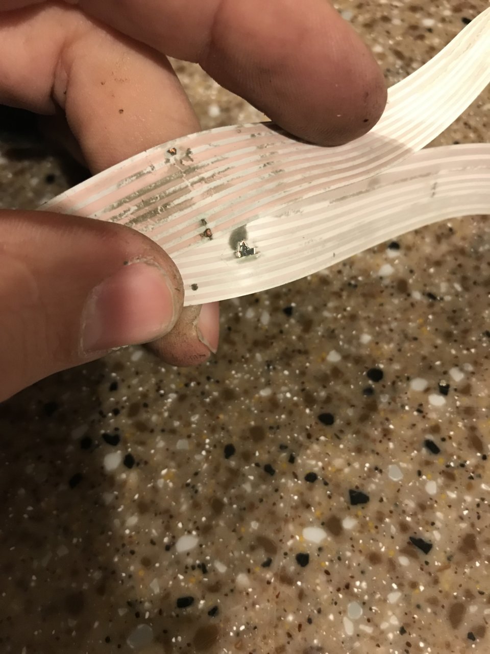

  19. Jan 8, 2019 at 4:58 PM
    #59
    Barrett5991
    Barrett5991 Well-Known Member
    Dec 24, 2018
    #276828
    81
    Joe
    Just changed mine out, no cruise control. Bought an OEM one off eBay for $116 (or at least it came new in an OEM box.) Here’s a pic of what caused the cruise to go out.upload_2019-1-8_17-58-24.jpg
    #59
    Brian007Taco likes this.
  20. Jan 9, 2019 at 6:18 AM
    #60
    Brian007Taco
    Brian007Taco 007Taco
    May 16, 2012
    #78964
    19,922
    If you ask. You don't know me very well!
    Mesa, AZ to NM to OK to UT back to Mesa
    2012 Red TRD OR 4x4 DCSB (aka Clifford the Big Red Truck)
    12 OR DCSB 4x4 265/75/16 Goodyear Ultra Terrain wrapped on MB352's. OME 886's w/5100's front and back, and Dakars. Derped Emblems. KM Fab sliders, Mobtown Front and back bumpers w/tire gate, KM Fab Bed Rack, Bestop Supertop, Matt Gecko bed lights. Tree Smashed Taco 06 OR AC Prerunner! OME 885 with 5100's in front, TSB and AAL with 5125's in back. 30" light bar in the valance.
    Wow, you scored if it really is OEM. Those are $300+ from the dealer.
    #60
