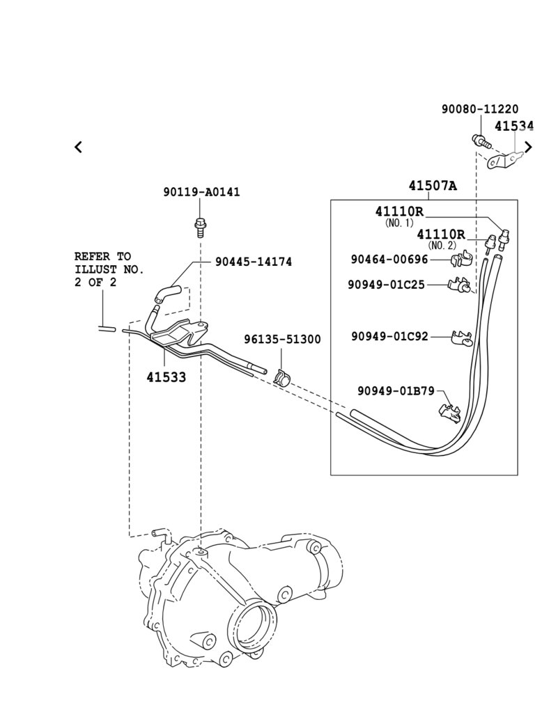

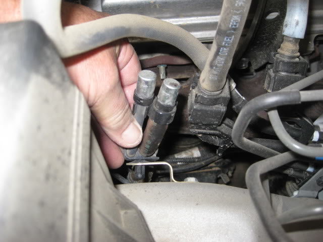

    Hey I have 2004 V6 3.4L 4WD TRD Off-Road. Looks like the front diff breather spewed some oil out of it and it's now clogged up. I was going to replace it but wanted to make sure I replace the right part.
    I know it's one of the two (or both) valves in the photos below
    My question is are those both breathers for the front diff if not what are they breathers for? They both need replaced. The one of the left spewed oil and is sealed shut. The one on the right has some play but not much (due to the residual oil from the one one on the left splashing onto it).
    Thanks all!

    Pretty sure the other one is for the front ADD actuator breather

    Probably my inexperience here but what does ADD stand for? Not sure if it matters - found a parts diagram looks like they are same part (41110R):

    Automatic Disconnecting Differential.

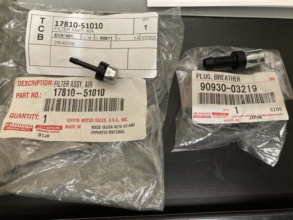

    I'm having the same problem as you. Thought I'd let you know that those two breather plugs are not the same part. If you pull them off, you'll see that the nipples are a different size in order to fit in the different diameter hoses. You want part 90930-03136 for the larger hose, which goes to the actual front differential.
    I'm trying to find out the part number for the smaller one, so that I can replace both. My saga is here:
    https://www.tacomaworld.com/threads/another-leaking-front-differential-breather.851162/

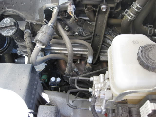

    Cross-posting a very helpful pic from another post entered earlier today. I have added it to my "obscure parts list" I have been adding to over the years. Trying to confirm these are the correct parts for a 1st or 2nd Gen Tacoma or both.

    Man, both of those parts sure do look exactly like what I have on my truck, but they both show up as incompatible on all of the parts sites. For my model, the websites refer me back to part number 90930-03136 for the larger diameter one, but I'm still coming up empty handed for the smaller one.

    This is an interesting (good) post. It's starting to look like maybe these two parts should be treated as/like a scheduled maintenance item item, and checked on a regular basis, especially since some can start throwing diff fluid without any warning. I have the two vents like this on my 2nd gen. I went out an checked them and they are moving free, but they do appear to be original and have 134,000 miles on them and almost 12 years.
