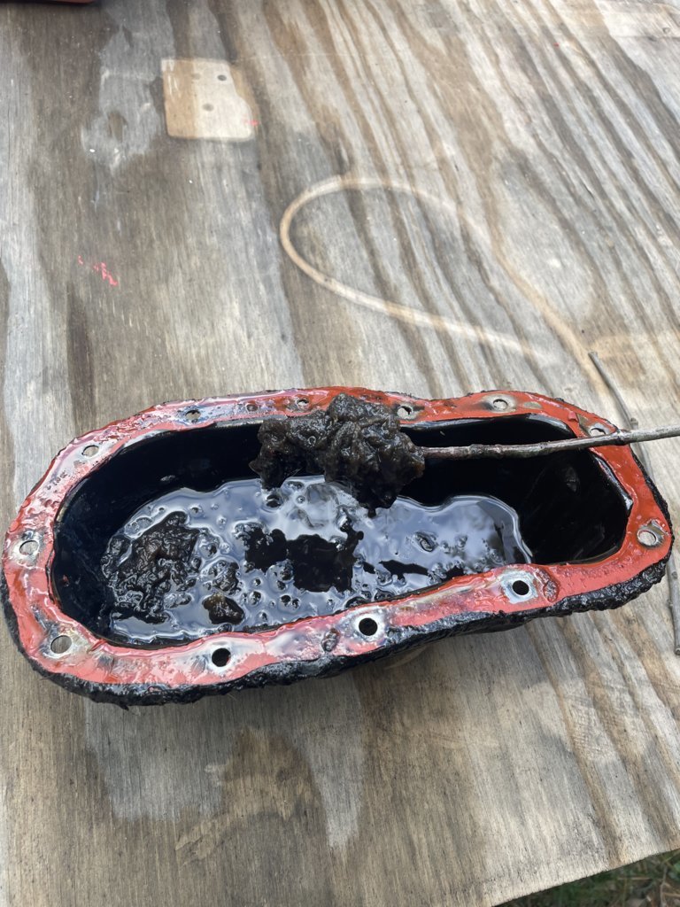

    Well, after looking through the forums for an answer to my low oil pressure issues with no avail, I finally decided to take the lower oil pan off...
    No idea there was sludge/stop leak build up. When I pulled the heads months ago it was spotless inside.
    Never trust that your previous owner did their maintenance...:(

    HOLY FUCK DUDE!
    This cannot be said enough!
    I am shocked you had any oil pressure at all.
    I'm wondering how much shit is suck in the oil channels and under the valve cover(s).

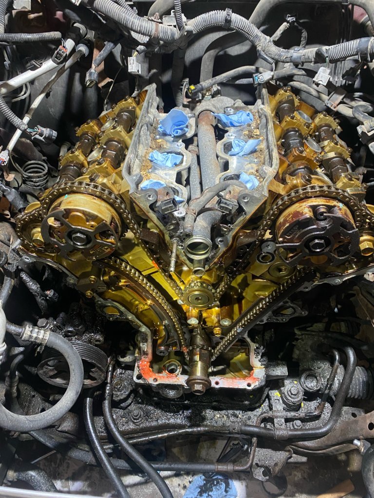

    I’m definitely worried about the oil channels for sure!
    This is how it looked when I did head gaskets in January. I would’ve never guessed it was that bad below. It’s crazy the oil pressure light came on so randomly! I’ve been driving it for months with no issues although I know it was an abused work truck but still!!
