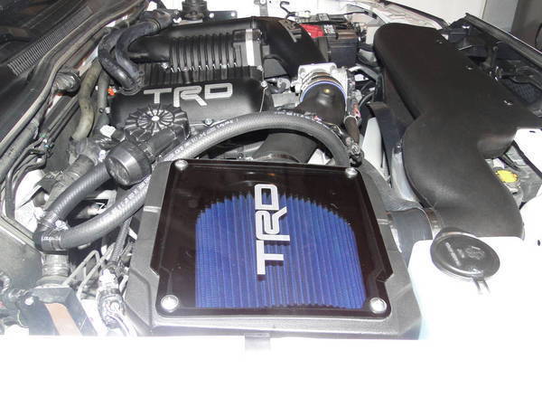

    I ordered the one with the ram air scoop, here is the final product

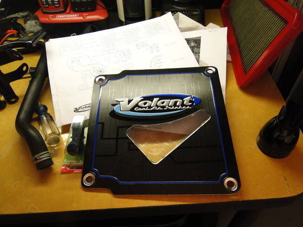

    You'll notice the nice TRD lid on the CAI, thank you to TW member "Coupe" for an awesome product. I sent Coupe the original Volant cover and he measured it and cut a new cover with TRD etched on top. Much better than the cheesy fake carbon fiber looking cover it came with:

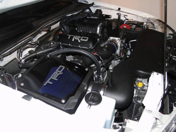

    I needed to have this lid after I saw the same lid on another member's truck. Here is another angle. The camera flash shows the blue filter but the cover is dark smoke and normally can't see through it:

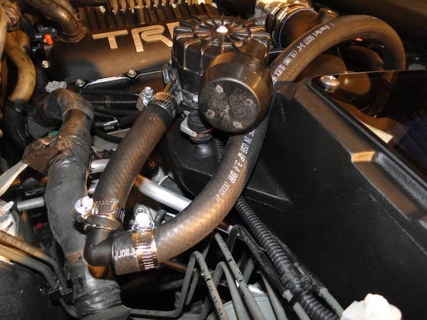

    1) I had to go to AutoZone and get a length of heater hose to replace the factory section. Why? As designed, the original hose, plus elbow plus adapter hose did not work without major kinkage. You can see in the photos the close up of new hose, new elbow and added hose clamps:
