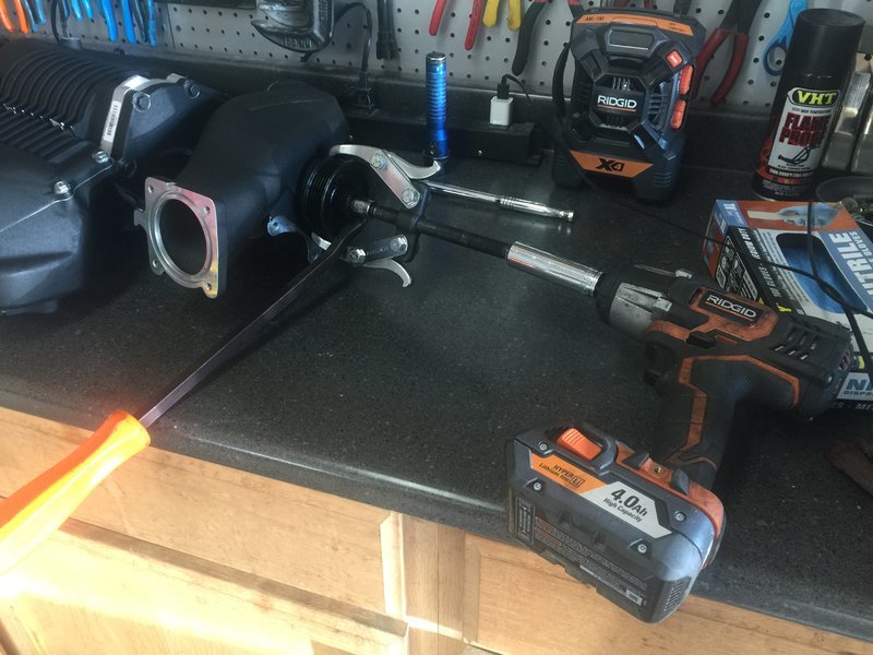

    i was shooting for a turkey day install but i'm inclined to hit it up this weekend. question: what size pulley puller should i rent from LAPS (local auto parts shop)? these are my choices:

    OEM 25914
    http://www.autozone.com/test-scan-and-specialty-tools/parts-puller-installer/oem-jaw-puller/141513/
    https://www.carid.com/oem/2-3-5-ton-jaw-puller-mpn-25914.html
    https://www.amazon.com/dp/B000CMHL6M
    Used a Craftsman 3/8" drive 1/2" socket to press against the shaft. Slightly smaller than the SC shaft. Nearly a perfect fit.
    EDIT: FYI, I did use an impact gun on the puller and a prybar to counter-hold it so the thing wouldn't turn.
