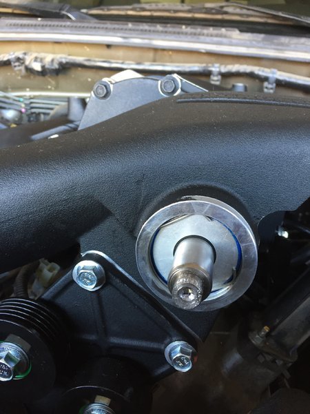

    I really wish I would have had @TIM.TRDSparks install my pulley. This is getting real annoying. The Allen head bolt that came with the install tool is blown out. I got the pulley off but now I'm unable to remove the damn bolt from the shaft. Suggestions? Please no harsh comments. image.jpg

    Vice grip? You were using the install tool kit to remove the old pulley?

    I've tried vice grip. Just don't know what to hold the shaft with out damaging it. The instructions say to insert bolt to hold centering pin from the pulley puller. And that's what I did.

    Ahh I used a hex bolt. If you have a monkey strap wrench try that on the shaft and vise grip on the other side

    You may need to drill the bolt out and clean out the threads with a tap.

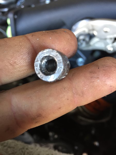

    Got the thing out!!!!! Didn't mess up the threads. But will chase it just incase.
