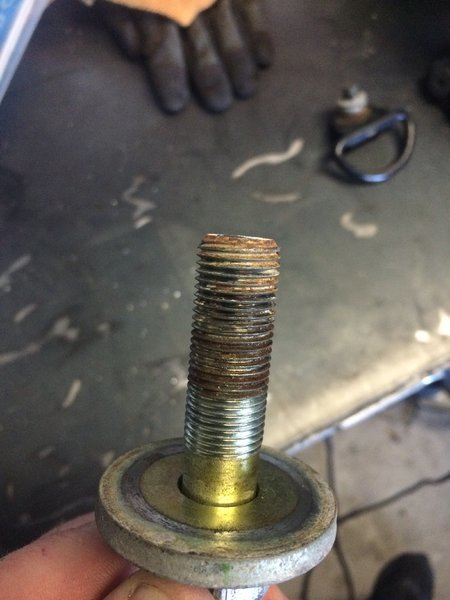

    350 lbs with my impact and 1/2" air hose wouldn't break that bolt loose. I ended up using a breaker bar wedged on the frame and used the starter to break the bolt loose.

    Did you notice any thread locking compound on the bolt when you pulled it? Wondering if they use red locktite on that sucker and that's why it's such a bear to remove.

    ...too much shit to list.
    Just looked like rust/corrosion to me.

    Thanks for the pic :thumbsup: That could be threadlock - hard to tell, but you're probably right that it's just corrosion.
    My truck's pretty new and in a dry climate - I'll use a PB-Blaster/Acetone cocktail and heat the bolt with a torch before I attempt removal just in case.

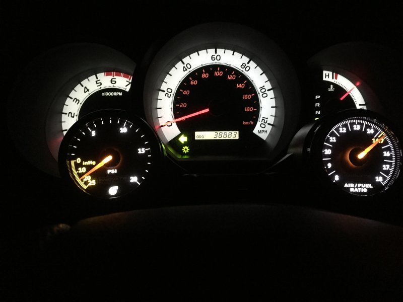

    Got the gauges in and the supercharger.
    Now to order CAI and brakes!!
    :burnrubber:

  19. Nov 17, 2016 at 8:33 PM
    #2159
    lawless
    lawless the rent is too damn high
    Aug 31, 2010
    #42551
    2,606
    Lawson
    San Jose, CA
    2012 dcsb mgm sc
    you are a spending machine
    gauges look great!

  20. Nov 17, 2016 at 8:33 PM
    #2160
    tacomavoyager
    tacomavoyager Well-Known Member
    Apr 25, 2014
    #128480
    500
    I know it's getting out of hand. :eek:
