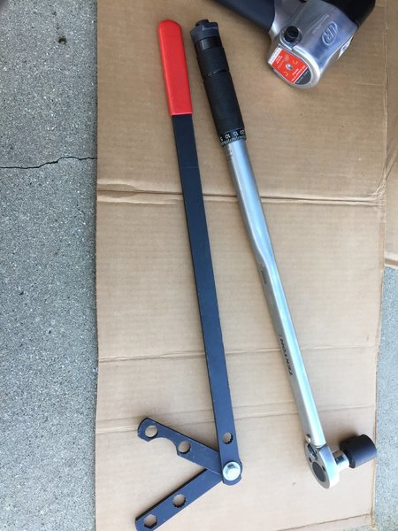

    Well, I've exploded 2 pullers so far trying to remove the 3" pulley.

    It's a pain in the ass!
    I got the gear wrench 2 ton to work but blew the head on the allen head. Had to drill it out. Rented one from the car parts store and that didn't work.
