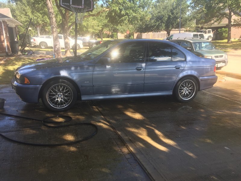

    Thanks, buddy. I'll get it ironed out eventually. I only drive about 20 miles a day and I've got my trusty old E39 to get me wherever I need to go.
