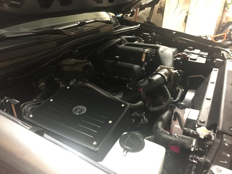

    you got pics of the URD tcai installed?
  11. Nov 25, 2016 at 1:53 PM
    #2351
    tacomavoyager
    tacomavoyager Well-Known Member
    Apr 25, 2014
    #128480
    500
    I'll post some tomorrow. Had to cut about 2in off the top pipe for it to fit right. I just hope no CEL come on.

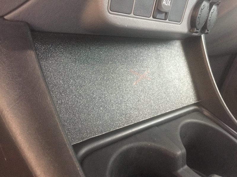

    I still haven't messed with testing fuel pressure under boost. It's a little tough to get at the back of the fuel rail and there's not a ton of room back there for my fuel pressure test adapter anyway. I have a fuel rail tap from URD and a fuel pressure gauge from Speedhut both ordered so I'll just wait until that's all installed.
    In the mean time I'm toying with the gauge placement. I made a plate to fit the pocket opening from a piece of ABS plastic.
    It looks like my original plan of fitting 5 gauges there is going to have to change to only 4 gauges. Even with 4 it's going to be a tight squeeze.

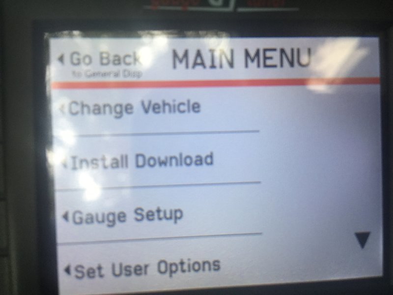

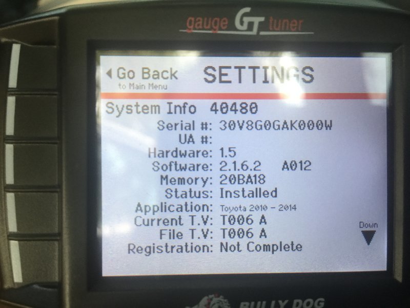

    Of course I'm confused about the BD Tune - some people have posted that they had to choose "TACOMA SC" under vehicle selection. I had no such choice - but the Update Agent listed the files as Magnuson and the SD card came pre-loaded with 6 Tacoma specific choices. I'm wondering if there are a couple different BD tuner models floating out there - I have a 40480, going into a 2015 M/T Tacoma.
    Code:
    System Info 40480
    Hardware 1.5
    Software 2.1.6.2 A013
    Memory 20BA18
    Current TV T006A
    File TV T006A
    There was only one tune for mine to select - Premium 2.85 - so now I'm afraid I did something wrong and of course customer service is out til Monday :annoyed:
    For those that had to choose supercharged - what is the model number on your BD Tune? Or alternatively, how did you get to the vehicle selection screen that indicated supercharged as an option?

    If I remember correctly you have to select s/c option on the BD tuner itself. When I plugged it in to the vehicle I was able to change vehicle under settings.

    Mine is a 2014 auto but here's my settings screen:

    @TaterHarry to select the SC version..
    When you plug in the BD tuner press the top left button "Menu". Then press the top right button "^". Then you will see the selection "Change Vehicle". That's where you can find the Tacoma SC.
