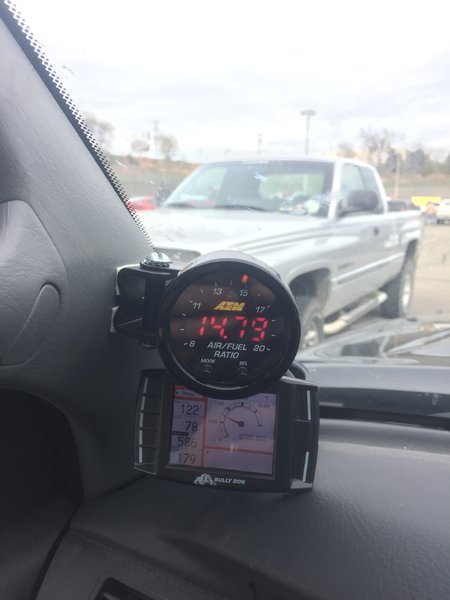

    No. I installed an AFR gauge this morning. I'm at 14.6ish cruising. Its a holiday weekend and I had the wife with me so I didn't get into the throttle much. Still no issues though.

    Here's my temporary setup. Not sure what I'll do later.
