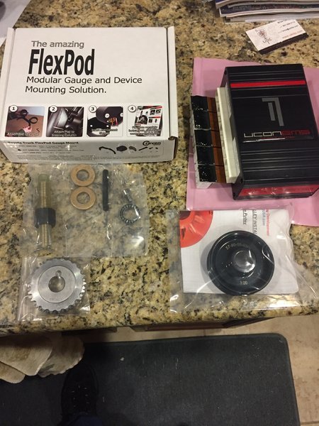

    The remaining supporting mods have arrived.

    What's sensing 0.4 more lean where? Sorry, I don't understand.
    Installing the single sensor at the Y-pipe... past the first set of cats? Not a good place. The resultant dP post catalytic converter isn't good for the sensor and will lead to erroneous readings. The sensor cannot be in an area that is too cold for for the sensor itself for the exact same reason.
    IIRC, for whatever reason the drivers side runs a slight bit leaner than the passenger side, so for those who are running only one WB I'd still suggest installing it on the driver's side for no other reason than the vehicle operator should know the leanest condition the vehicle is in as opposed to a slightly rich condition.
    My personal opinion, spend the extra money and at least eventually install a second WB if for no other reason than for redundancy and data. Most people only run one WB with zero negative effects. Hell, a lot of F/I don't have anything but a cool nifty BEWST gauge. Having two WB (one in each header) might be overkill for most perhaps but in my line of business, this philosophy prevents bad shit from happening. Lol.
    I spy a UCON.
    You cheeky sonuva...

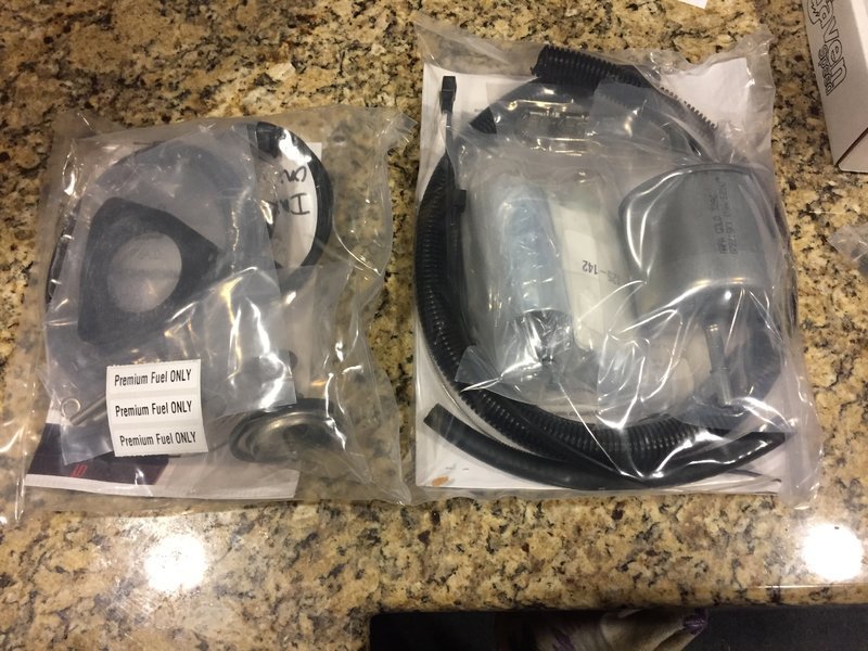

    The goods
    Jealous

    Me too, UCON!!!!!

    I like the text on the UCON: "The Unfair Advantage". I intend to put that to the test.
    Between the supercharger, supporting mods, and more parts for my Subaru STI, I feel like I've gone full retard lately for go fast goodies.
