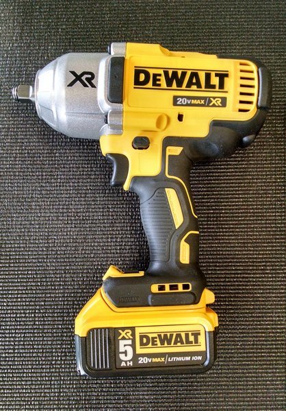

    A new bolt here, a new bolt there, a new bolt everywhere.
    Dewalt DCF899P2

    I like Milwaukee, but since all my work tools are DeWalt, I thought it best to have some continuity.
    Haha. When I first got my impact, I used it to install my suspension so I had an immediate fix. It's a nice feeling fearing no bolt.

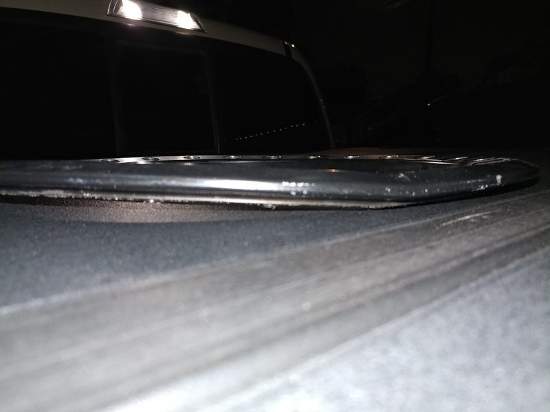

    I could have used it it the other day, when I had to do a pit stop tire change after blowing 7 bolts of my bead lock. lol This is the damage that resulted. Yes, the ring is bent. Thanx to @jt@bajakits.com for getting me replacement. Ordered 6 just incase I need more lol. The damage-20161129_203953.jpg

    Holy crap. I'm glad nothing worse happened.
    I've been toying with the idea of keeping a small impact in the truck for roadside emergencies like that.

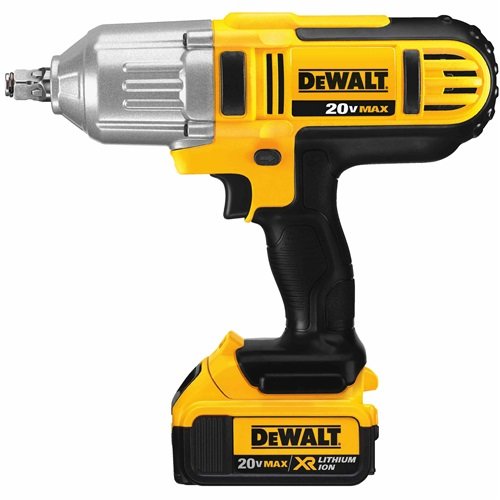

    Yeah the Sears by my place has this one for 159.99. It is very similar to the one I just bought except it doesn't have a speed selecter and it has a hog ring anvil as opposed to the Detent pin mine has. Imageresizer.jpg
