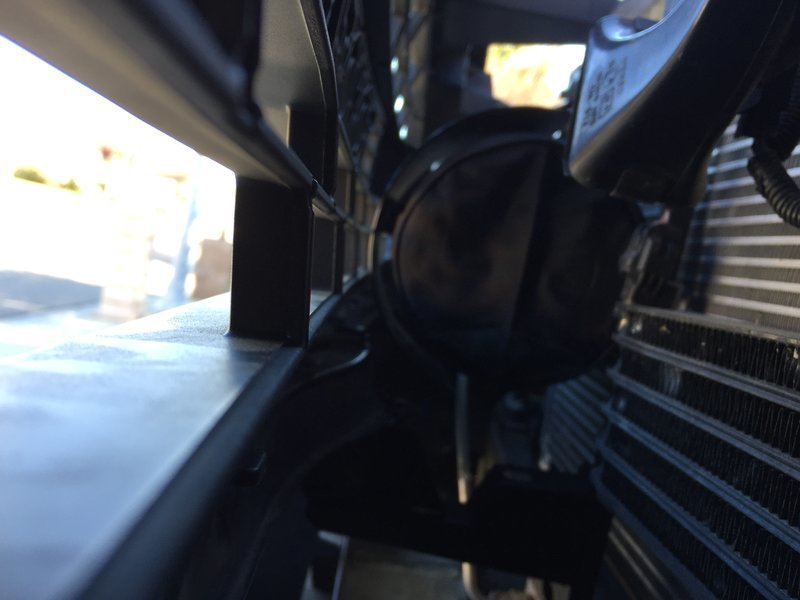

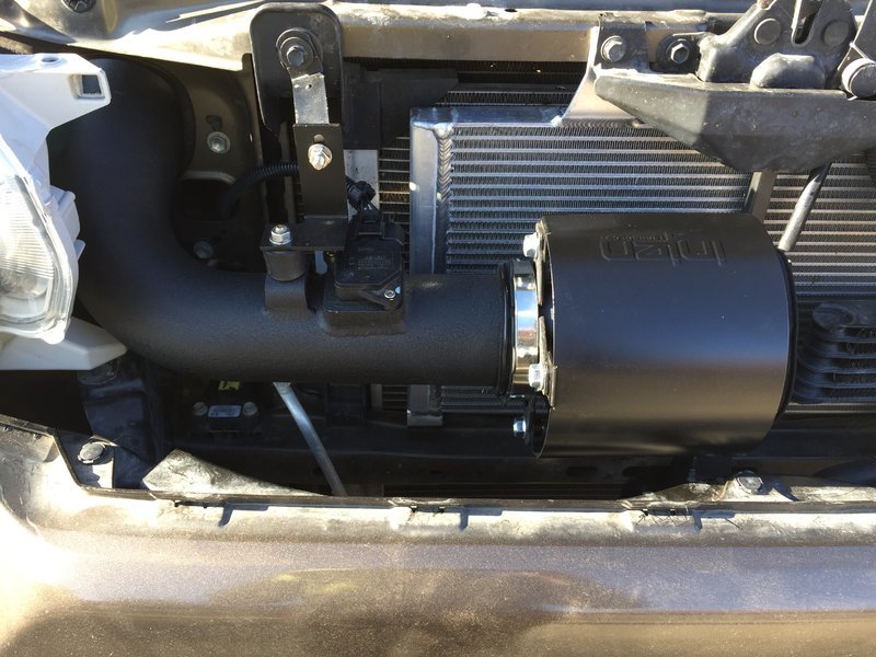

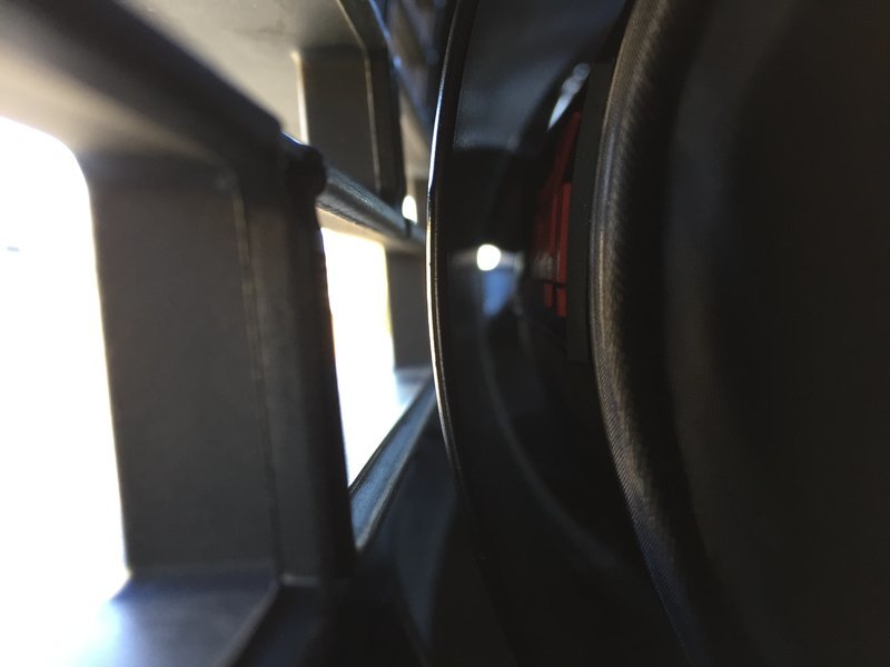

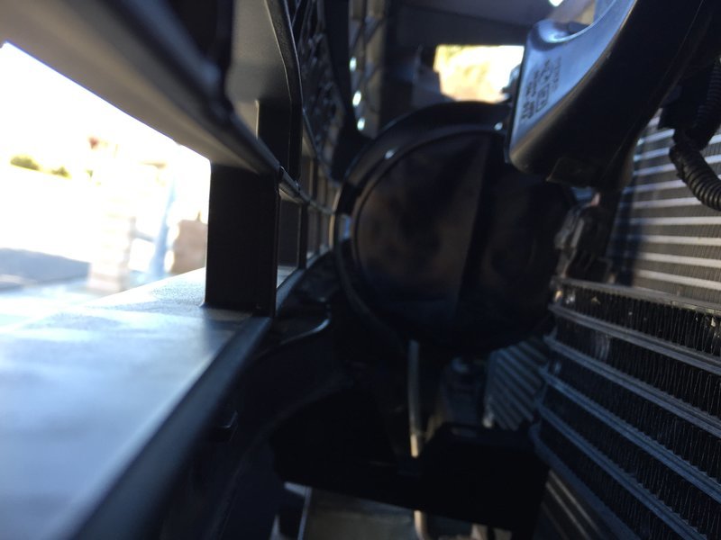

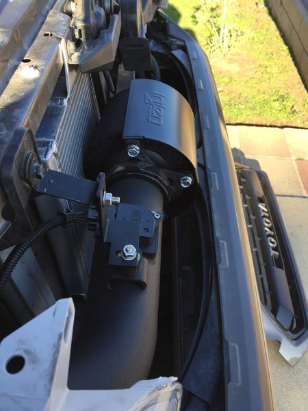

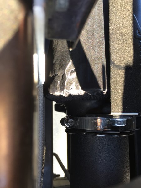

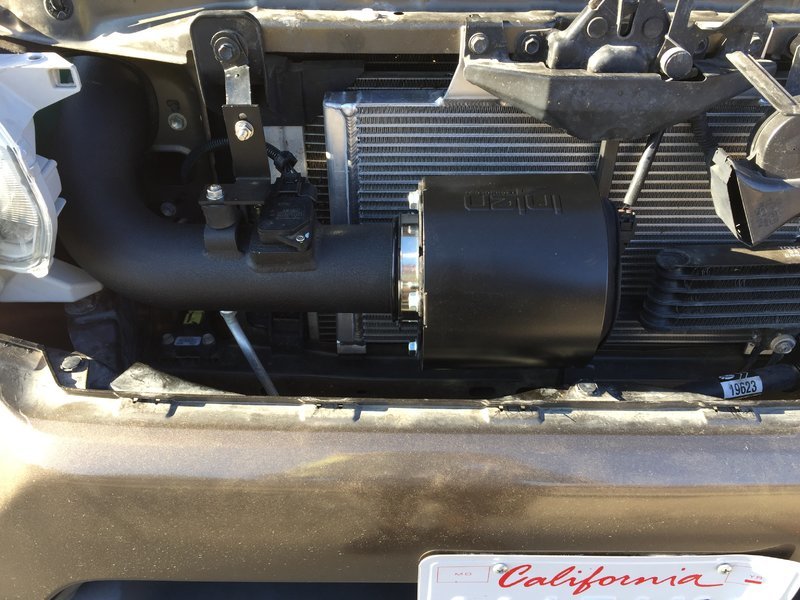

    Here are a few pictures of the URD TCAI. Added a bracket that I had in the junk drawer. It kicked it out just enough to clear the intercooler. Cut about 2 in off the top pipe that connects at the throttle body and cut more sheet metal where the intake comes through the front by the radiator. Pretty pleased with how it looks. Fits with my PRO grill.

    URD CAI front: Fox 2.5 w/ reservoir 700lbs coil Camburg UniBall Rear: 2.5 w/ reservoir

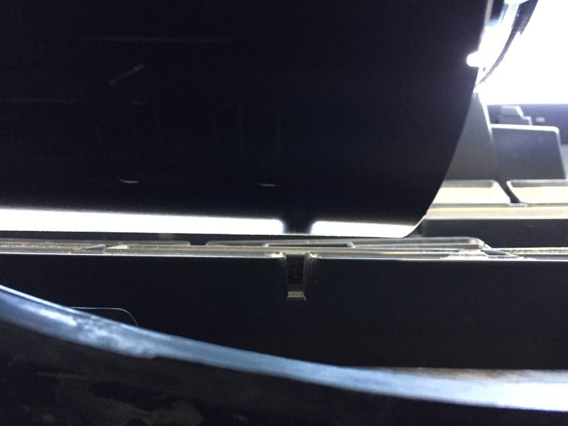

    how's the clearance with the grill?

    Here are a few pictures. Kinda hard to get my phone in between the grill. The last one is a shot from underneath.
