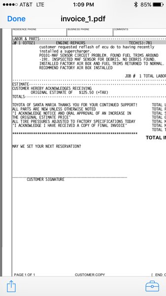

    Harry
    Harry Science, Bitches
    Sep 16, 2014
    #138415
    1,048
    Santa Fe NM
    15 TRD Off Road DCSB
    Still - fuel trims are learned values. Must be one heck of a CAI to lean it out that much. Do you have aftermarket exhaust as well?
    And I have to ask - did you clear the ECU at any point, and if so when (before or after CAI install)?
    You could try running the 2.85 tune which should richen the mixture a bit.

  3. Dec 20, 2016 at 1:28 PM
    #2803
    tacomavoyager
    tacomavoyager Well-Known Member
    Apr 25, 2014
    #128480
    500
    Just running a mbrp cat back. I have the 2.85 pulley and running that tune with performance shifts.

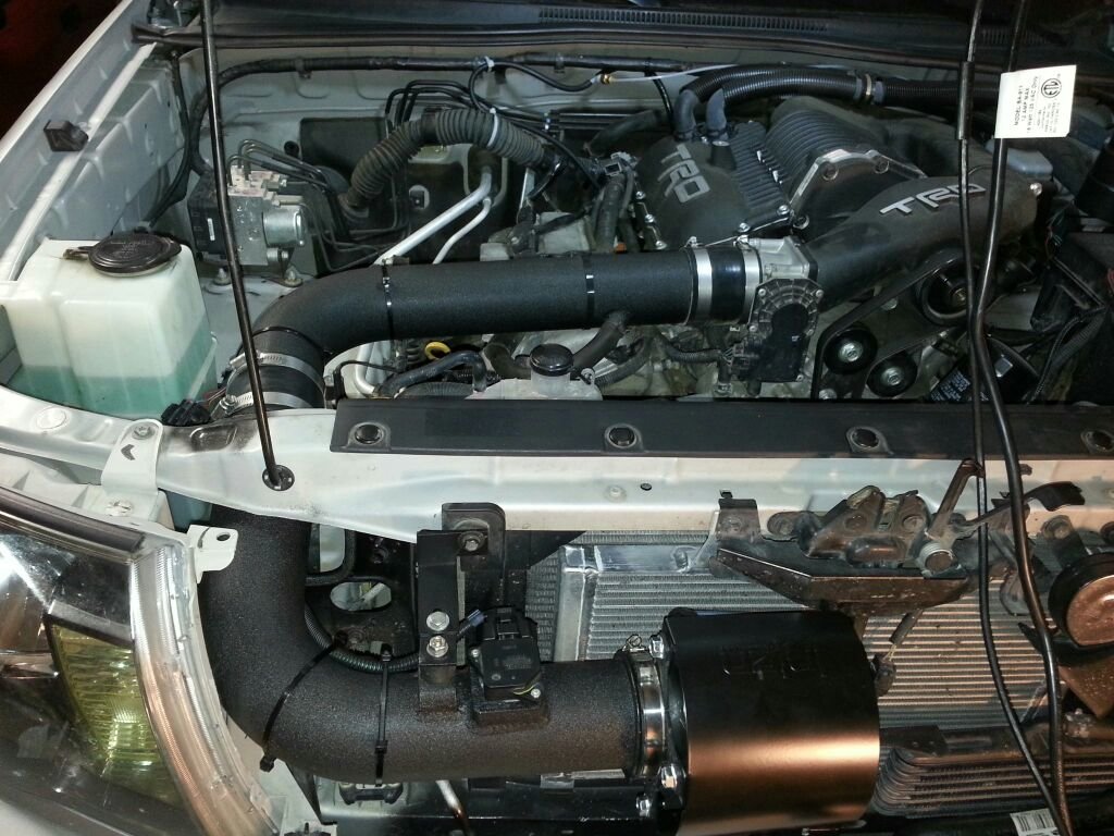

  5. Dec 20, 2016 at 1:29 PM
    #2805
    inwood customs
    inwood customs Roaming potato
    Sep 11, 2016
    #197024
    4,719
    Dave
    2006 v6 potato bugTuRD
    K&n, flowmaster, plastidip, chipped, hids, daves
    Bummer, few on xru with the combo, and i had it for a bit too.
    Then it rained and the maf sensor got wet and the truck fell on its face when merging on the freeway.
    Bought another and the maf seat leaked lol.
    But in dry conditions it ran fine.

    Harry
    Sep 16, 2014
    #138415
    1,048
    Santa Fe NM
    Ah - well these things add up. Pulley + CAI + cat back pushed it over the edge and leaned it out too much. Cutting the intake tube probably didn't help either as most are designed to create some resonance (BMW even calls the intake a "sound system").
    Of course you could continue down the rabbit hole - add a 7th injector and a bigger fuel pump and you'll probably be fine :anonymous:
    tacomavoyager[QUOTED] likes this.

  14. Dec 20, 2016 at 3:04 PM
    #2814
    inwood customs
    Sep 11, 2016
    #197024
    4,719
    Dave
    comical, cuz that aem/k&n "trd" intake is known to make many tacomas run lean

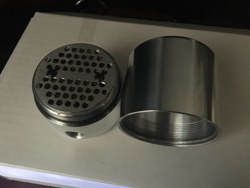

  15. Dec 20, 2016 at 3:09 PM
    #2815
    loginfailed
    loginfailed Well-Known Member
    Aug 29, 2016
    #195923
    5,156
    Dwayne
    Houston, TX
    2014 DCSB 4WD
    Wow, the Moroso catch can is really nice.

  17. Dec 20, 2016 at 3:13 PM
    #2817
    loginfailed
    Aug 29, 2016
    #195923
    5,156
    Dwayne
    Houston, TX
    2014 DCSB 4WD
    This one is only a Benjamin more.
    Get it? I'll be here all week.

  19. Dec 20, 2016 at 3:18 PM
    #2819
    loginfailed
    Aug 29, 2016
    #195923
    5,156
    Dwayne
    Houston, TX
    2014 DCSB 4WD
    It's a pretty heavy piece. The kit has a drain valve so you don't have to take it apart as often. There's a mesh inside the top section so its probably a good idea to disassemble every once in a while to clean it out.

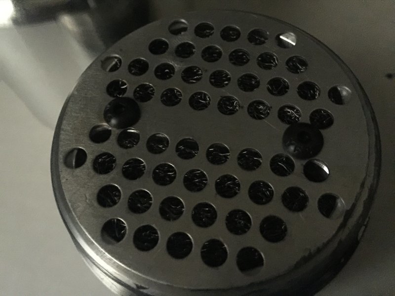

  20. Dec 20, 2016 at 3:25 PM
    #2820
    loginfailed
    Aug 29, 2016
    #195923
    5,156
    Dwayne
    Houston, TX
    2014 DCSB 4WD
    After unscrewing the bottom, there are two hex head screws holding the mesh into the top section.
