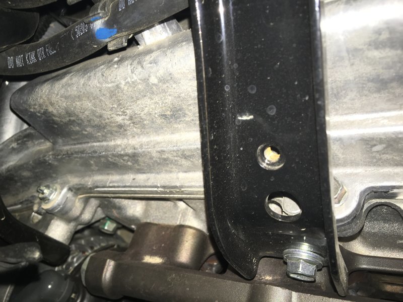

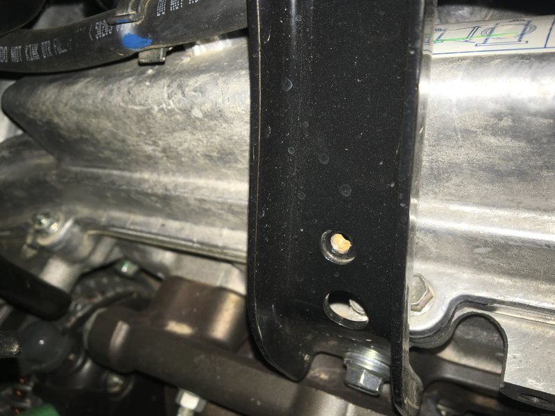

    Need some install help. I'm on step 118, installation of the new rear support bracket of the SC. Problem is I don't know/don't remember which hole to screw the bolt back in. There is 3 options, and I think the middle one is the correct one (because it lines up with my manual transmission hydro line). But the manual seems to show the bracket being installed in the hole that's toward the front of the truck.

    Does this help?
    TacoCat and Camby[QUOTED] like this.

    Ok that's where I thought it goes. Unfortunately my Manual hydro line harness does want to shift that far forward. Ugh....

    Last sentence in 118:
    If the vehicle has a manual transmission, remount the clutch hydraulic line bracket to the new support bracket.
    Not sure if that helps or not.

    Right, the problem is the hydraulic line bracket doesn't want reposition to the new bracket. The new bracket seems to shift to the front of the truck.
