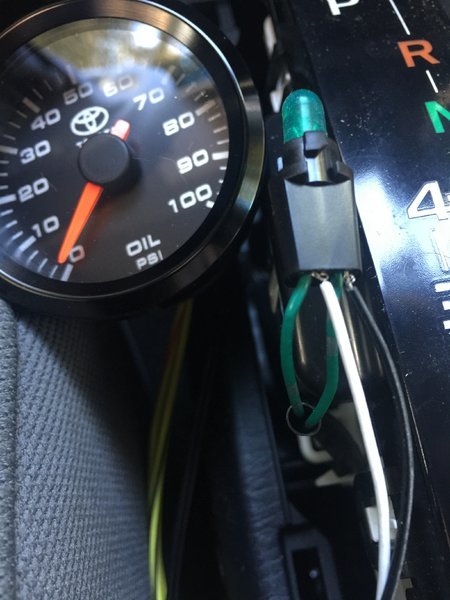

    I didn't have time yesterday to look for the wiring behind the dash because I had some company over. But I did pop off my shifter bezel and try the wires going to the PRNDL bulb and dimming works great. So if you have trouble finding the wires elsewhere you could always run the gauge wires over to the PRNDL bulb.
    https://youtu.be/wuflKWjJ0ng
    Biscuits and tacomavoyager like this.
