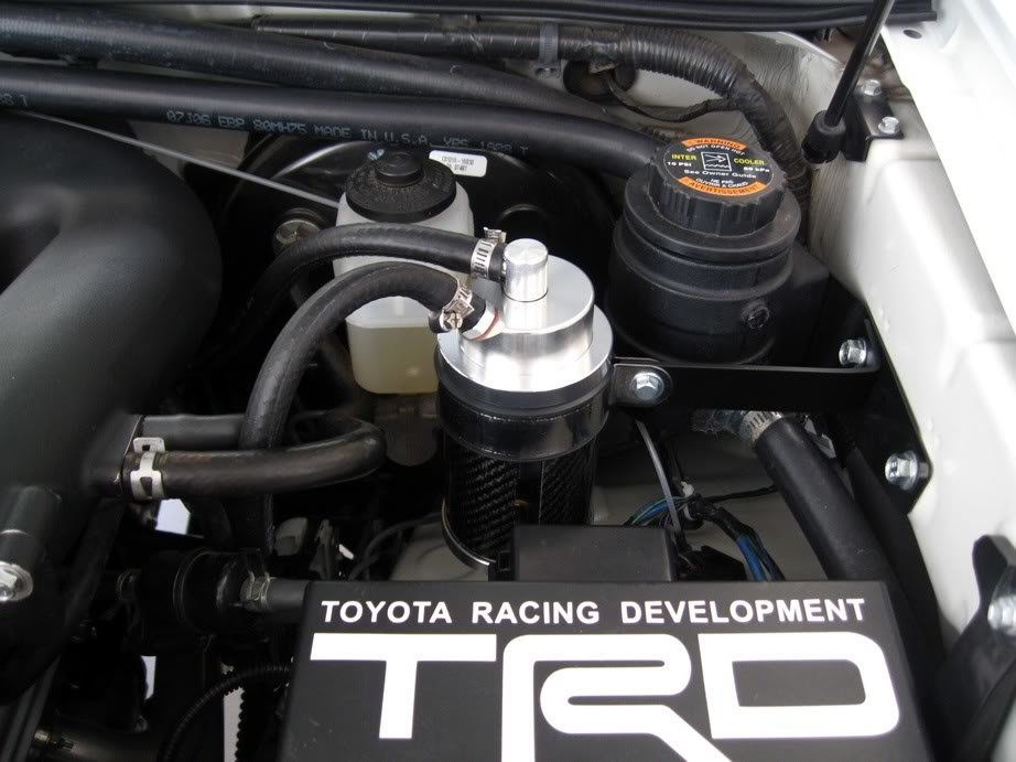

    floor mats and a beer switch
    I really need to add a can to my truck. Thanks @moodywizard for sharing your passenger side setup pics. I've got too much shit on the driver side. Well, there's too much shit on the passenger side too for that matter, but there still seems to be more room there.

    guys, do you compleatly remove PCV valve, or install it after catch can?

    Magnuson S/C w/12TRDTacoma's Qwikchange Hub & 2.5" RIP-Modded Pulley, Roostfactor's Pulley Wrap Mod; FPR Mod; JustDSM Tune via HPT MPVI2; mightytacoman Intercooler Tank; aFe POWER Magnum FLOW Pro DRY S Air Filter; OME Suspension Lift (885 Coils, Dakar Leafs, NitroCharger Sports); TRD Quickshifter w/TRD 6-Spd Knob; TRD Exhaust; NSB-AGM27F Battery w/HKB Adjustable Voltage Booster & Coupe's TRD Battery Hold Down; Goodridge SS Brake Lines; Trident904's MT ADM; BFG All-Terrain T/A KO2s on FJ SE Anthracite Rims; N-Fab 6-Step Nerf Bars; BPF TRD Skid, Tow Hook, & Cooling Panel; jsi's Locker Anytime, Up2NoGood's 2Lo Module; ramonortiz55's Always on Power Outlet Relay, ND4's Fog Light Anytime, & Crom's Speed Bleeder Mods; crashnburn80's Ultimate Headlight & Fog Light Upgrades; ThreatLevelMidnight's Wireless Charger; 4Runner 4X4 & FJ Fog Light Switches; redtaco2007-inspired LED License Plate Lights; AudioControl LC2i LOC, JL Audio XD200/2v2 Amp, Focal PS165V1 Spkrs, Sound Ordnance B-8PTD Sub, Hushmat & Noico Sound Insulation; loginfailed-inspired Speedhut Boost & AFR Gauges in a Lotek Pillar Pod; Ltd Auto-Dim/Compass/Temp/Backup Camera/Homelink mirror on ImMrYo's Mirror Lift Bracket; TacomaBeast Glove Box & Console Organizers; Husky Floor Liners; UltraGauge EM; mesojdm's Ultimate LED Dome & Map Lights & GASSHOLE; Redline Tuning QuickLIFT Elite; Mobtown Offroad Locking Bed Storage Doors; Toyota Bed Mat; Cali Raised Led Bed Stiffeners; Pop & Lock Power Tailgate Lock w/TacomaTruckParts Support Bracket; ARE Z-Series Cap, SolarGard Tint; BlendMounted & MirrorTapped Uniden R3; CravenSpeed Stubby Antenna; Amsoil Lubricants; Adam's Detailing Supplies
    No. Cans are installed in-line with the PCV.
