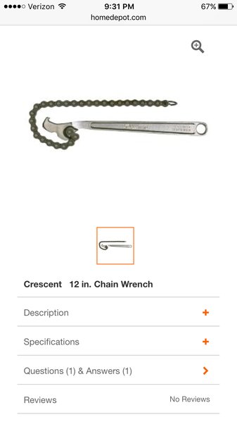

    I actually have one of those already. Lol. You used that on the crank pulley? How? Did you just have a helper hold it for you while you broke and reapplied torque?
    I'm going to be doing this job alone so just trying to find EASY ways to do it that can be done with two hands. Haha

    Just use a breaker bar wedged on the frame and the starter to break it loose. Chain wrench and your old belt to torque it down.

    Man tbh I was going to use the starter then a buddy of mine made me all paranoid by being like "better make sure you put the breaker bar on the right side or you're going to ruin your truck." So at that point I started looking for safer ways to do it and found this thread as a reference.

    That post shows u where he put the pulley holder. Put breaker bar in same spot on the passenger frame rail.

    The engine only turns one direction. By far the easiest method to break that fucker loose.

    I tried this and my breaker bar sheared apart. Maybe it was defective (Kobalt, Lowe's brand), but that fucker broke and scared the shit out of me. I had to pony up for a cordless Dewalt impact to get that SOB loose.

    My impact wouldn't touch it. Put the truck in 4th gear, wedged my 2 foot autozone breaker bar on the frame, cranked it twice and it broke loose.

    This is what I have done in the past. I've put an old towel between the bar and frame and wrapped it over the top of the bar to dampen it from going anywhere or maring the frame. Worked like a charm every time.
