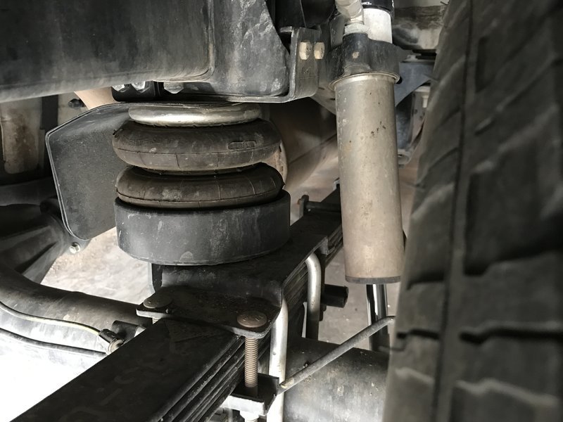

    i travel a lot with tools and trailer with (2 bikes), i want a little spring helper,
    https://pp.userapi.com/c637429/v637429889/3a1df/MvcCqQAuviA.jpg
    [​IMG][/QUOTE]
    That's the set up I have. The only drawback is that is makes it bouncy going over speed bumps (plus takes away some flex if you off-road). I've since upgraded my suspension and got the daystar cradle for these bags. Towing or carrying a bed full of stuff is so much more stable (even on stock suspension). Before the bags I rode with a smallish dirt bike on the bed up to Mohave and thought it was pretty stressful. Every bump and bounce felt like the truck was going to change lanes. Since then, no trouble at all.

    What does it do, instead of connect lower part of air bag to leaf, it mount a plate for air bag for more flexybility? am i right?

    More flex.

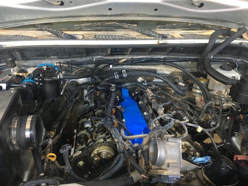

    Ucon installed, damn cam moved when the sprocket was off... talk about a sobering moment haha purrs like a kitten now.

    Well done. :thumbsup: How it feels now, describe the difference.

    Feels like the afr drops more on a linear scale and no flat spots. Afr drops in 10's before any boost. Also now when driving there's more power so I don't go into boost as often. Going to gather some logs and have urd review to make sure everything is running ok. Only thing that surprised me was running rich (10's) before boost but perhaps that is normal for stage 1 tuning. Gadget said it was to protect the cats.
